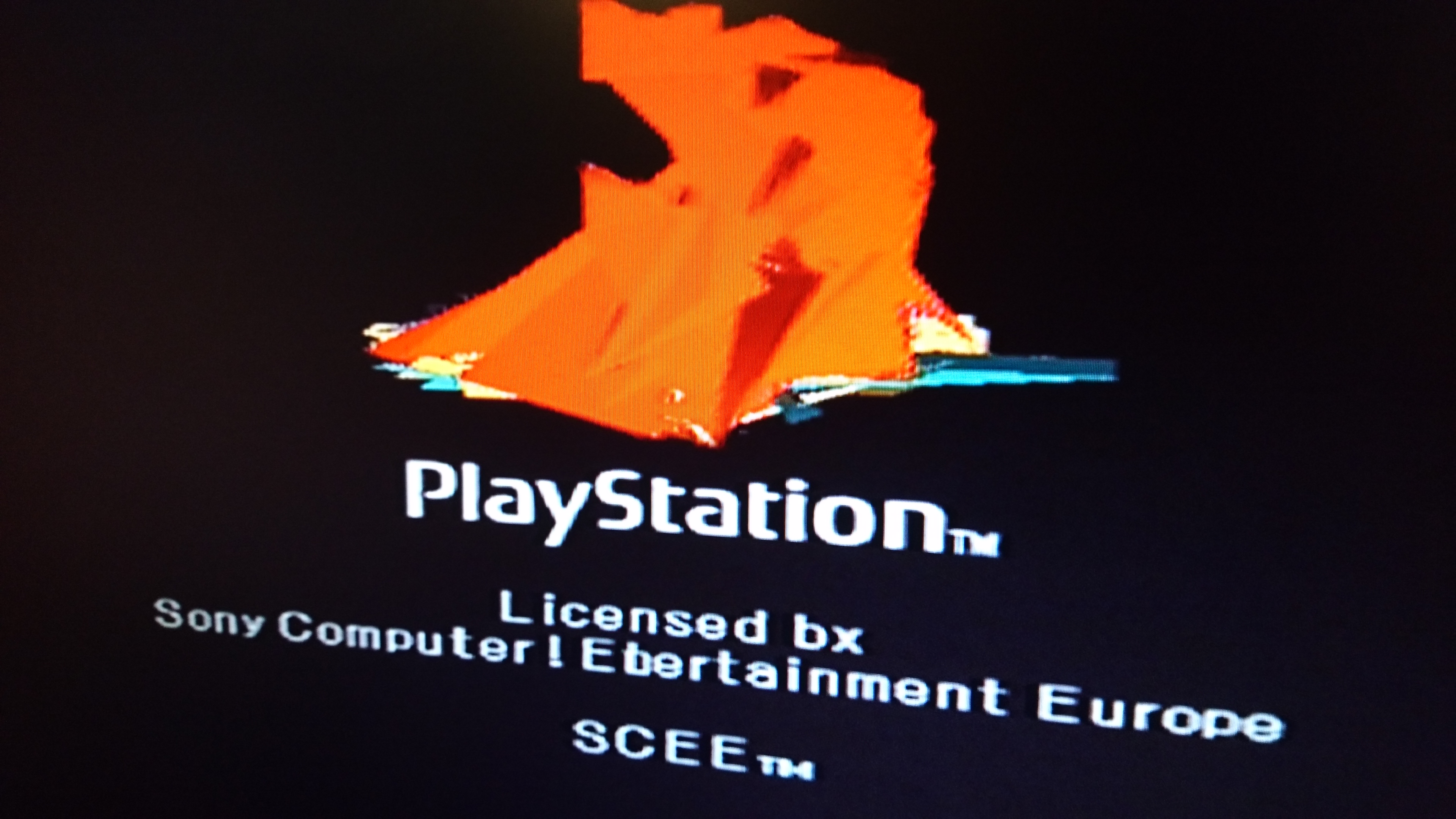

    As per photo. Distorted graphics and spelling mistakes.....

    I cannot provide help, I just wanted to say that is such a beautiful mess.
  3. retro
    Looks like a side view of Orco from He-Man :p
    Quite possibly video RAM or graphics chip fault. Not really worth repairing.

    Does it go away with heat? (Let the console run for a while.)

    Sexy. Is that a SCPH-550x ?

    Nope its a 1002
    And no it doesnt go away with heat

    The graphis is distorted only on boot or even during the gameplay?

    Doesnt boot past that screen. Need to configure laser pots
    The first white and orange sony screen is fine

    So it's definitely a laser problem :p

    I hate adjusting the 3 pots on the 1002. And havnt had much luck

    I remember getting weird boot logos similar to that (not as bad though). It was a disk reading error that caused it. The laser died after a while.

    Any guides to adjusting the pots?
  13. retro
    Yeah... don't do it without the right equipment ;) It's not something you do willy-nilly.

    Here grab a multimeter ... they are cheap and give it a try...
    Feel free to ask or pm if needed

    I did read that guide thats floating around and no luck

    I see that you already have one multimeter so ... theres nothing to loose right?

    Also did you tryed that video tutorial?
  20. retro
    And that's not the right equipment.
