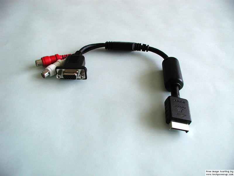

    All PlayStation 2 consoles can do it, unless the OP wants to get VGA output from retail games... which no PlayStation 2 will do natively; either GSM or a physical signal converter is required. GSM requires no additional hardware (other than the cable), but it does not have a perfect compaibility with games.
    If VGA output (either natively or via GSM) is used: the only thing is that you have to come up with your own cable, unless you have the PS2Linux kit (which seems to provide a cable). A screen that supports SoG is required, otherwise the cable would have to contain some electronics (sync stripper).

    I have the Xploder HD Player package. It converts PS2 games to 480p and higher, even games that do not normally have a 480p mode. It also has a feature to convert the games to VGA but only the RGB Sync on Green mode monitors with included PS2 to VGA/RCA audio adapter cable.
    Best bet is to get a Component to VGA conversion box. Cables alone will not do it unless you had the above kit and specialized monitor.
