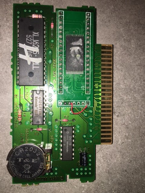

    Hi all,

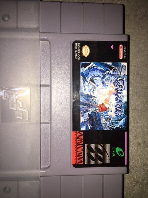

    I bought this copy of Terranigma off eBay. Having never been released in the US, I figured it was just a repro translation, but opening it up, it looks like a legit snes board and chipset, with something aftermarket soldered on top.
    My best guess is that it's a legitimate Japanese Terranigma board that was put in a North American shell with a board attached that somehow has the translation and fonts on it? I don't know. Even the label looks legit, with very light scuffing on it. It looks like just about every other snes cart I own on the outside. I know that repro labels are pretty spot on these days, but what the hell is going on here?

    It's a repro using an official Snes cart as a donor. How much did you pay for it if you don't mind me asking :)
    It's definitely not a Terranigma PAL board, no one would be crazy enough to use that as a donor.
    The CIC you have there is a original NTSC US/JAP, if it was PAL it would start with D13 or something like that and it wouldn't work in a US Snes.
    So, the original Mask ROM was desoldered and replaced with an English ROM on the flash chip

    It is a repro. See that secondary PCB in the first picture? That's a replacement for whatever mask ROM chip the donor board had before.

    Ok thanks. I knew the board was a legitimate Nintendo board but I wasn't sure if the donor was a Japanese Terranigma cart.
