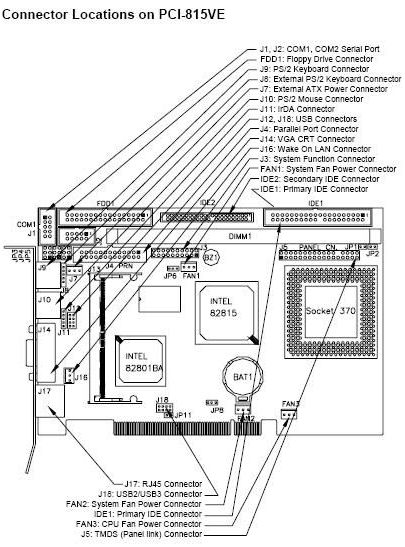

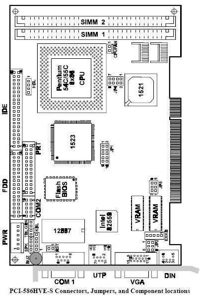

    There are 2 models of T10000 with different SBC (Single Board Computer), one with a Pentium 233MHz and the other with a Celeron 533MHz, you can easily guess wich is wich by looking at the RJ-45 connector position on the back of the Tool :
    [​IMG] [​IMG]

    I can't really understand the two diagrams you posted (I dont have my glasses on and cant read such small print.)

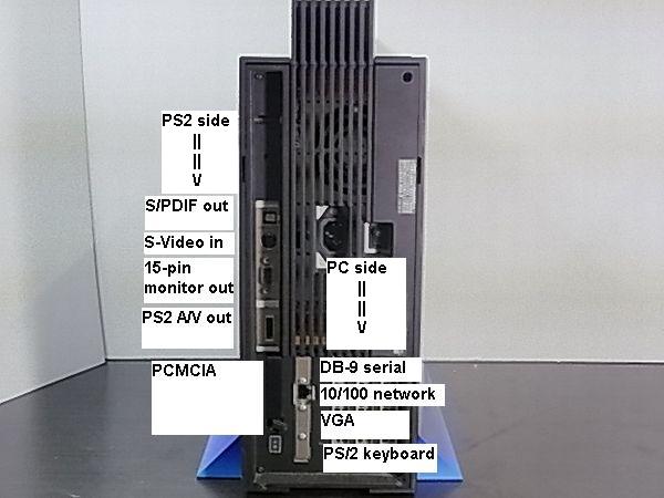

    Here is the back of mine: [​IMG]
    Which model is this? (I know the back looks rusty! :( But the seller is selling it to me for $100 and assures me it works and has provided a video).

  13. unclejun
    Nov 12, 2005
    1,912
    120
  14. Lyth
