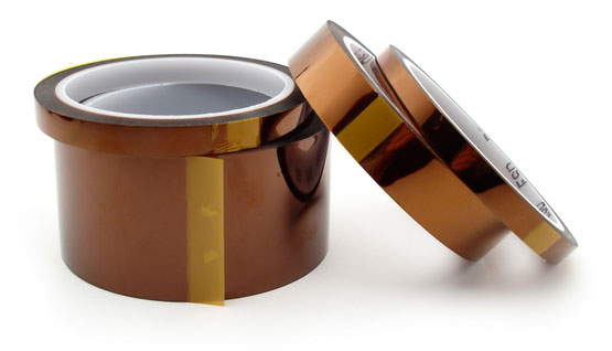

    For tape I use Kapton tape as its anti static, heat resistant and sticks to PCB's and plastic very well.. Also extremely cheap!
    It's usually what you find in most consumer electronics actually.
