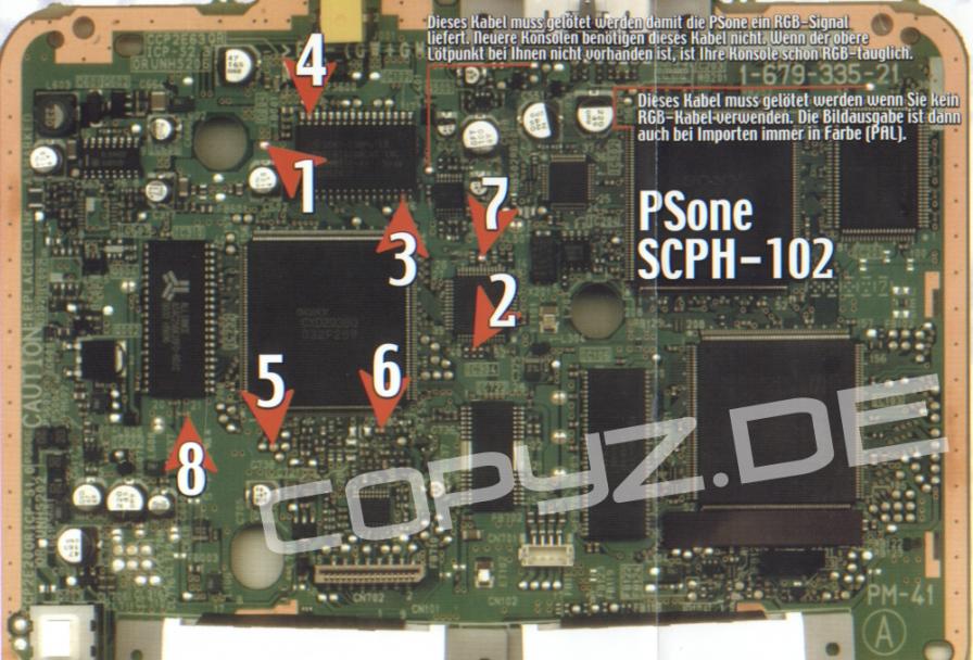

    Just to be clear, it is this diagram correct? (as I have several different ones)
    (this relates for the code 'jinn' uploaded on post #3)
    The two red lines... Do I bridge these? (or is it for RGB PAL signal or something)...

  10. jinn
    jinn Peppy Member
    Feb 8, 2011
    396
    Colour Mod not needed if using Scart RGB Cable
    It doesn't hurt to do it on, only one cable
