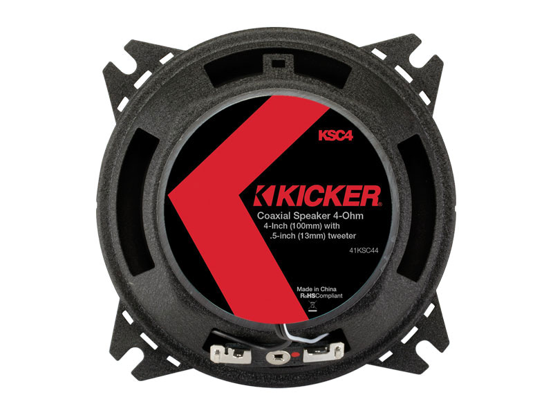

What size Quick Disconnects do i need for these speakers ?

    You're looking for a female spade crimp connector. Most people just buy a little assorted kit of these kind of connectors so they have whatever size is needed.
    Think something like this: https://www.amazon.com/Ginsco-Assor..._2?s=industrial&ie=UTF8&qid=1477423877&sr=1-2
    You'll use the red or the blue one depending on what gauge wire you're crimping.
    Personally, I hate crimping anything and would just solder to the lugs. Because seriously...how often are you going to swap speakers?

    thanks Tri for the info and knowledge , i have sourced some Blue Crimp Connectors in my country so thats another thing i can cross off my list for this Vewlix Clone.
    thanks again
