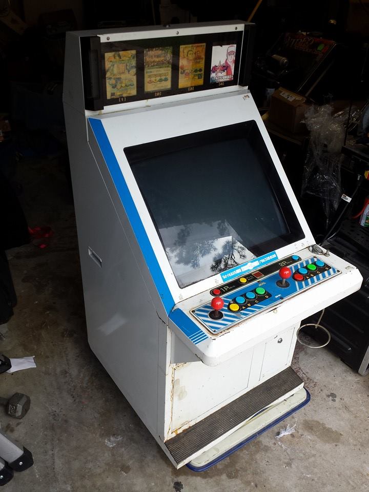

    FireAza Shake! Shake!
    May 31, 2012
    2,003
    25

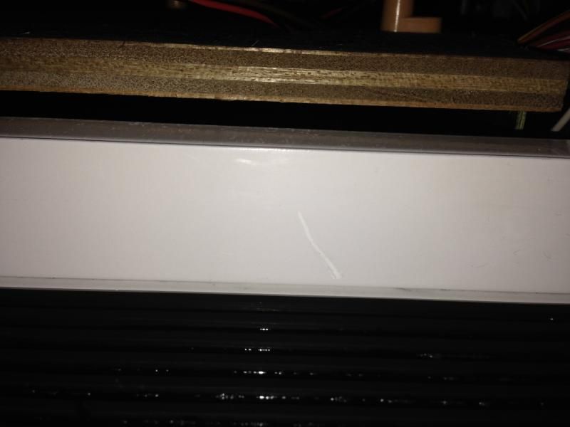

    While true, I don't have any room next to the cabinet :p for the scratches, I'm gonna have this body scratch remover I found a try, see if I can get some nice results with it or not. Would hopefully solve the "can't get the exact same color touch up paint" thing.

  8. FireAza
    May 31, 2012
    2,003
    25
    Nope, the fridge magnets disagree with you :p
    Well, the scratch fixer did bupkis, so I got some proper touch up paint. I think I've managed to get some pretty damned good results!
    Can you see where the scratch was? Here let me zoom in a bit:
    As you can see, it was a pretty deep, wide scratch, so to get it looking like this seems like a result to me! The color isn't QUITE identical, but it's very close.

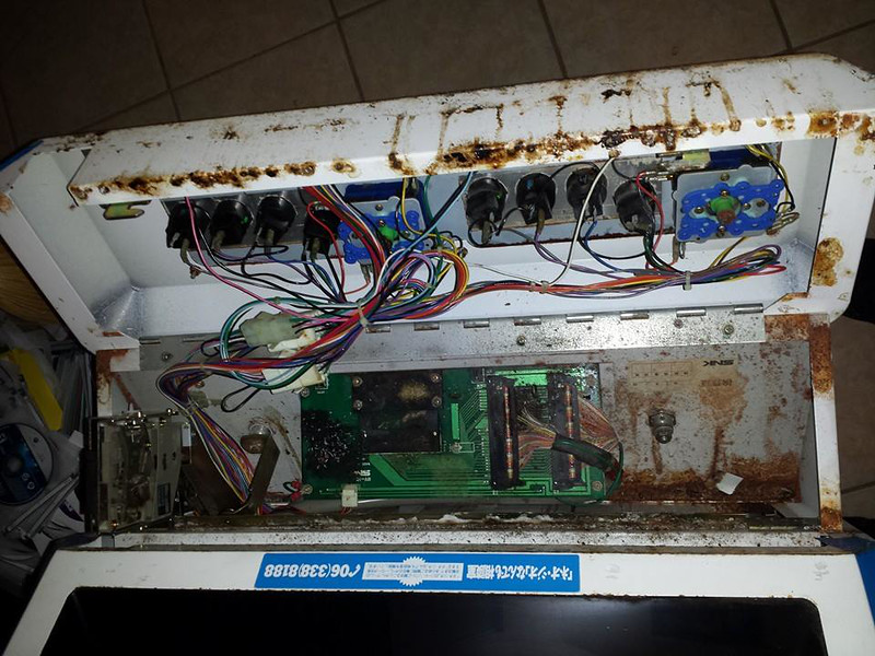

    I just picked up an MVS-U4 this past week from a guy in PA and I had it shipped to TX. The original owner bought it at a Japanese furniture store while he was stationed in Japan and had it flown to PA when he got out.

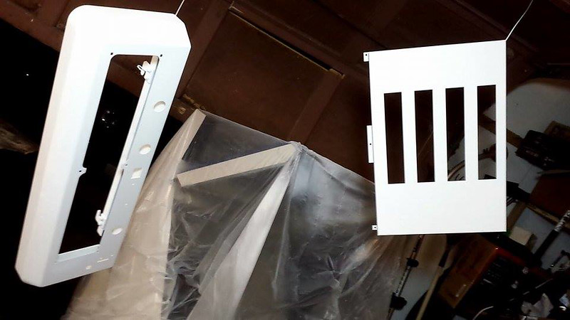

    Once it got here I opened it up and found that someone spilled something (soda?) in it so the control panel was rusted on the inside. I used Metal Rescue to clean up the bottom and the top CP is primer'd and will be ready to paint in a few hours. I originally planned on having it stripped and powder-coated but I read that these candy cabs can warp if the heat is too much so didn't take the chance. I am going with white automotive paint because when I went to home depot and I took the door with me we realized it was just aged white oil based appliance paint. The guy gave me a paint chart to use to match it so I figure automotive would be better than the standard white as far as UV durability.

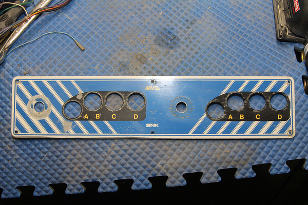

    Does anybody know where I can find a scan of the CP Art? I found replacement stickers online but I haven't seen anyone with a copy of MVS-U4 CP.
    Here is a link to the pics I have taken during the process. I also posted them on the Arcade Collectors Worldwide FB group.

  16. Deneteus
    Deneteus Newly Registered
    Jan 29, 2014
    Awesome. Thanks for the update. I found another file with the MVS-4-25 art in it as well! I'm going to print it out and see how well it fits! FYI that Rustoleum Automotive Enamel looks awesome.
    I'll post some pics up when I am done layering the paint.
