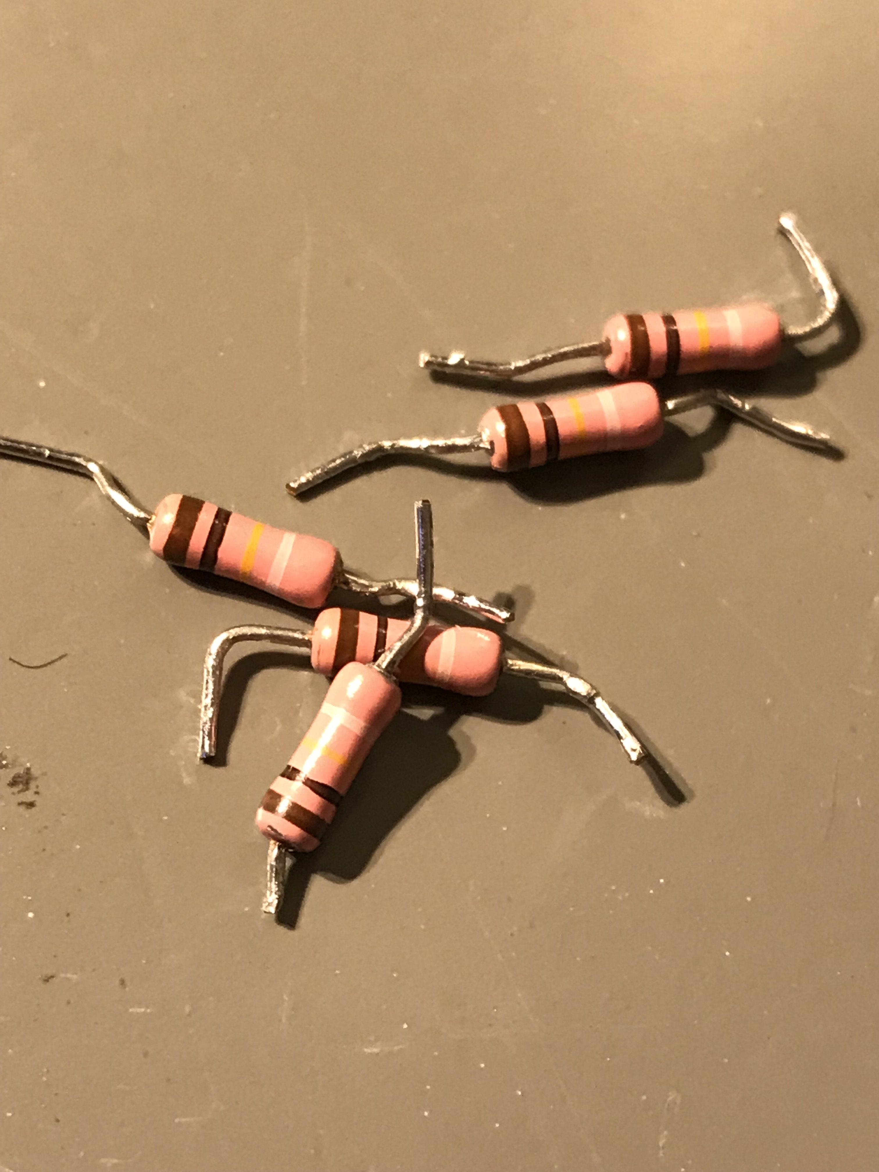

    I know its simple with a multimeter or the colour code, but all the Resistors are gone. I cant check with the multimeter. I was thinking the brown is the first ring? Than the last one musst be silver, but looks like white for me...
    So it can be
    brown - black - yellow - silver = 100k Ohms 10%
    brown - black - yellow - grey = 100k Ohms 0.05%
    Or is it:
    white - yellow - black - brown = 94 Ohms 1%
    What would you say?

    That looks like 100k ± 10% to me. The first band is on the wider part normally, I've never seen white band for tolerance, but that might be the case here.

    ok thanks, yeah after 20 years silver can look like white maybe ^^

    If it's very sensitive equipment, you could use 0.05% resistors as they will certainly work in place of 10% ones without any issue.
    Or ask someone with access to the same equipment to measure it for you with a ohmmeter.

    Looks to be white which is weird but looking at it id say grey not silver as its closer to white
    So id say brown black yellow grey

    If it ain't white its def grey not silver i zoomed in and everything n it looks white
