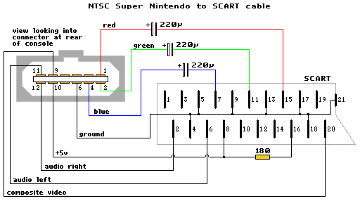

    Got it yesterday and I plug it in to my scart to hdmi converter and I get barely any video,very dark with no color but sound does work,plus the converter says its outputting AV instead of scart rgb,its not switching over.
    I opened the cable up and its wired just like this.
    I'm thinking the composite video is not wired correctly,seems like its wired to composite sync instead.

    Yes you bought the composite sync cable. It should work unless you have a mini that is not rgb modded or is modded and csync wasn't connected to the multi out.

    Tried on on my super fami and snes,sound but barely and any video and on my pal snes its nothing but a black screen.

    Pal snes needs different components in the cable I think so that ones not going to work. Perhaps there is a setting on the hdmi adaptor that needs changed. That cable should work.
    maybe pal mode (50hz) button got pushed in by mistake?

    Also when messing around with the cable I removed the 5v wire and nothing changed,acted exactly the same.
    On the converter it detects the video source,I cannot change it.

    So do you have a different one than you linked in the origninal post? Maybe the convertor you have doesn't work with rgb and only composite.
    You also maybe blew something in the convertor if you plugged the jap21 cable into it. Your cable is most likely fine and the convertor is the problem.

    Well its not mine,my buddy bought it had no idea what he was doing.
    I looked more into it,this is the one he bought.
    http://www.goodluckbuy.com/scart-hdmi-to-hdmi-converter-upscaler-hdv-8s.html
    I downloaded the manual and here is what it says that spikes my interest.
    SCART (CVBS)/HDMI---------------------SCART or HDMI input switching button
    CVBS is just a fancy term for composite video.

    Make sure it's set to 60hz output. If it is, then it probably died when the jap21 cable was plugged into it.

    That very well could have been it.Thanks for the help dude.
