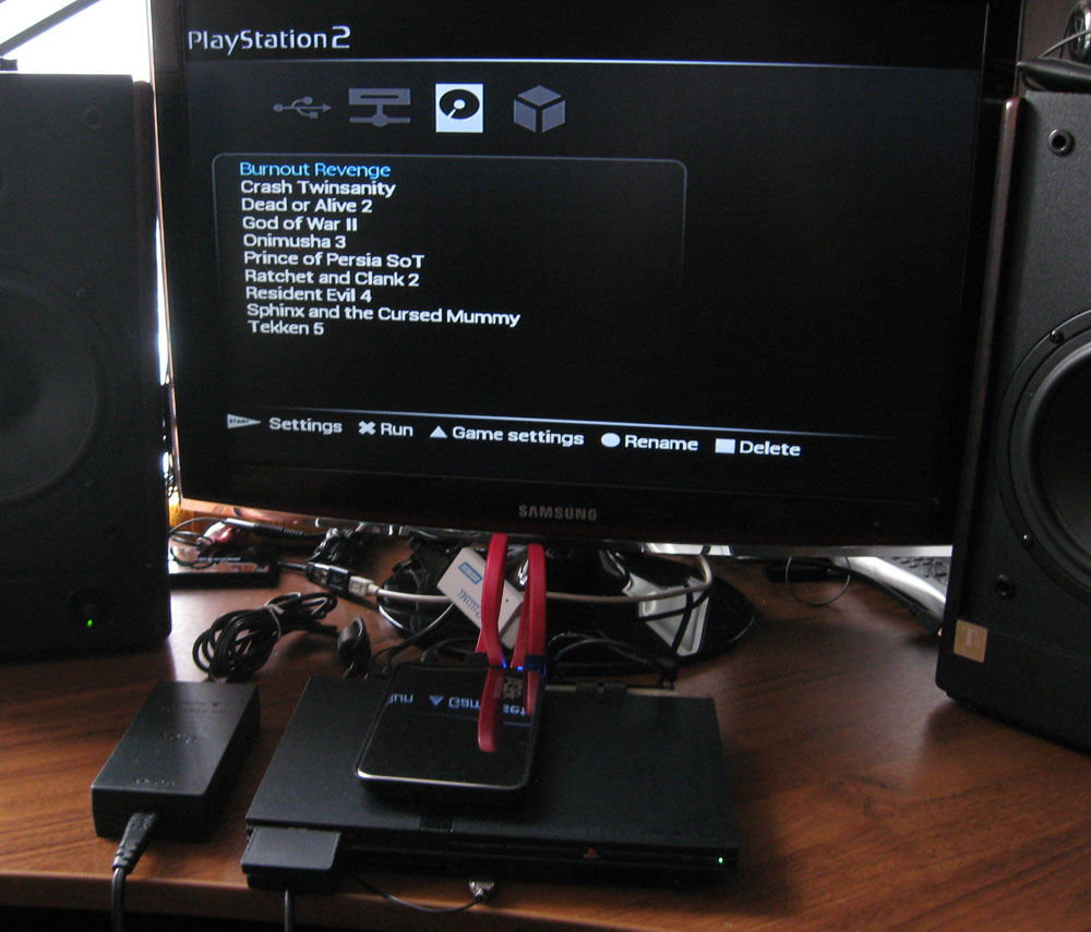

    http://www.assemblergames.com/forums/showthread.php?48051-PS2-Slim-with-SATA-SD-Adapter
    and http://psx-scene.com/forums/attachm...-2-possible-lets-find-out-ps2slimoxybelis.jpg
    PS2 Slim allegedly can not use PS2 HDD OSD. I have not tested.

    Open PS2 Loader supports that garbage too. But I would really stay away of it. Too slow for a LOT of games. Borderline faster than USB.
    I think Ethernet on Open PS2 Loader would compare to this loading method really.
    You're a lot better procuring an earlier PS2 and using a harddrive.
