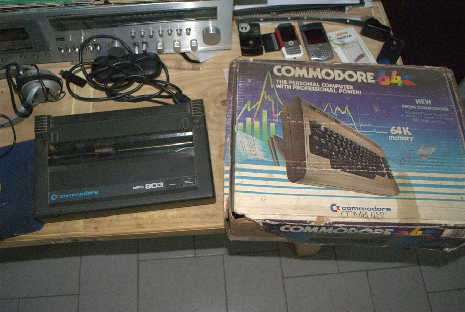

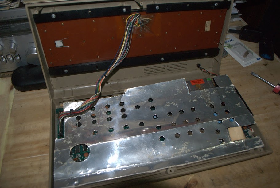

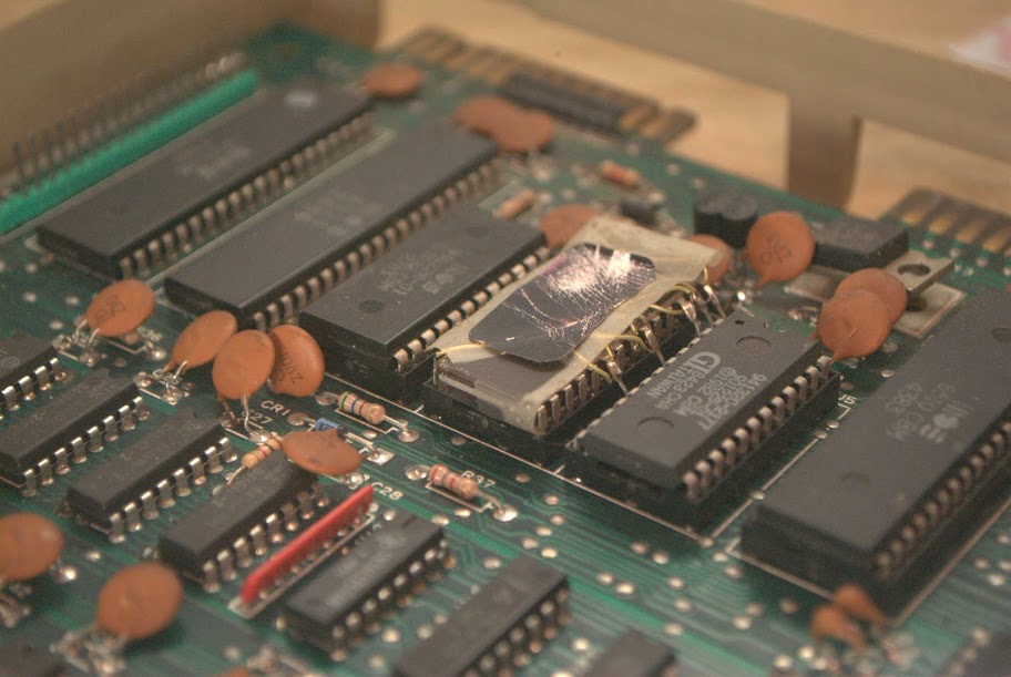

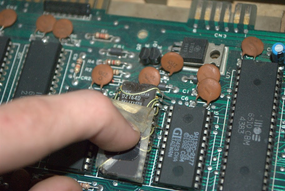

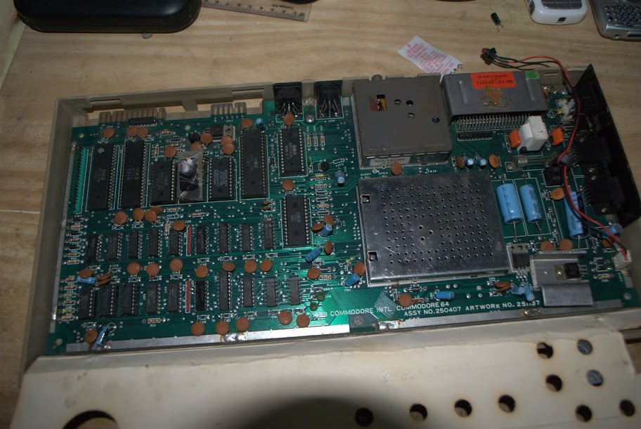

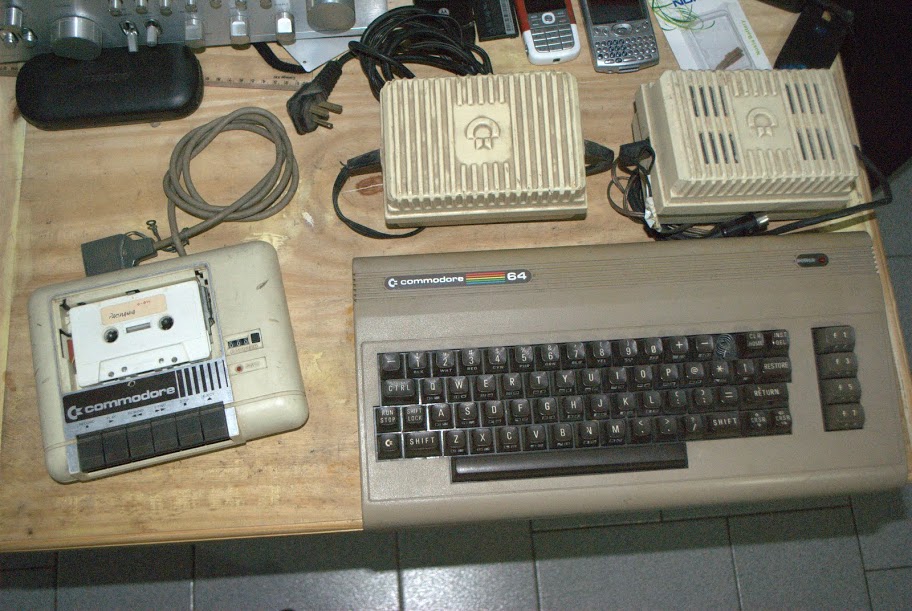

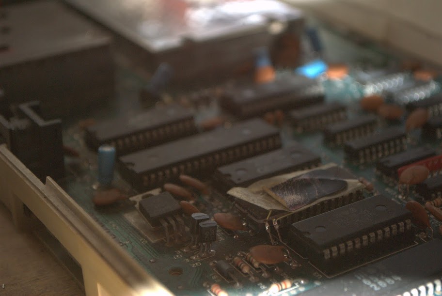

    some days ago i've got a boxed C64, the Drean version, only sold in argentina, also have the C128 of this version, it came with the datasette and the printer, pacmania and poleposition on a forgotten tape on the datasette, i didn't expect it to work since it was stored like 15 years, so i hooked up and fired it, light blue screen comes up with correct borders but full of garbled text and didn't responding to keyboard, tipical rom error, so i opened the machine to reseat the ICs when i found out some wires running on top the rom chip and 2 legs from each side getting out of the socket, maybe the rom was replaced and had to put a similar chip with diffrent pinout maybe? after reseating the IC the machine worked flawlessly, even loaded the games on the tape, the pacmania was a cracked version with unlimited lifes as an option, anyway, here are some pics.

    The 2364 Mask ROM has less pins and a slightly different pinout to the 2764 EPROM, so to make it fit you need to make a adapter or do the funky lift pin legs up and solder them to the board routine. I doubt if the ROM is any different in terms of code.
    http://ist.uwaterloo.ca/~schepers/roms.html
    A webpage showing you how to burn EPROMs for use in various commodore machines.
  4. APE
    Looks like an OTP EPROM that needed a bit of rewiring in order to be compatible. Unless it is some custom/modified BIOS I wouldn't call it weird.
    EDIT: Looks like Jamtex beat me to it.

    yes, is the same rom, or at least what i can test, it's wierd to me that someone had rewired it instead of buying the replacement rom since in argentina was an oficial reseller and service of comodore, and how the hell did someone manages to destroy the mask rom without destroying everything else? maybe is a custom rom, dunno how to note if diffrent.

    That looks like it's the KERNAL ROM. Grab a tool (or write one in BASIC, if you need me to I can do so) and dump $E000-$FFFF to a file, and it can be compared to stock KERNAL ROM images.
