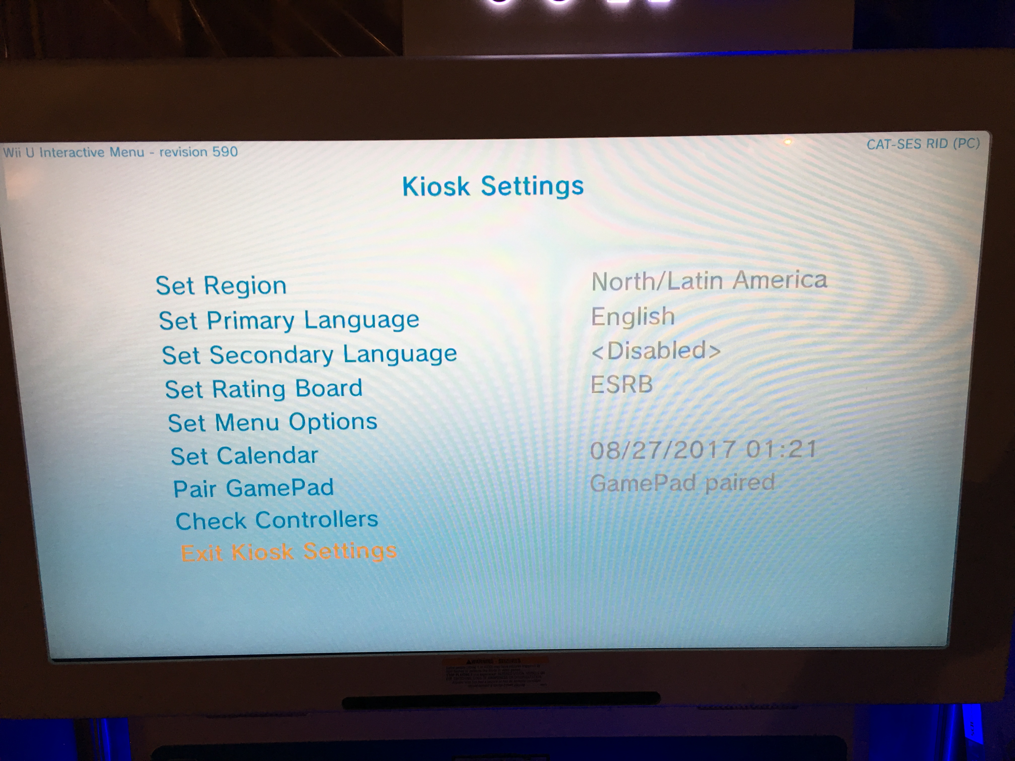

    The weird part of it all is my demo unit does not have an update feature within the menu like Ive seen on other demo units. Where most units in the menu have a Cat-something label, mine was Cat-Ses(PC). Im assuming the unit must be updated through the pc maybe. Also, several demos like smash bros, mario party 10 and kirby give the error about usb storage, so perhaps the pc was meant to stay with this demo unit to act as extra storage as there is a usb cable running from the demo unit to the pc, it was detached when I got this. If the guy I gave the drive to cant figure it out I doubt it ever can. This buddy works for the government now after working for the police cracking criminal hard drives which I would assume would have a higher encryption than this drive. He wont touch the drive other than copying it and trying to mess with the image, so if anyone really needs the image file for some reason Im sure I can get a hold of it off him and upload it through torrents. Like Conker stated above its unlikely the usb key will ever surface, Im guessing this pc getting out might have also gotten someone in trouble. It would just be interesting to see how the puzzle fits together as I havent seen anyone else show pics of this pc in their kiosk.

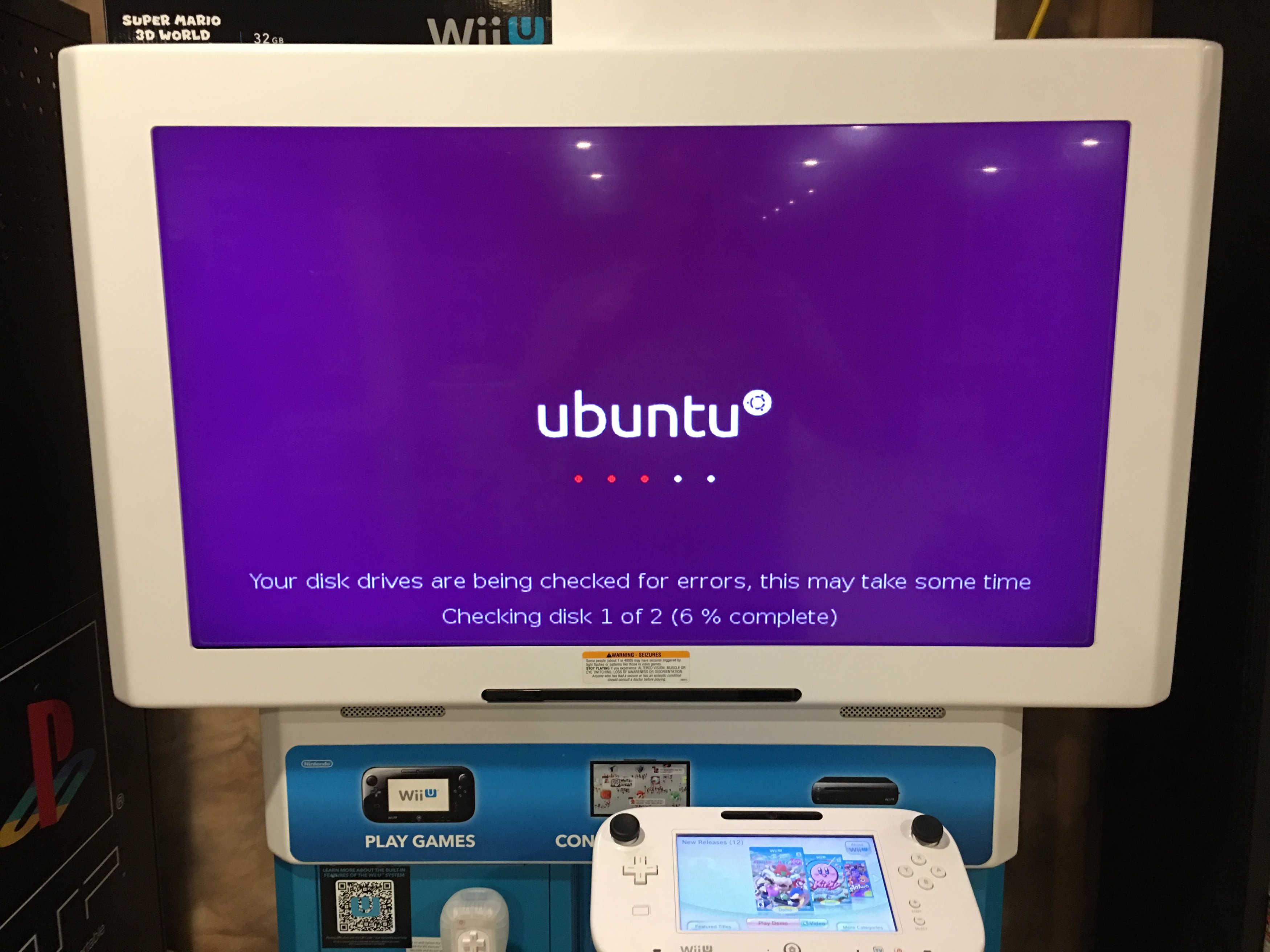

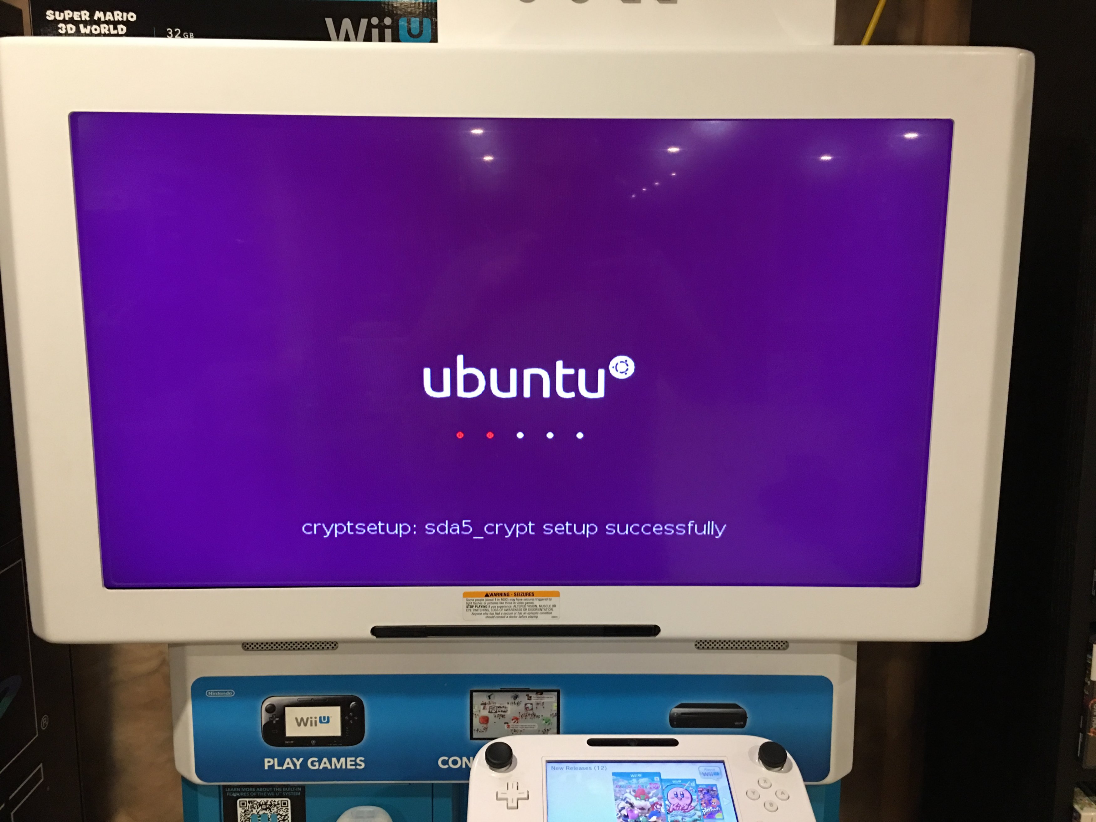

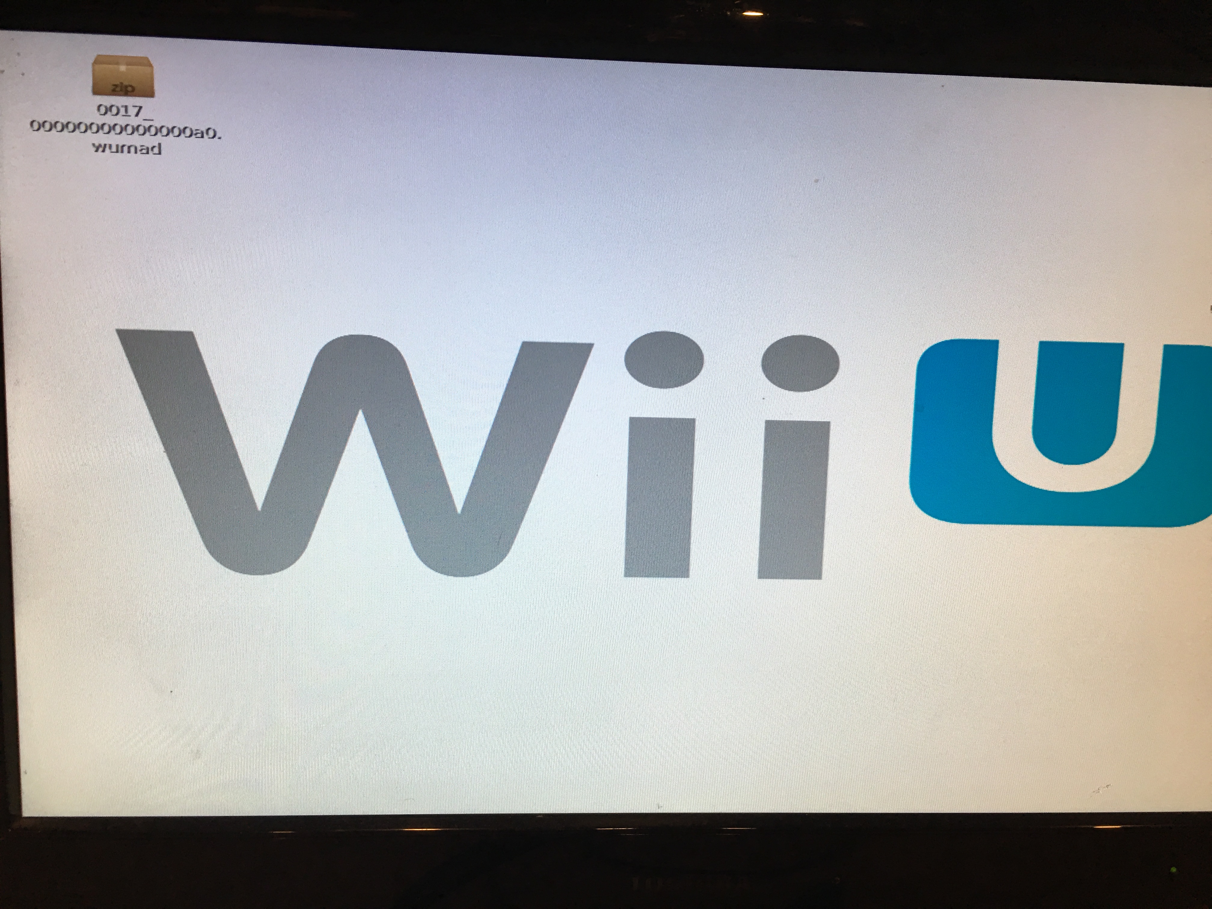

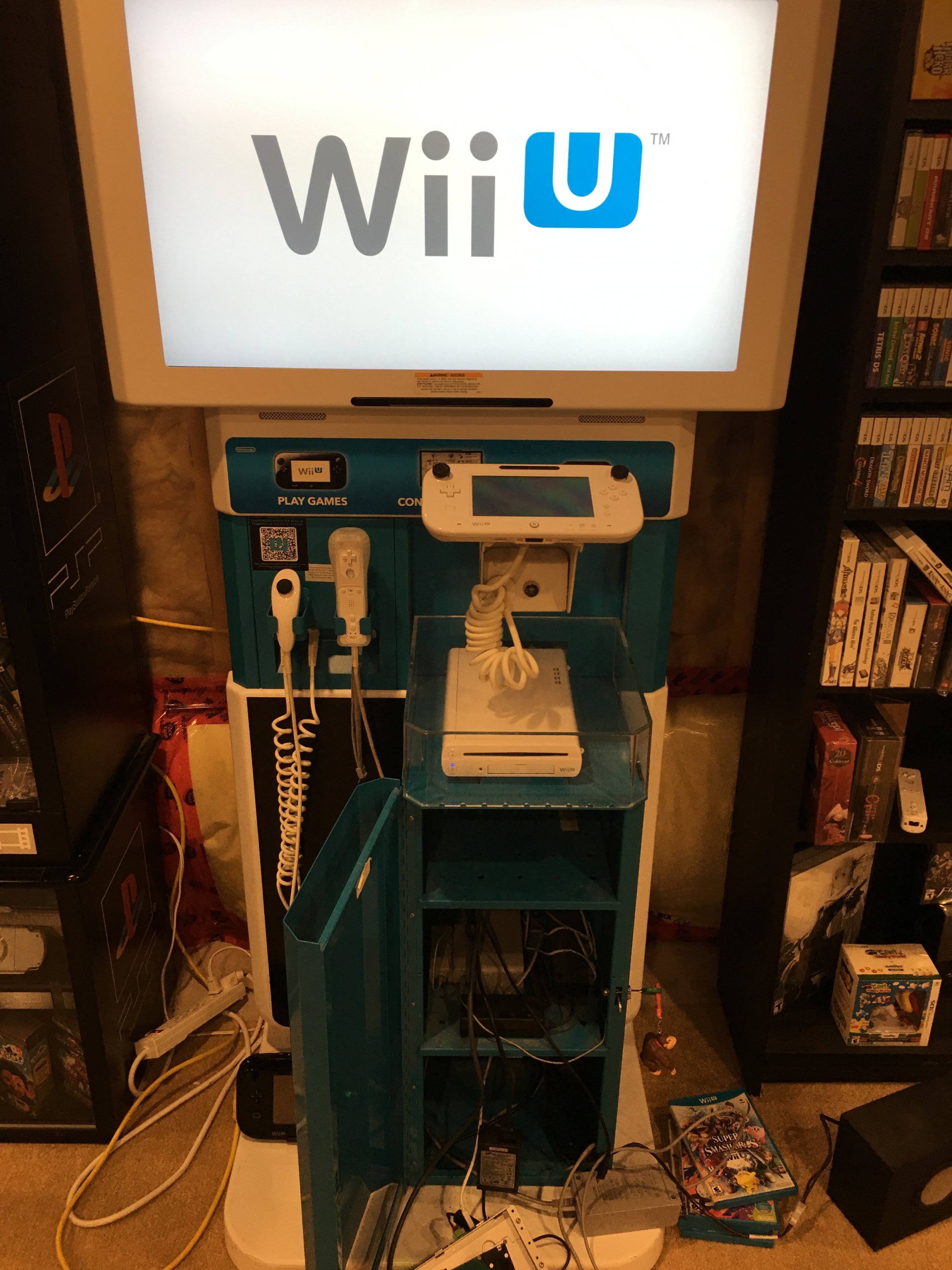

    Tried working on this again after a long break, posted on gbatemp and discord to try and get further advice as I really want to try and figure out what the box is for and will it fix some dead demos on my console. Setup the silver box a bit differently, it appears that when connected to my Wii U demo console by usb cord and the ethernet is plugged in, it logs into the silver box and the silver box lands on this Wii U splash screen. Anyone have any ideas on how to view what is on the hard drive from this point? I haven't tried hooking up a usb keyboard or opening the Wii U console to see if it is different than others I've seen in videos. Ignore the mess with the kiosk, I took everything out.

  10. pstrick1
    pstrick1 Site Supporter
    Aug 6, 2007
    679
    144

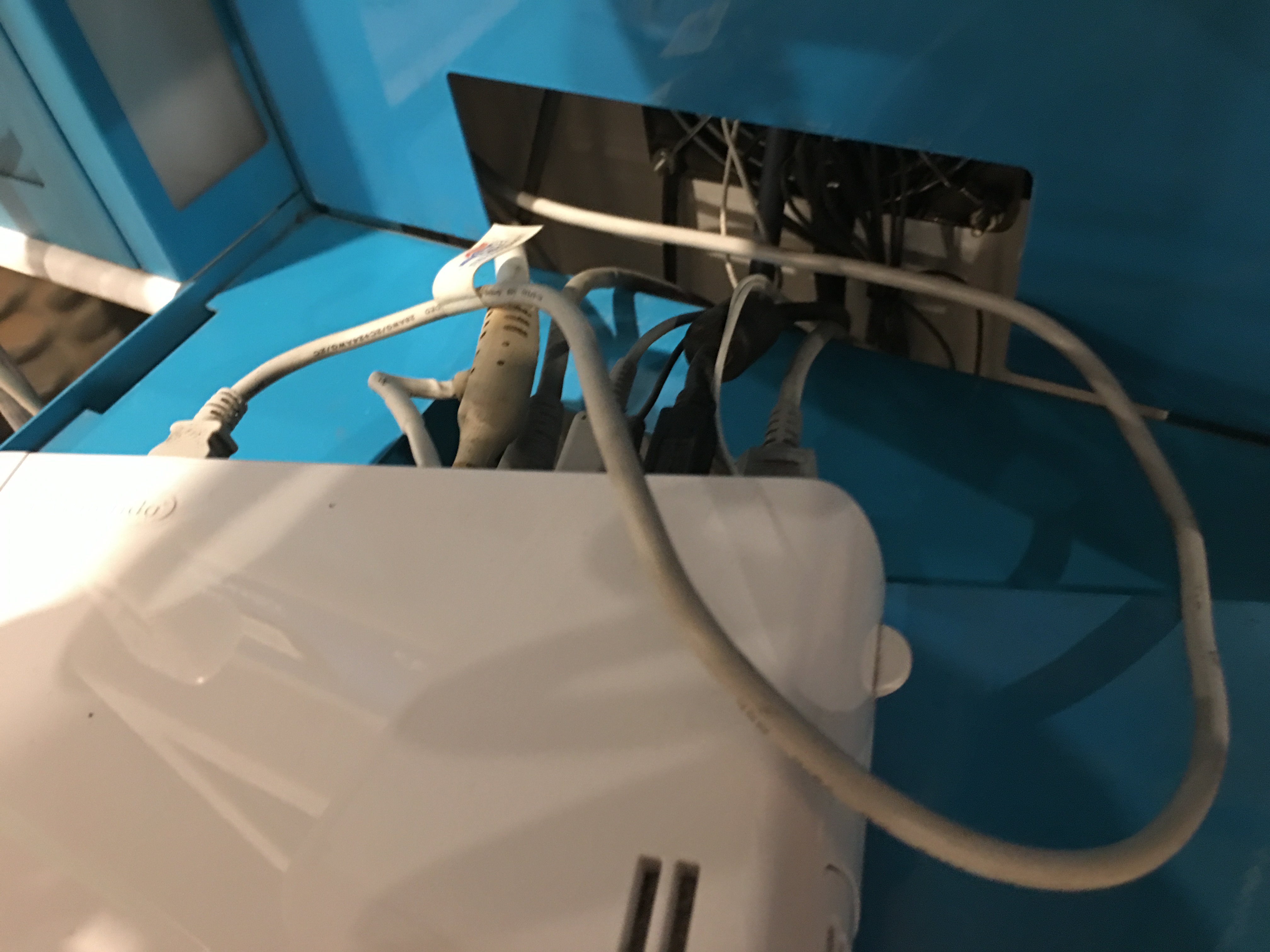

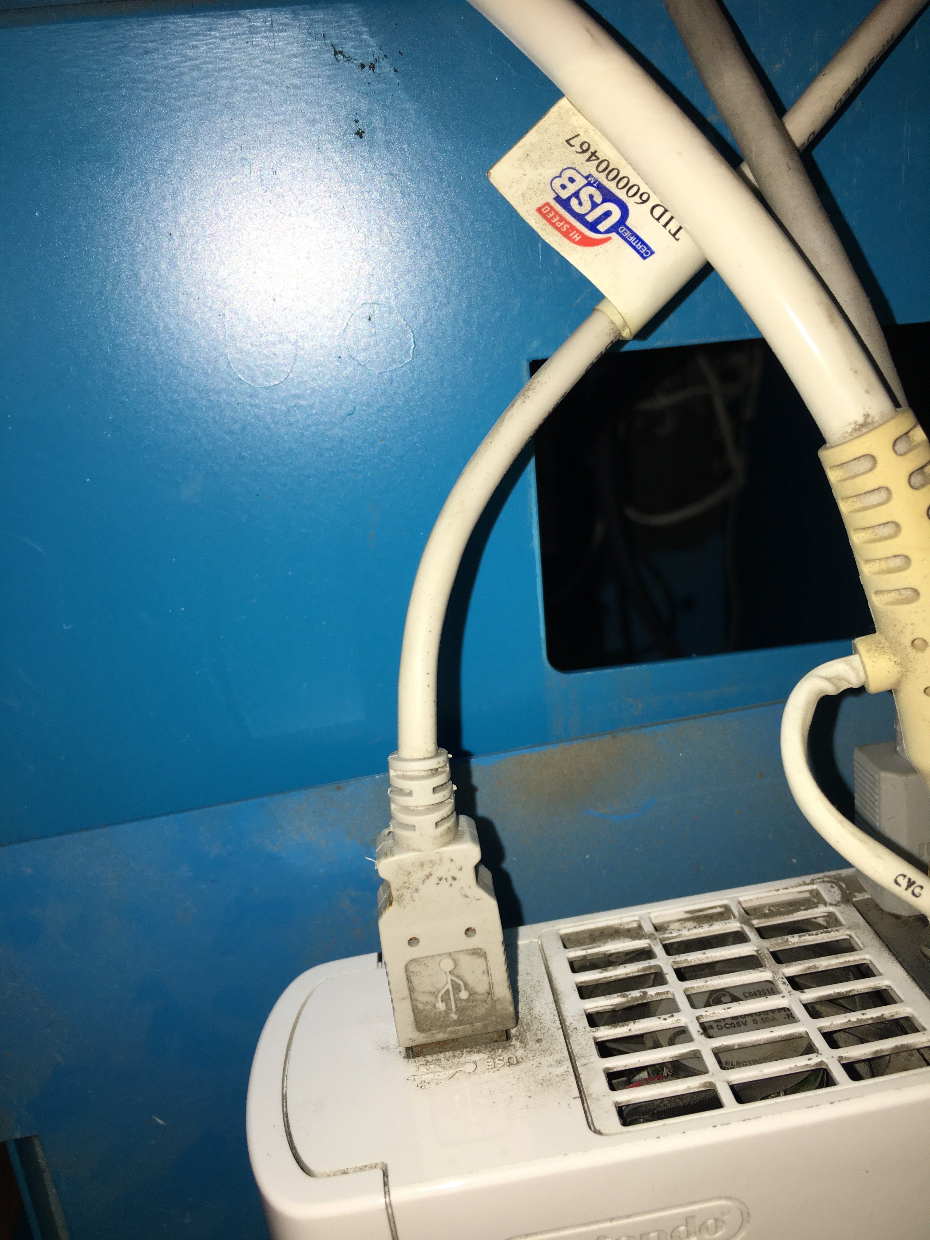

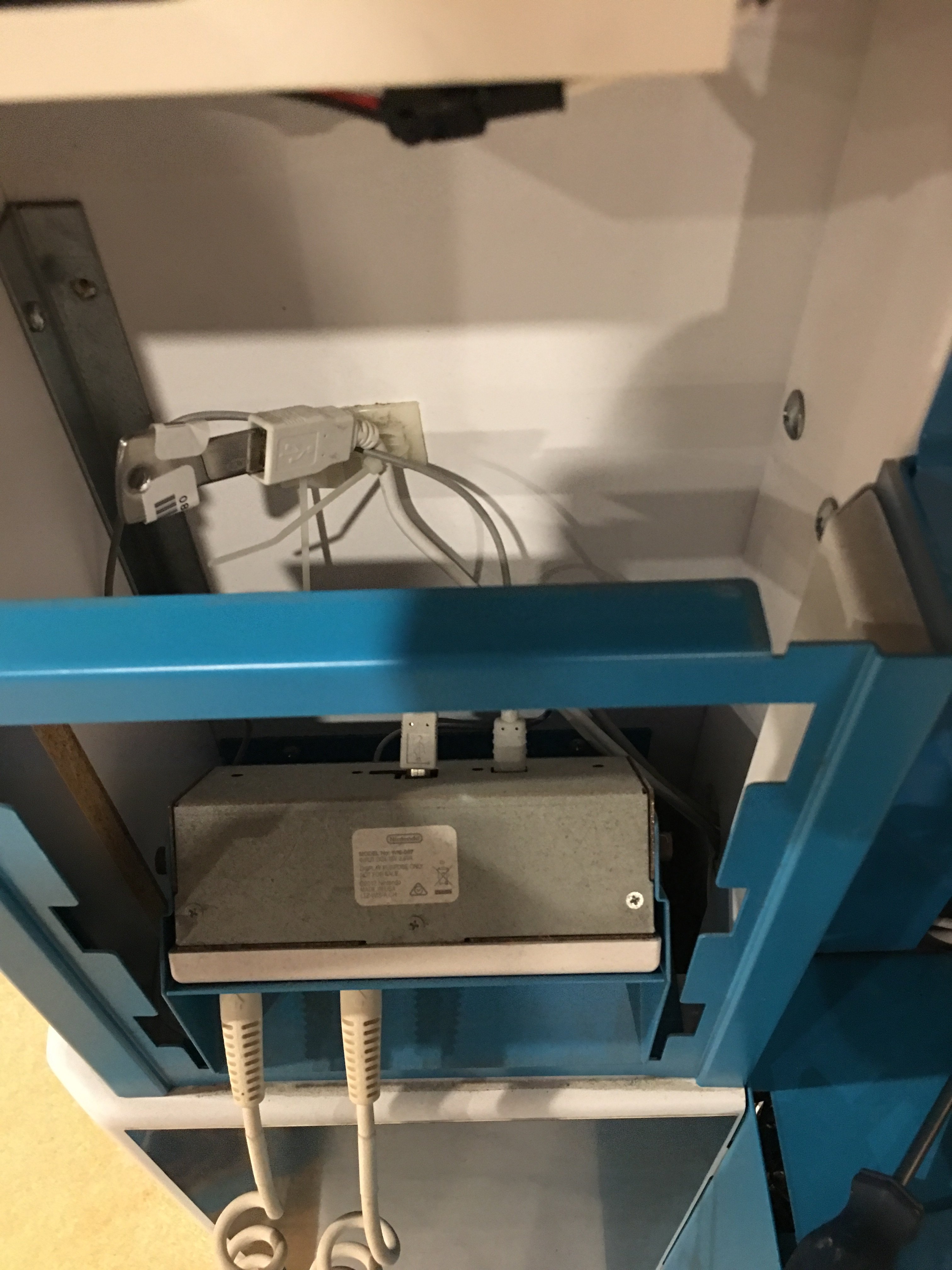

    On GBATemp, you mentioned that there's a USB cable running from the Wii U to the Ubuntu box.
    Can you take a photo of where the USB cable runs into the console?
    Your particular console has an HDD inside (in addition to the one in the Ubuntu box). It emulates a disc drive and has a USB port on the back. It's possible that the USB cable runs from the back of the Wii U disc drive emulator to the Ubuntu box and the decryption key is stored on a chip on the Wii U.
    After booting the Ubuntu box, do you see anything before the Wii U logo shows up?
    I'm also not clear on which unit is being displayed on the kiosk screen. Do you switch between inputs to see the Wii U and Ubuntu box, or does the Ubuntu box do all the video output?
  11. koko
    koko Rising Member
    Aug 25, 2017
    52

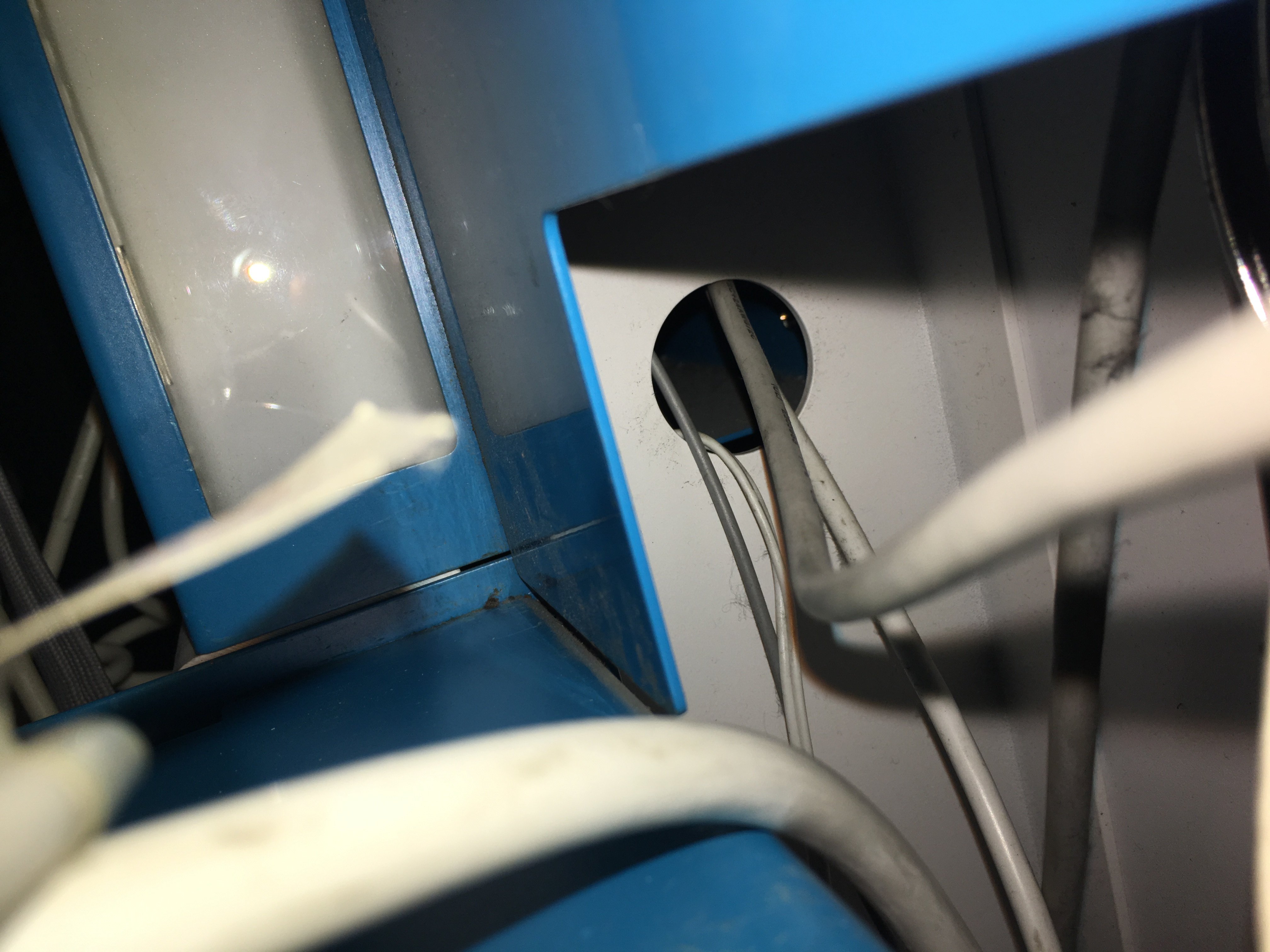

    Well I feel slightly stupid, I've assumed the usb coming off the back went down directly to the silver box below. It actually first travels in behind to the left where the controllers are, then another cable, could be the same I dont want to tug on it, travels back out the hole then down to the box. I guess I'm opening up the kiosk? The Wii U definitely unlocks the box, I've posted the two screens above that show up before the splash screen and when I unplug the usb cable from the box it goes back to the ubuntu screen. The Wii U splash screen is the silver box, it just sits on that screen after logging in. I questioned whether the silver box needs to be hooked up to the internet, but I'm scared to try. The kiosk came with 2 hdmi cables hooked up to the tv, the guy said it came from the store like that. So I would assume the silver box was always hooked up on the second hdmi input.

  12. koko
    koko Rising Member
    Aug 25, 2017
    52

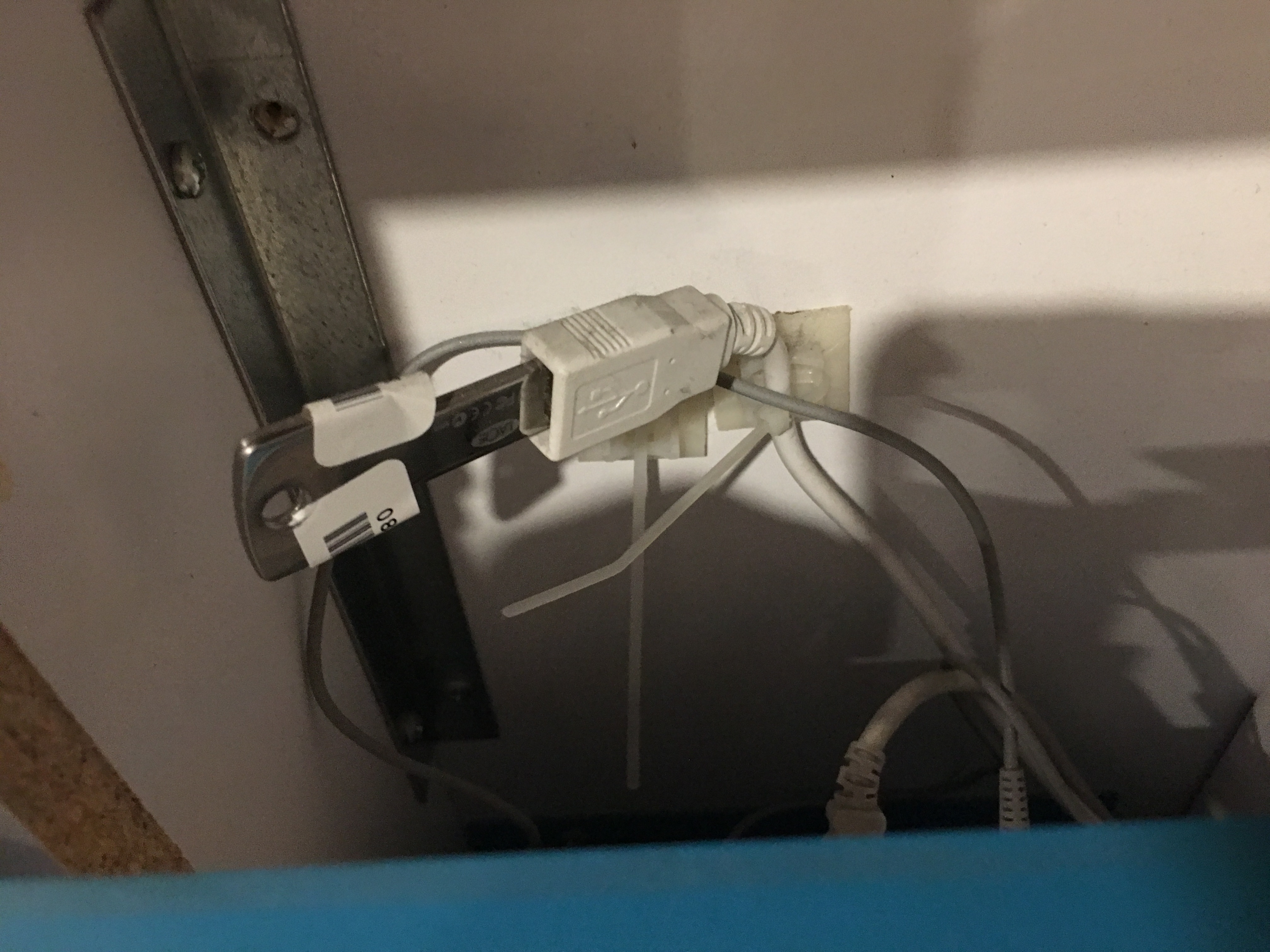

    So took off the TV bezel and found.....

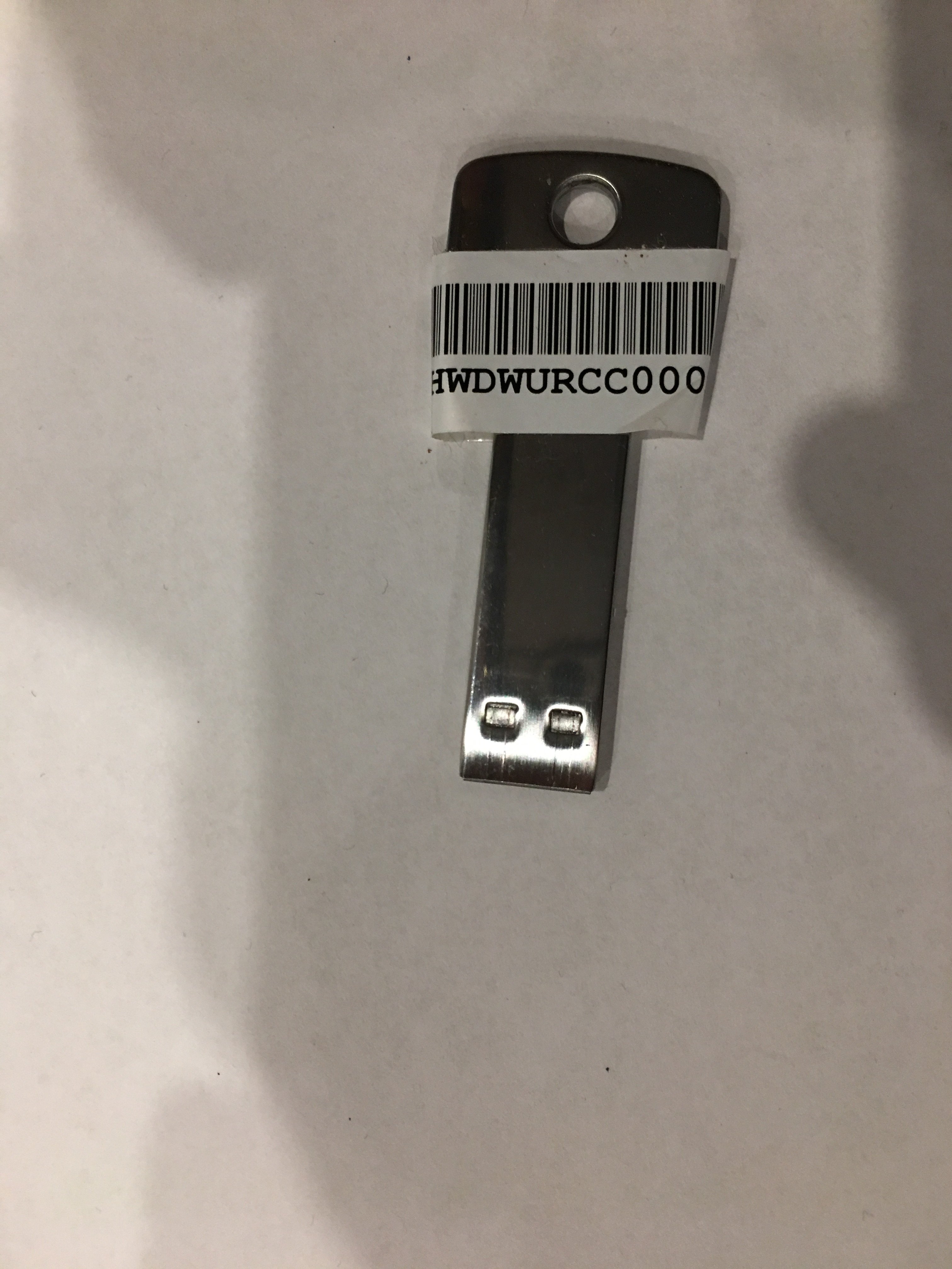

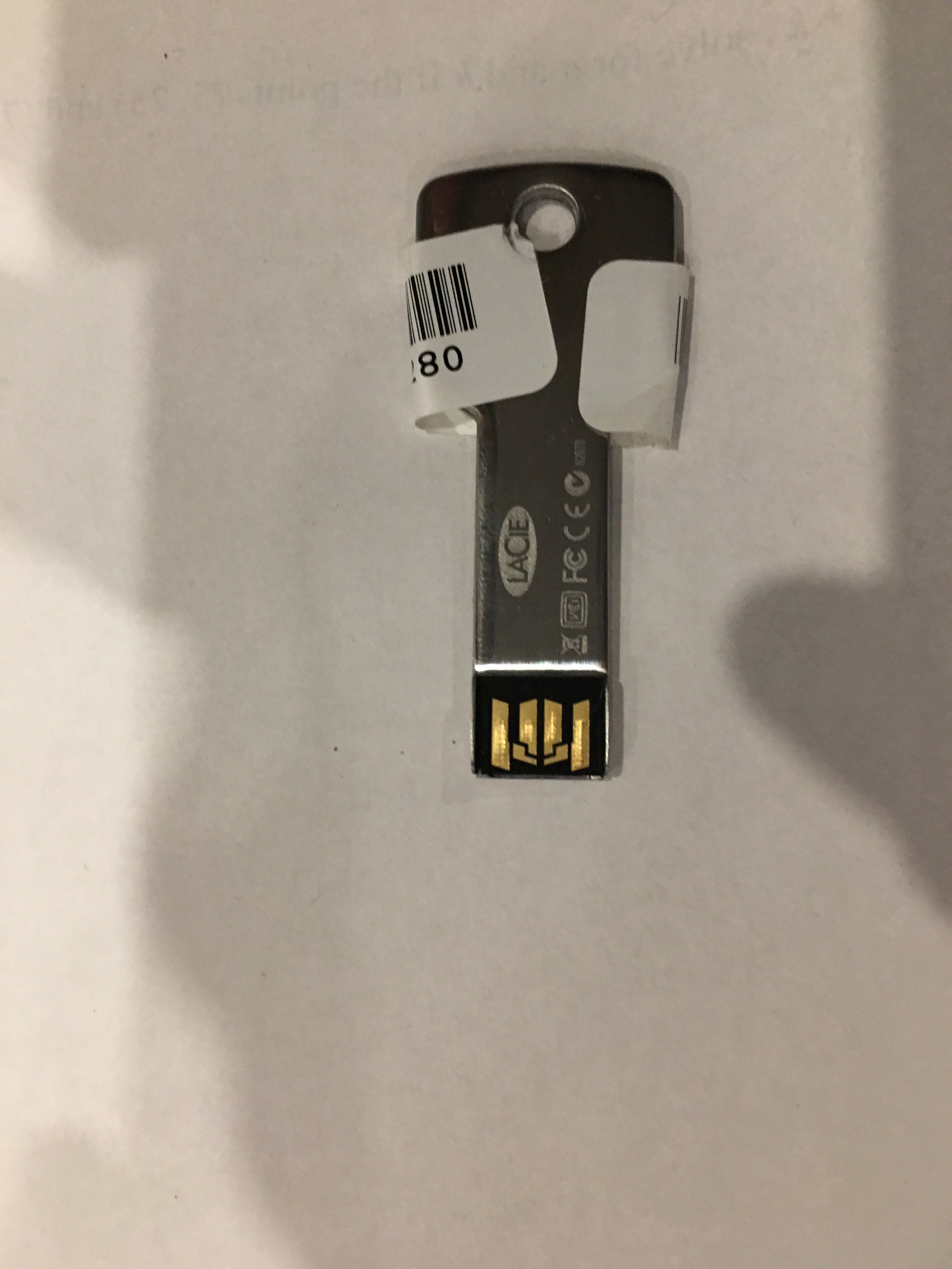

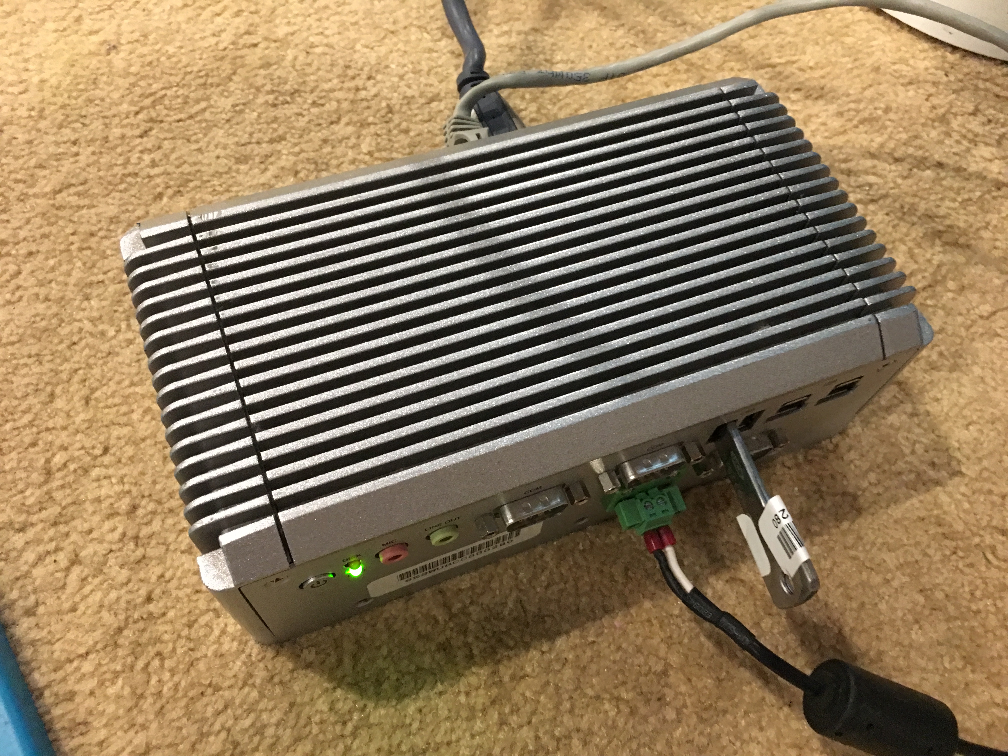

    The actual key for the box. Is this safe to put in my comp?

  14. pstrick1
    Aug 6, 2007
    679
    144
    The plot thickens...
    This is such a weird setup. There are so many cables running everywhere I can't even begin to visualize what's going on.
    To clarify, the Wii U console is hooked up via HDMI and shows you the standard kiosk menu.
    The Ubuntu box is hooked up via a second HDMI cable and shows all the Ubuntu stuff?
    Maybe the silver box is used to load demos onto the kiosk unit.
    I remember reading that there was a key used to load demos onto the kiosk systems and that it was really hard to find.
  15. koko
    koko Rising Member
    Aug 25, 2017
    52
    Pretty much. There are 2 hdmi's, one to the console, one to the box. The box seems standalone, there aren't any other cables running between the two other than an ethernet. If the ethernet is running from the box to the console, how does the box connect to the internet? The box appears pretty standalone and definitely Nintendo, someone also suggested it can be used to update the console but how? There's tons of cables but none would seem to fit that task. In addition only half of the demos work, that's my main motivation for all of this, but I have no idea if that's related.

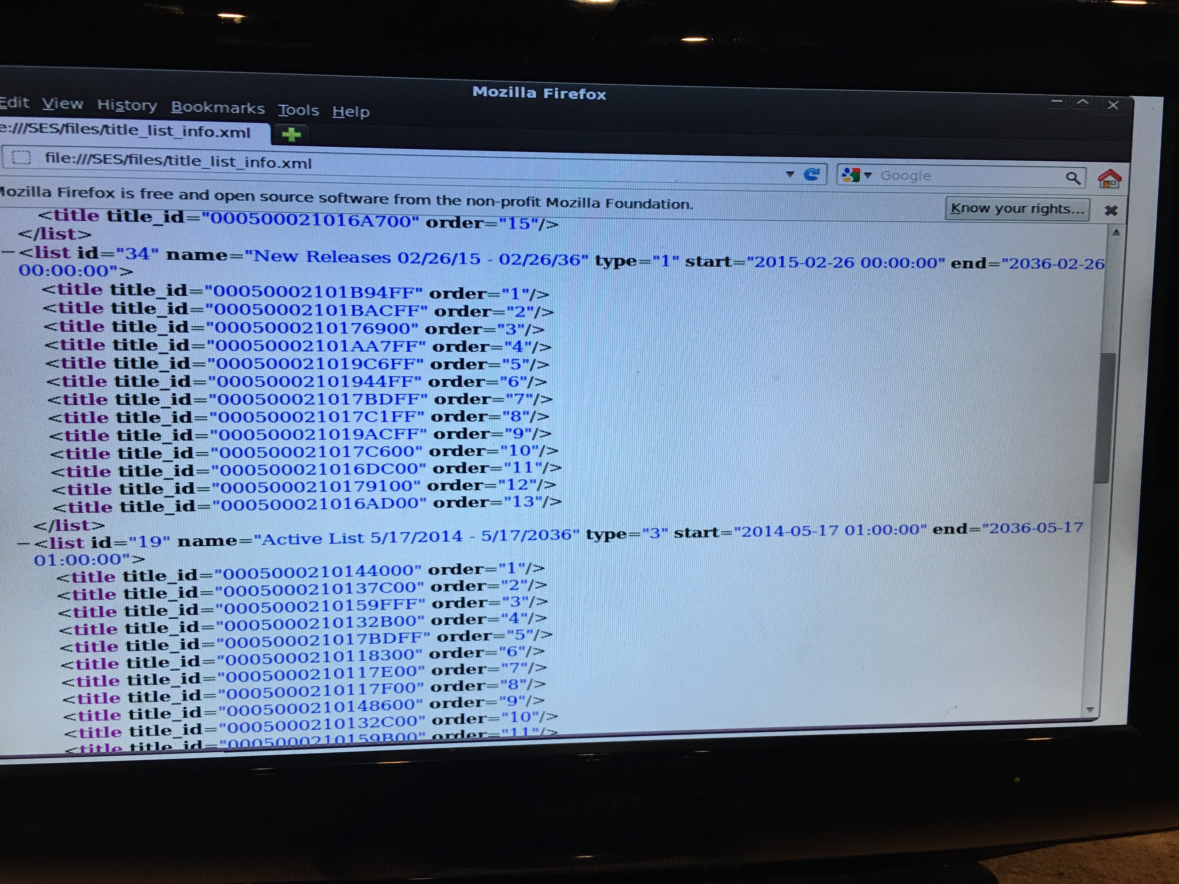

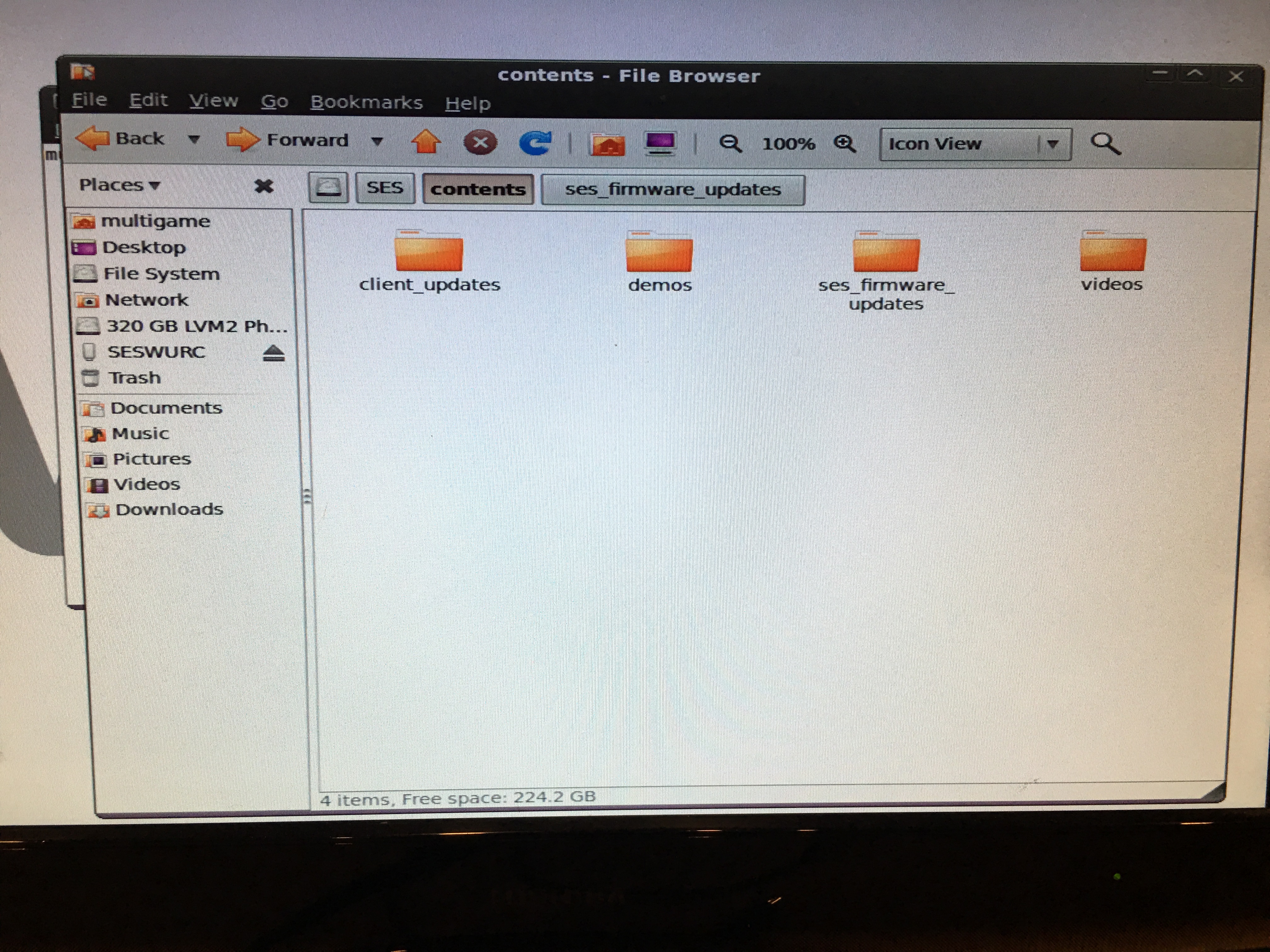

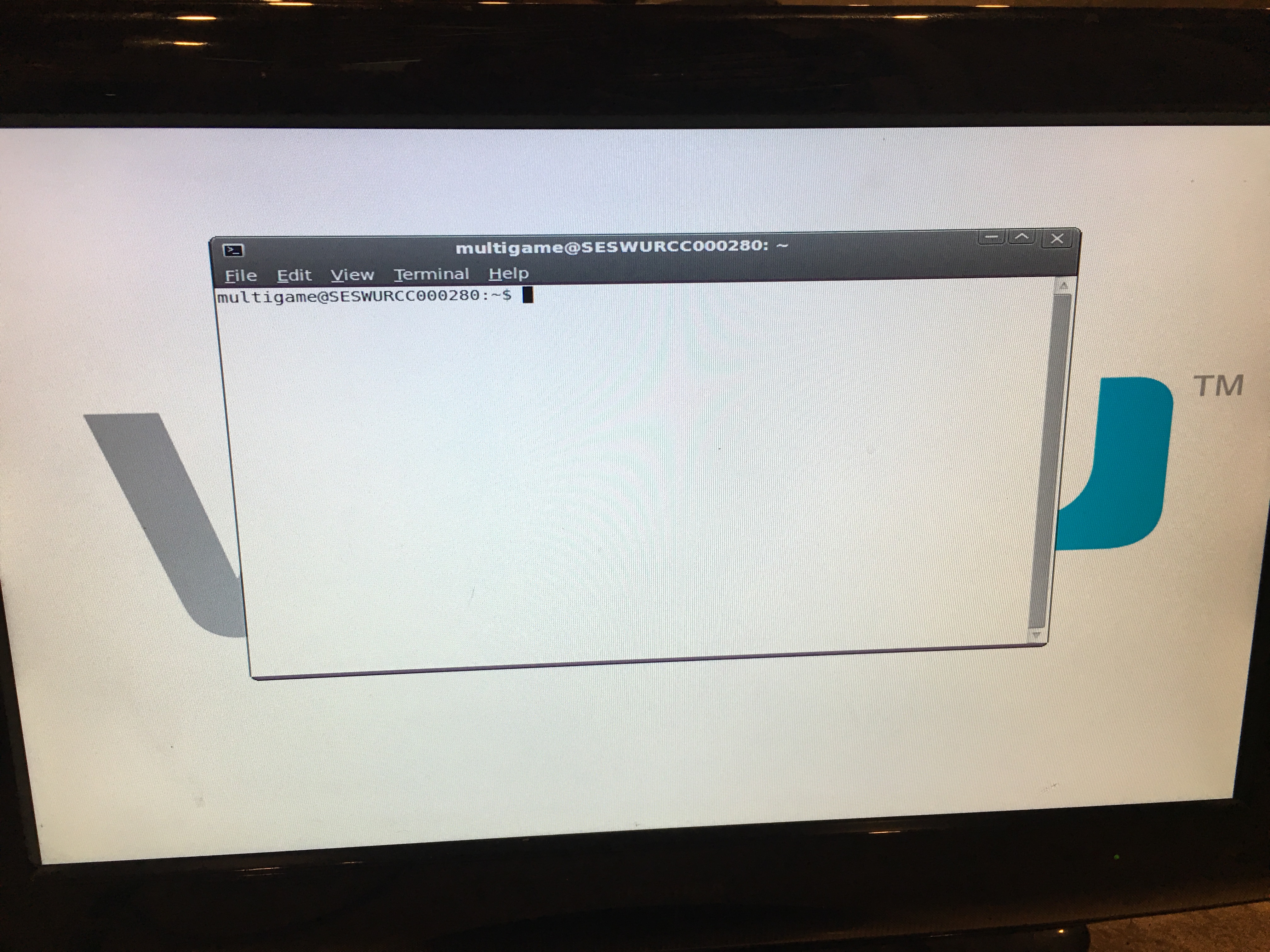

    Got a terminal open, login is called multigame. Going to try and see what is on it.

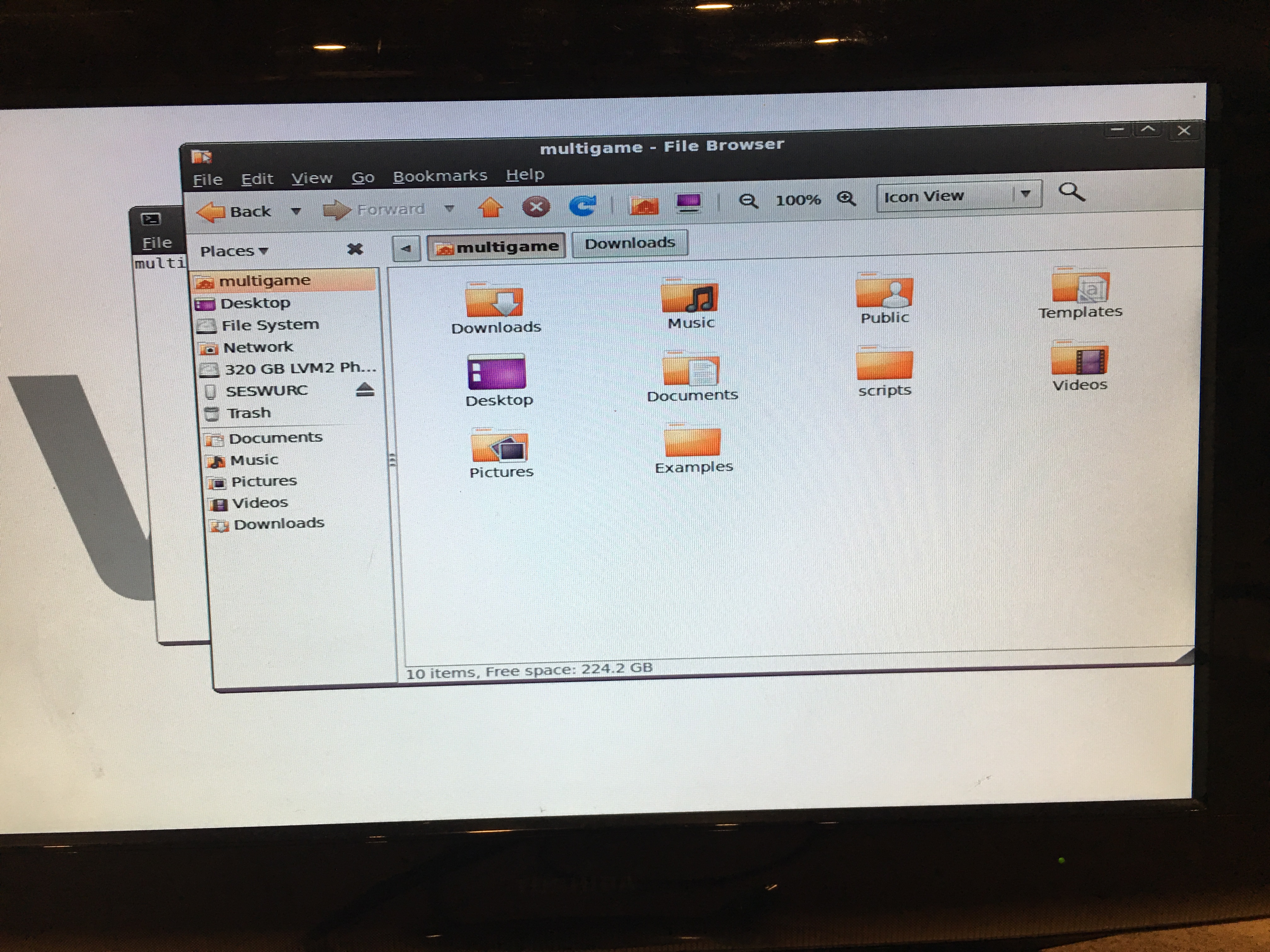

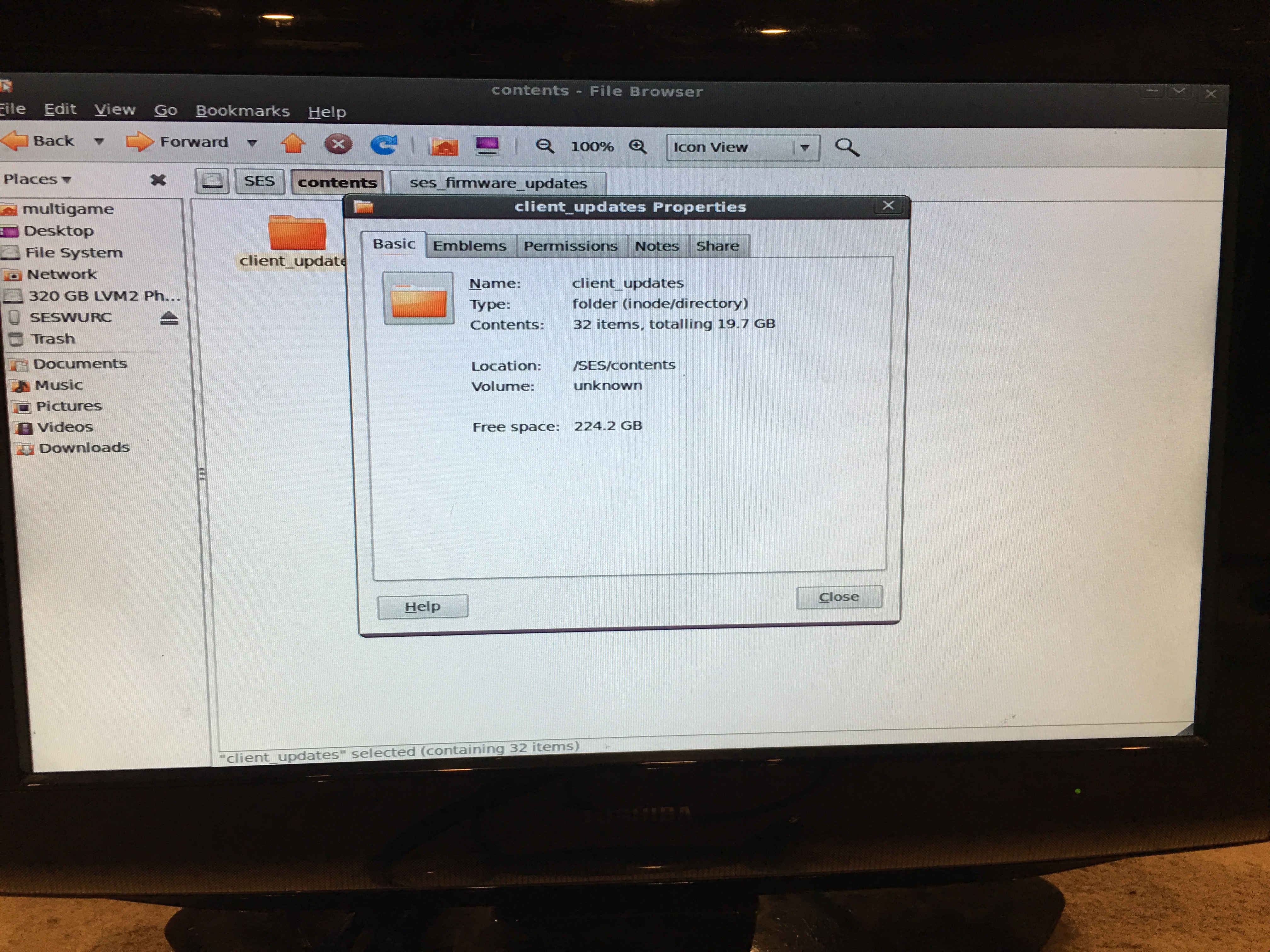

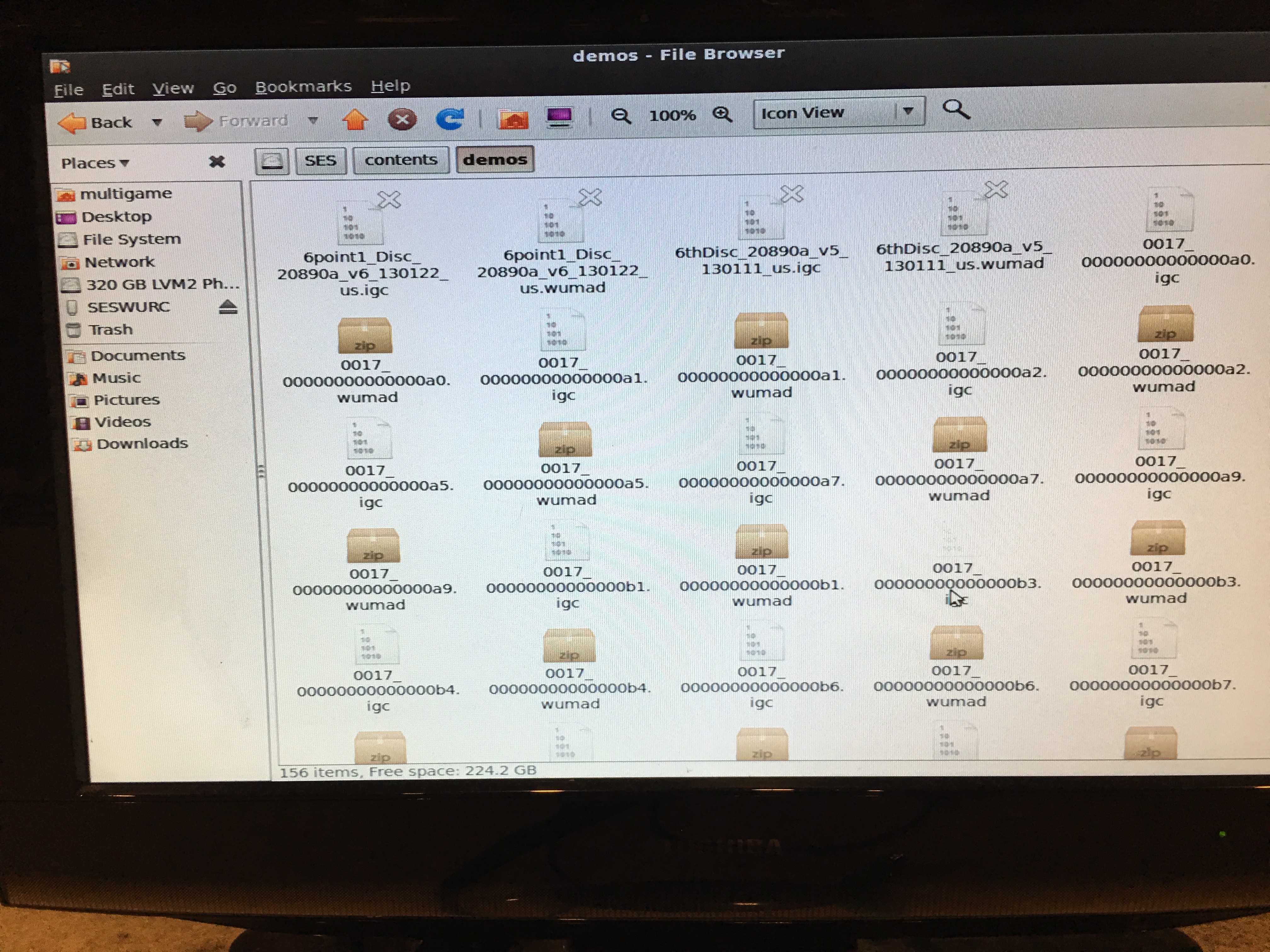

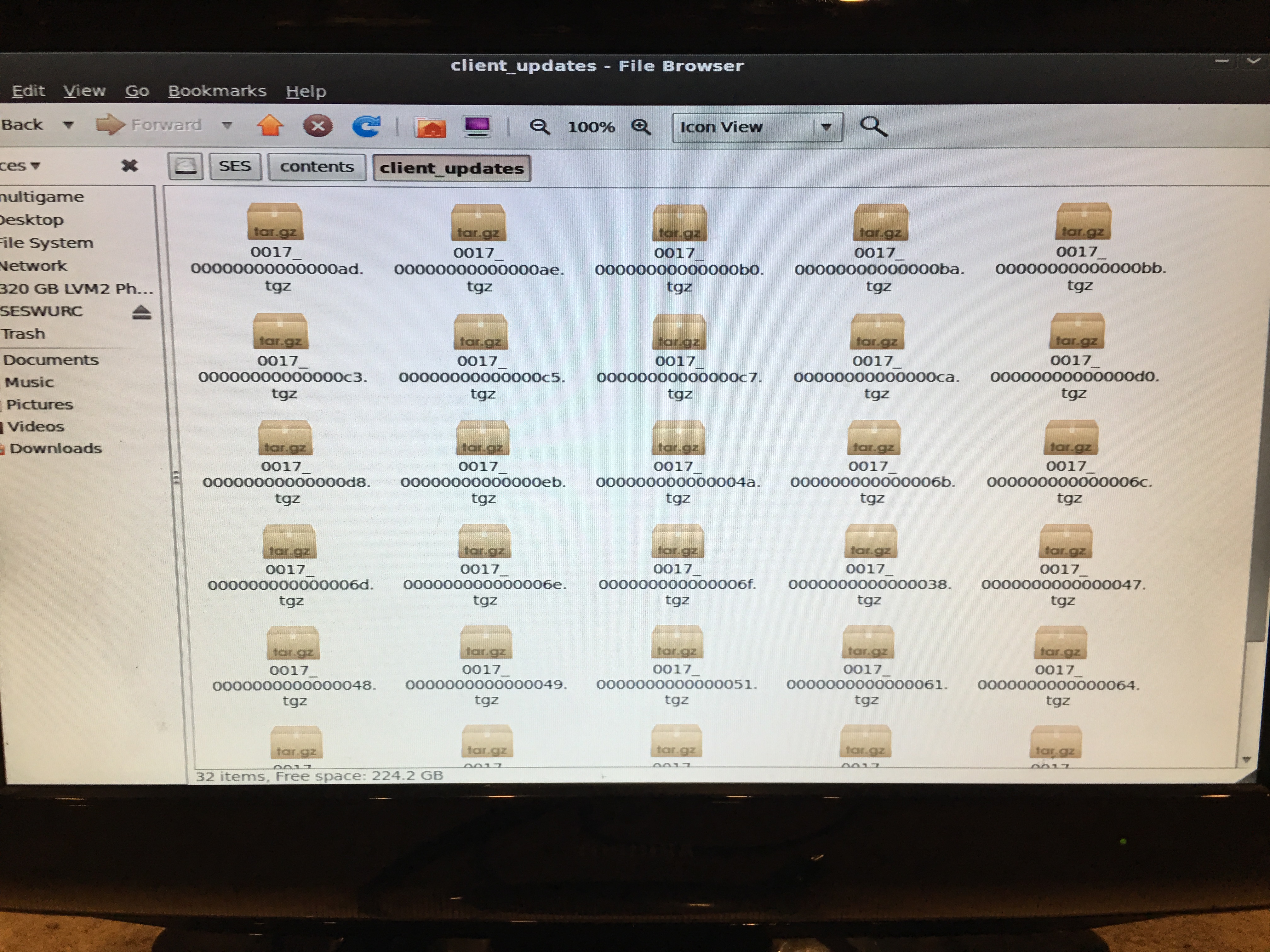

  18. koko
    koko Rising Member
    Aug 25, 2017
    52
    Jackpot?

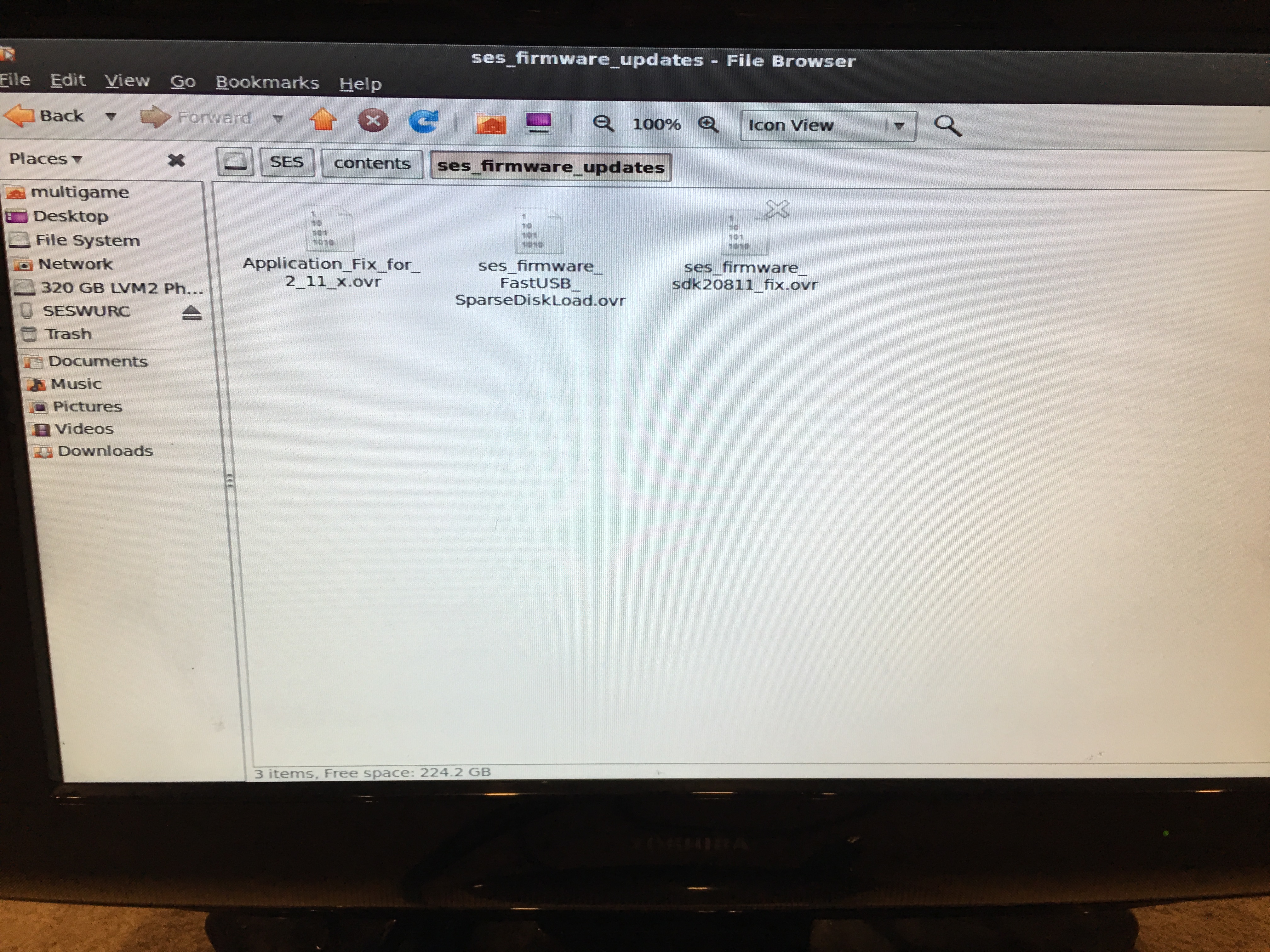

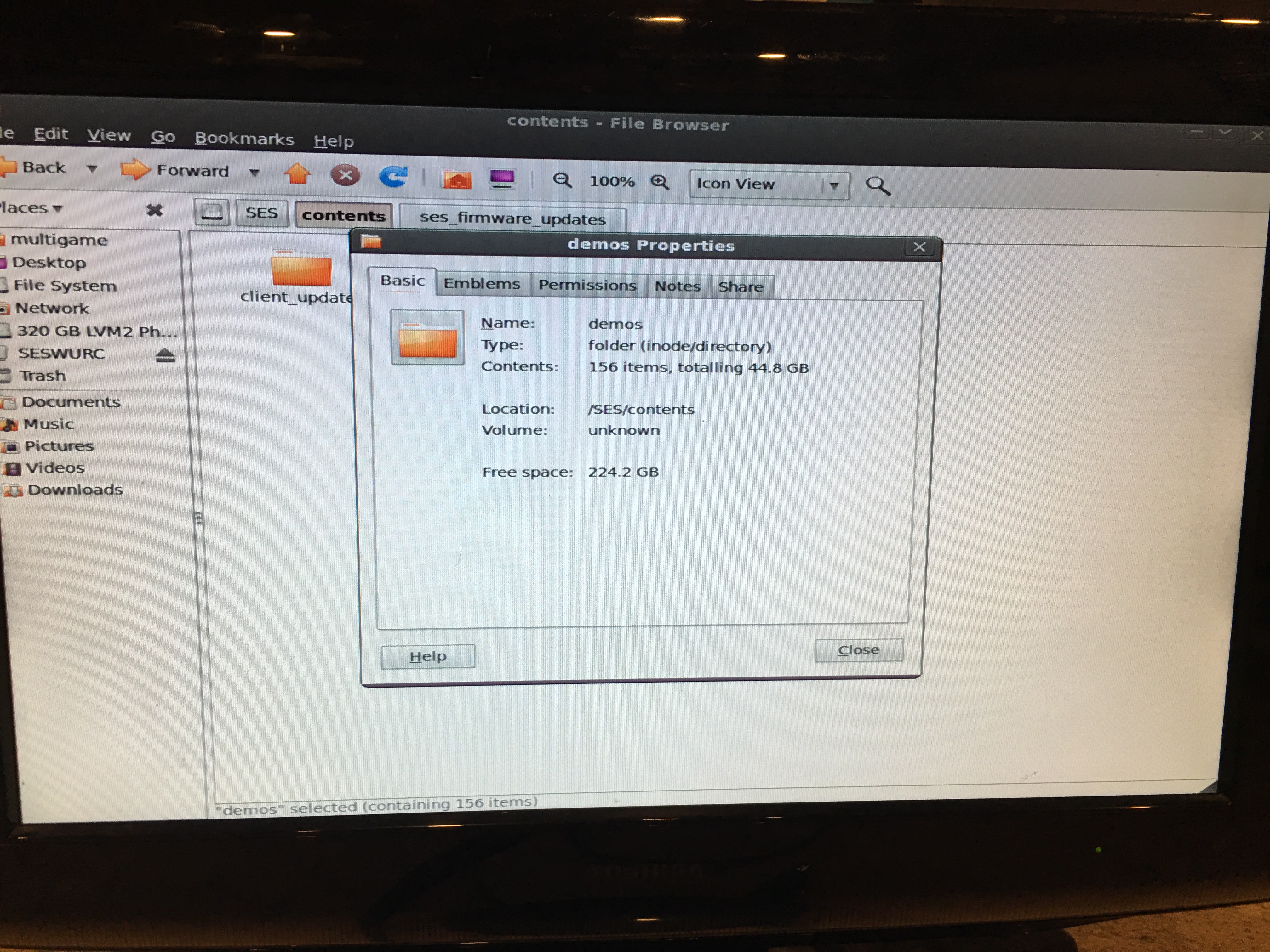

    It seems you are correct.
    IMG_4989.JPG IMG_4998.JPG IMG_4997.JPG IMG_4999.JPG IMG_5001.JPG IMG_5003.JPG
    uyjulian and crissybwoy like this.

  20. koko
    koko Rising Member
    Aug 25, 2017
    52
    Is this data useable to any particular group of people? I don't want to going through the hassle of trying to back this up if this is already out there. Linux is way out of my comfort zone. The data is also able to be copied, I copied a file to the desktop.
