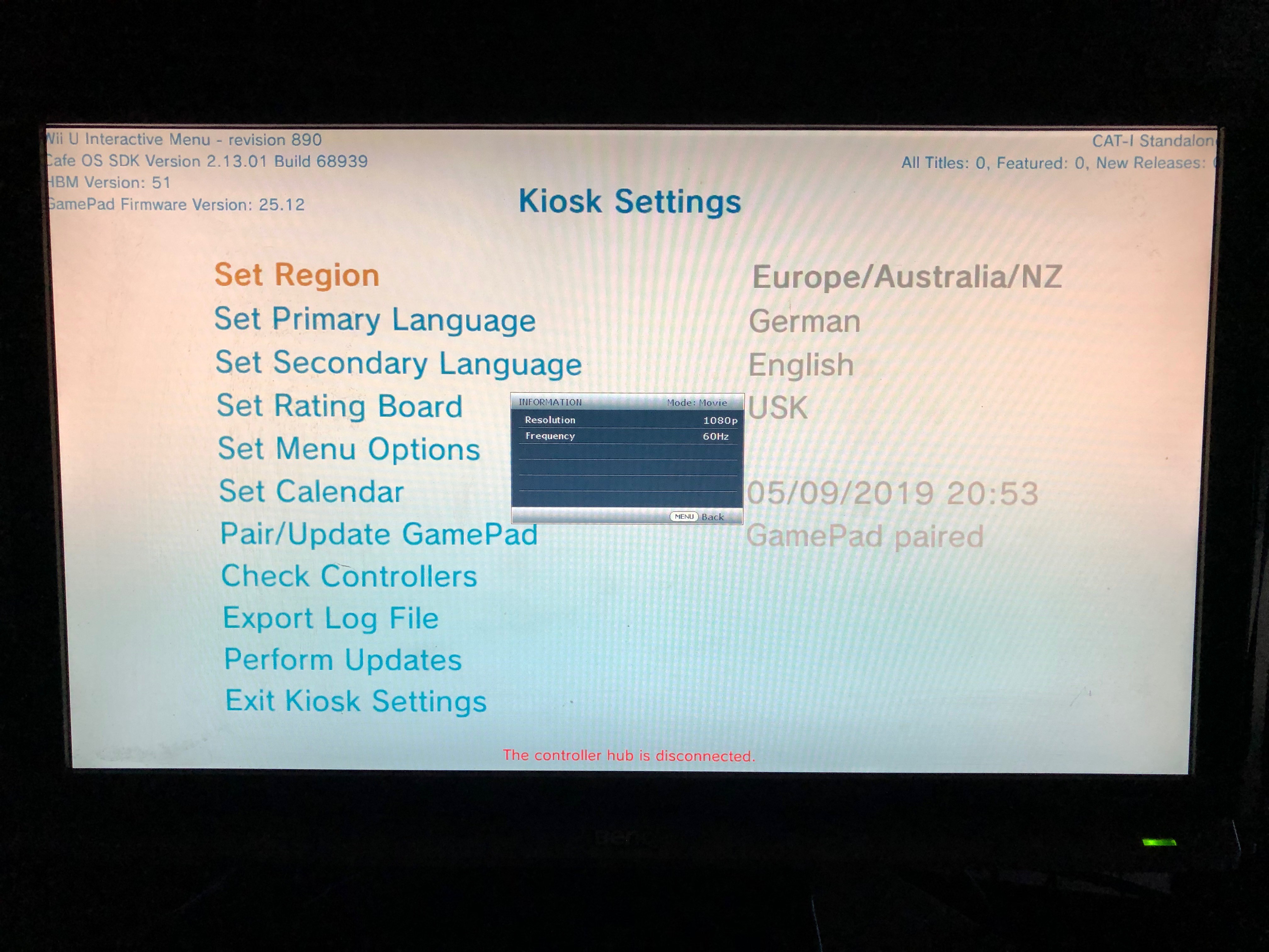

    I bought/received a Wii U Demo/Kiosk Unit (WIS-001). When I test the unit the gamepad is working fine and the console makes all the normal stuff that a retail unit is doing (checking the disc drive at the beginning and the blue LED is constantly on) but I get a black screen on my TV.
    I tried to use an RGB connection via Scart from the Multi-Out and HDMI connection but both connections give me a “no signal found” message on my TV (I also tried Scart via my PVM (Scart to BNC-Adapter) but no luck.)
    The unit is working to some kind since putting in an empty SD card will boot the Kiosk Menu/Service Menu, but I can only change the settings of the Kiosk stuff and not the preferred TV connection within this menu.

  2. pvogt002
    pvogt002 Member
    May 2, 2013
    So I tried it on a more modern PC monitor and there it is working fine. So the resolution is HDMI/1080p/60Hz.
    So I think you cannot change it with the standard Kiosk setting and just need to make sure to use a setup which supports 1080p/60Hz via HDMI. So only TVs from 2004-2010 might have problems with it.

    These units are usually connected via HDMI. No idea whether analogous video is supported or not. By inserting any SD card you can boot into settings mode (which you have done concerning to the screenshot).
