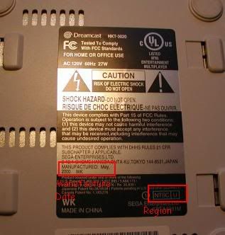

    Dreamcast systems really don't need to be modded to run burnt discs or unsigned code. Only something like 5% of systems made towards the end of the manufacturing process would need to have something like a bios mod to re-enable the same exploit all the previous mil-cd systems had. Typically just look for a system made before October 2000 you should be ok if it has a #1 inside the circle on the bottom below the MFG date. It is really rare to even get one of those systems that can't play backups so you shouldn't really worry too much. The included pic should help you discern how to read the bottom. Where the region is that circle with the number is what you want to look for.
