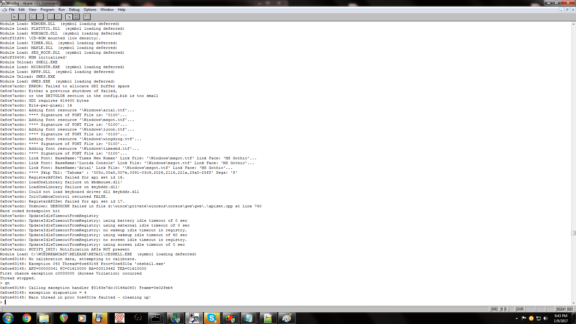

    There is source code for a sample Shell in Windows CE 2.11 Platform Builder (Latest Dreamcast version is 2.12). I had to comment a bunch of stuff out for battery and touch screen, and gather a few missing header files to compile it. Then launched it with "Autorun". Here is the WinDBG output
    So it does attempt to load the Shell, but launching it this way it halts at "Sega: Produced or Licenced by..." screen

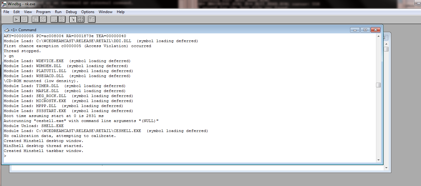

    Got the unmodified source code to compile for Dreamcast. It's a perfect "port" to Dreamcast
    You can clone the source code and compile "out of the box" with WCE Dreamcast SDK
    https://github.com/FaucetDC/WincastCE
    Crashes on launch though. I'm not skilled enough to figure out why
