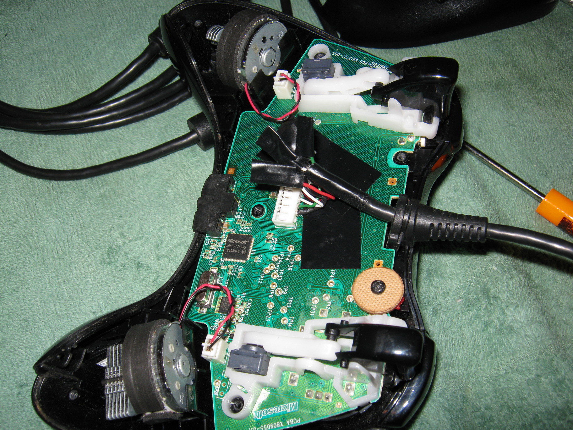

    These are a little notorious for breaking cables right at the controller, but usually you have intermittant connection before nothing. You can shorten the cable as shown, just be aware there's little headroom inside so keep things shallow.
    EDIT - memory of this repair is coming back. Two tips. First I freed the ferrite while I was at it, because I blame it for the stress that causes the break. I just let it slide down the cable out of the way. Second note the big brown insulated washer -- that's to hold the guts in place while you work.

    so did you unwrap the wire and fix the broken connection? what is the ferrite?
    i cant really see what you did behind the tape

    Oh, and under the tape is nothing but connected wires. I cut the bad portion of the cable off, and threaded through the relief unit of the controller there, and then soldered the cable ends to their mates in the little connector. Tape plus crazy glue is used to insulate the soldered bits from each other, that's all. Threading through that relief unit took a bit of work IIRC. Used hot water to expand it, plus stern words.

    i opened it up and the wires going into the back of the board seemed fine, i'll edit with pictures later
    i plugged it in to the xbox while open and i can feel heat generating from the tiny "Microsoft" chip to the bottom right of where the wires connect to the board connector. there was no signs of damage to the board, though there was some dried gunk on the underside of the left thumbstick shell lip, but again nothing on the board, doesn't smell like burned circuit board or anything either
    so if there's heat from the tiny chip, then the wires are good?
