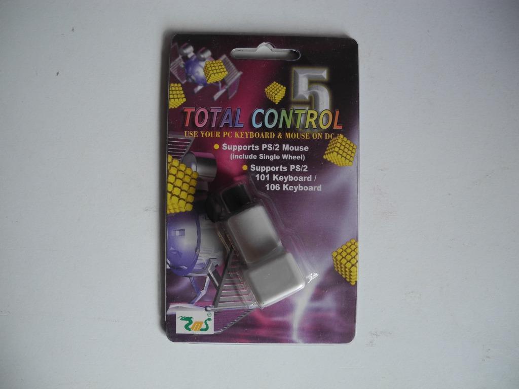

    I'll also get these Total Control 5's for a PS/2 mouse.

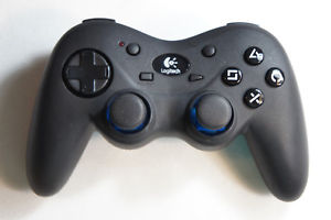

    And I also bought a few Logitech wireless PS2 controllers.
    They work very good on my Sega Dreamcast with an original GDEMU.

    These Logitech wireless joysticks work fine on the Sega Dreamcast, through a Total Control 4,
    even the rumble function.
    Analog modus of the Logitech joystick has to be on when the game boots.
    Otherwise the VMU is not recognised.
    The front L2 and R2 buttons are digital, but the right analog stick on the Logitech wireless controller
    works as the analog triggers of the Sega Dreamcast controller.
    So forward on the Logitech right analog stick is the Sega Dreamcast joystick right trigger. (Gas)
    And backwards on the Logitech right analog stick is the Sega Dreamcast joystick left trigger. (Brake)
    Similar to the Gran Turismo setting on the Playstation ?
    The left analog stick on the Logitech controller is for steering.
    This works very good for me, better ergonomics than a Sega Dreamcast controller, to be honest.
    And wireless.
    Logitech joystick analog sticks out of whack, not working properly ?
    Recalibrating the Logitech PS2 wireless controller analog sticks can be done by
    removing one battery.
    Pressing L1 + L2 and inserting the battery.
    Do not move the analog sticks while you insert the battery.

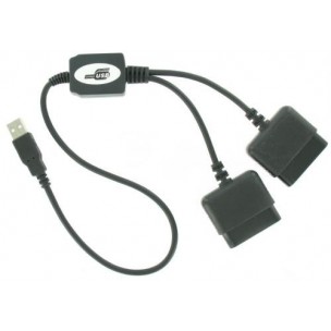

    Voila, 2 wireless controllers for my PC (through a usb converter) and my
    PS1, PS2 AND Sega Dreamcast !!!

    the Total Control 5 is amazing for mouse or keyboard! I use mine with a laser mouse and its excellent for quake and outtrigger.
    the maker of these' website is hkems.com and heres a direct link in english http://www.hkems.com/product/dc/dc-index.htm
    i find their products are cheaper on ebay or elsewhere though (somehow?)
