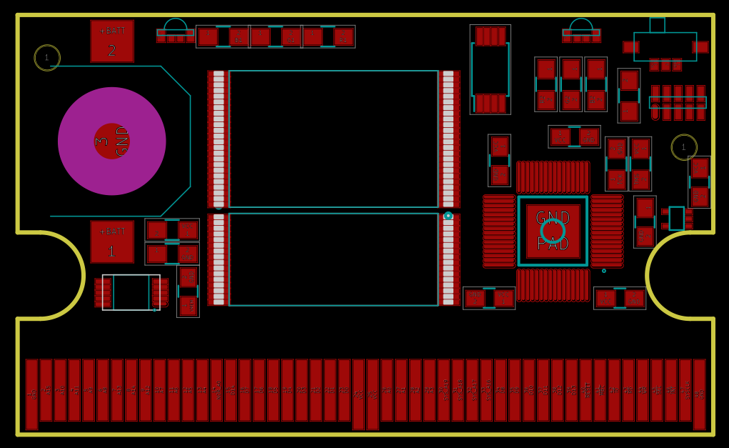

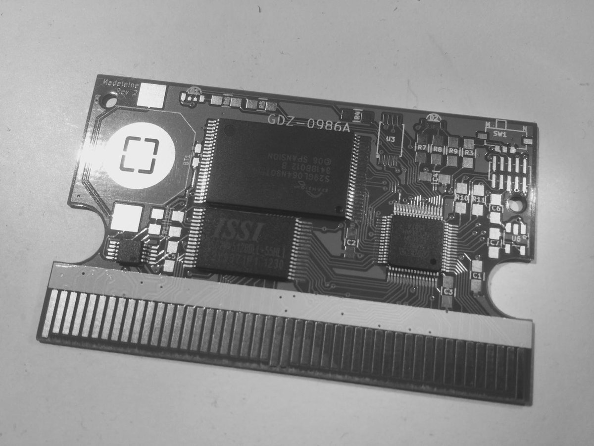

    Some public pictures of the Madeleine:
    [​IMG] [​IMG]
    (yes some are intentionally blurred because they show some specificity of the board :))
