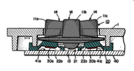

    Finally I look both the newly acquired GBC and my original apart and decided to examine the plastic D-pad itself. Sure enough, there was a significant difference: the plastic ball pivot on the back of my original GBC pad had a flat spot on the top from being worn down, while "new" unit had a perfectly round ball pivot. My brother was the joint owner of my original GBC and he was an avid Pokemon player for several years, and between the two of us that thing has seen quite a bit of abuse.
    I had one of those crappy Chinese knockoff D-pads lying around and it made things a fair bit worse, since it would press all 4 directional buttons at once rather than allowing it to pivot (I don't recommend ever buying Chinese knockoff parts). I don't know of any way to repair the worn out one, so the only solution seems to be to replace the D-pad with a genuine Nintendo one. Maybe someone with a little more knowledge of things like plastics, adhesives and resins even has some ideas for how to restore the ball pivot's shape, but I just opted to order a genuine pad from eBay as a replacement.
