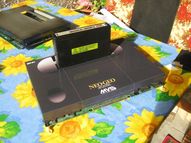

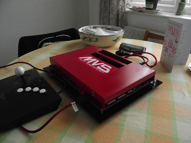

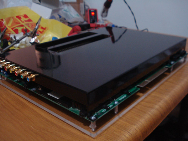

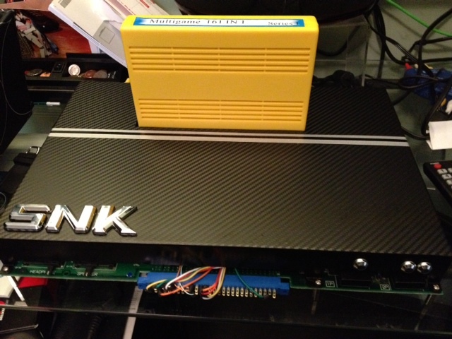

    I've uploaded a few pictures to give you some idea of the final product.

    any of those yours ? ive seen some of those with a google search ? love the carbon fiber look and burgundy/red one.

    Mine is way more simplistic. Those pictures I took the day I've finished it.
    I've added as many feet I could so it's really steady.
