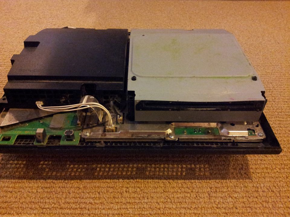

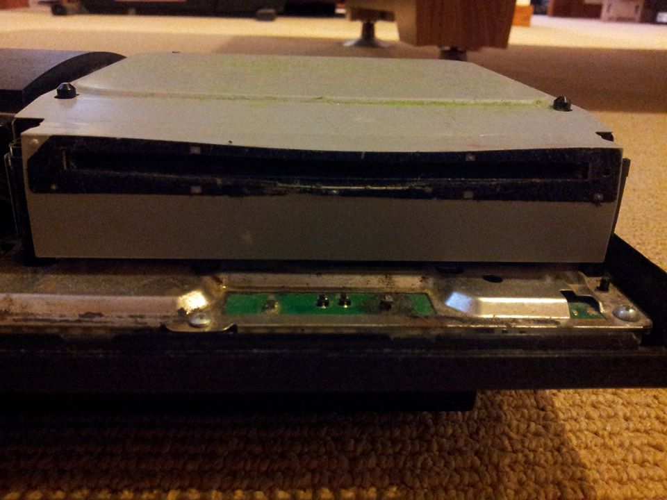

    I've had this unit on my hands for a while and I'm just looking for someone who can fix it up for me. From what I was told by the last owner, it needs a new disc drive, which is pretty obvious when you look at the pictures (looks like it suffered a heavy impact). The unit does power on, but no image appears on the screen. There may be other problems with it (judging from the filth inside), but I'm not a huge PS3 expert, so I wouldn't know. Prepared to pay whatever it takes.

    Would it be cheaper for you to get a new system or get it repaired by Sony (out of warranty service: $129 for BC unit, $99 for FAT non BC) ? If you really want to keep it for personal reasons, then it'd worth it to get it fixed

    Are you sure that system is BC (i.e the model number ends with A->E) ? The board and the PSU are not the ones come with BC units.
    HDMI won't output picture could be some HDCP hand shakes issues. Try the analog output (composite, component, S-Video) to see if there is video. To reset video setting, hold the power button when turning on the system until you hear a second beep.
    I have all the parts that you could use to fix the systems but it's time consuming and in the end you might have to pay about the same amount as sending in to Sony for repairing (they give 90 days warranty also)
