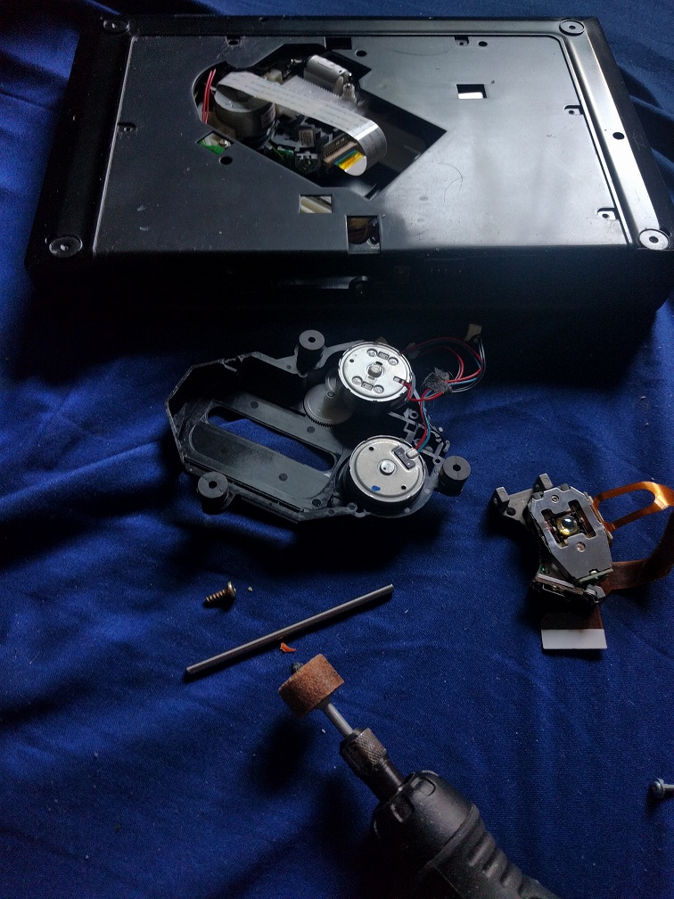

    bump i actually got the metal bar replaced! turns out it was 3mm (x 66mm) diameter which is pretty common for RC hobbyist stuff and other things. However, I was able to score one from a broken portable DVD player and cut it down to size :)

    Heres a picture of how I procured that laser guide bar, for anyone thats interested.
