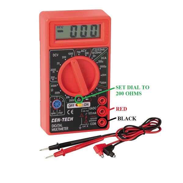

    you'll need to find the continuity test option on your meter

    Ok so lets see if I have this right:
    1) I set the multimeter to 200 ohms. Black on ground screw plate, Red on pin hole.
    2) If I get a 0 reading, that means there is continuity and it's a v1.4.
    3) If I get a 1 or infinity, that means no continuity and it's a v1.5
    Everything sound ok?
  3. sonicdude10
    Jan 17, 2012
    2,573
    Sounds right. Now go check it.

    ok so I think I my multimeter is not working properly. It seems I am getting no reading on anything I check, just 1's. Have to get a new one.

    Touch the pins together to test them. If it still reads 1 then something is wrong.

    Yeah that's what I did and I still am getting 1. Going to the store tonight to exchange for a new unit.

    No, -->+ set your meter to this instead of 200ohms and listen for a beep

    Turn it 1 click anti clockwise

    oh I got it thanks. Got a new meter from the store, be home later to check!

    I'm getting a fluctuating reading of 01.7 to 01.9 on the "-->+" setting (which is the diode setting according to my manual, not an audible continuity function) and a reading of 003 on the 200 ohms setting but the fact that I am getting anything besides inifinty mean it's a 1.4, correct?
    It appears this multimeter only has the diode setting and not a dedicated continuity function.
    Sorry davidthomas, I'll let you know if I come across any 1.5 boards in the future.
    In the meantime it's given me more reason to educate myself on using a multimeter. Thanks guys for your help!
