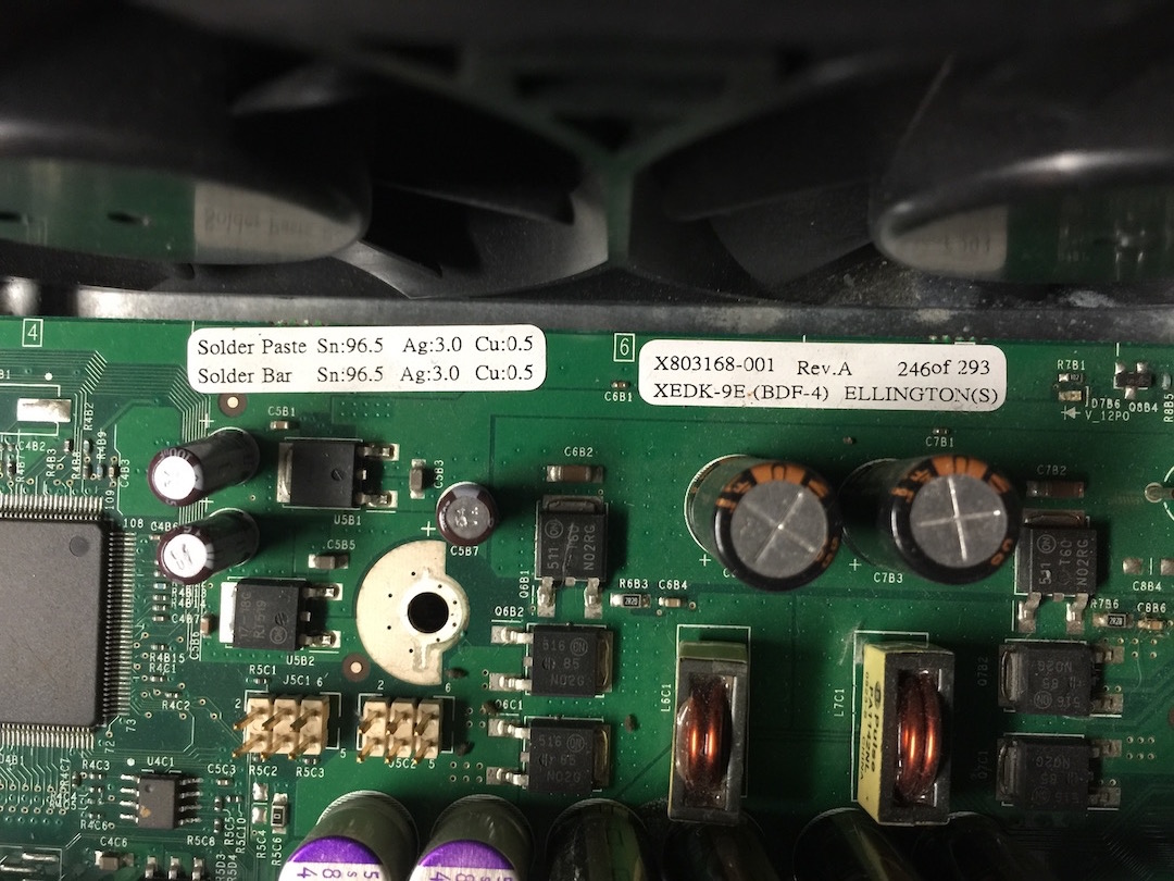

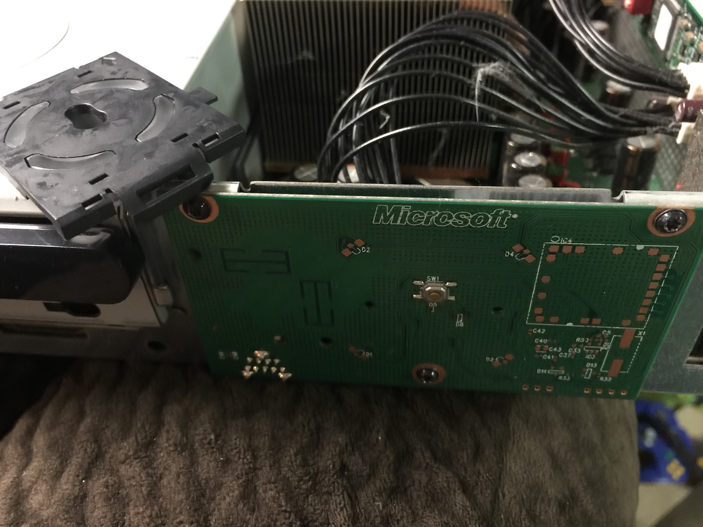

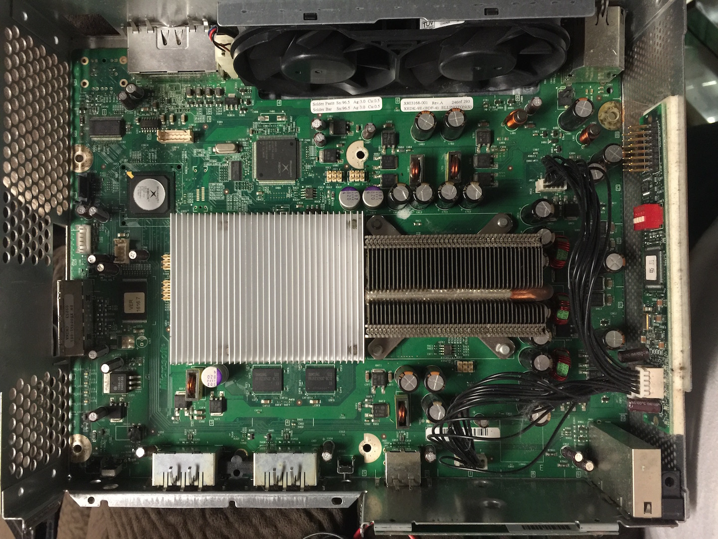

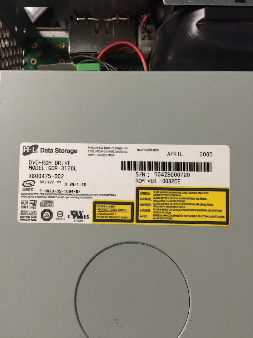

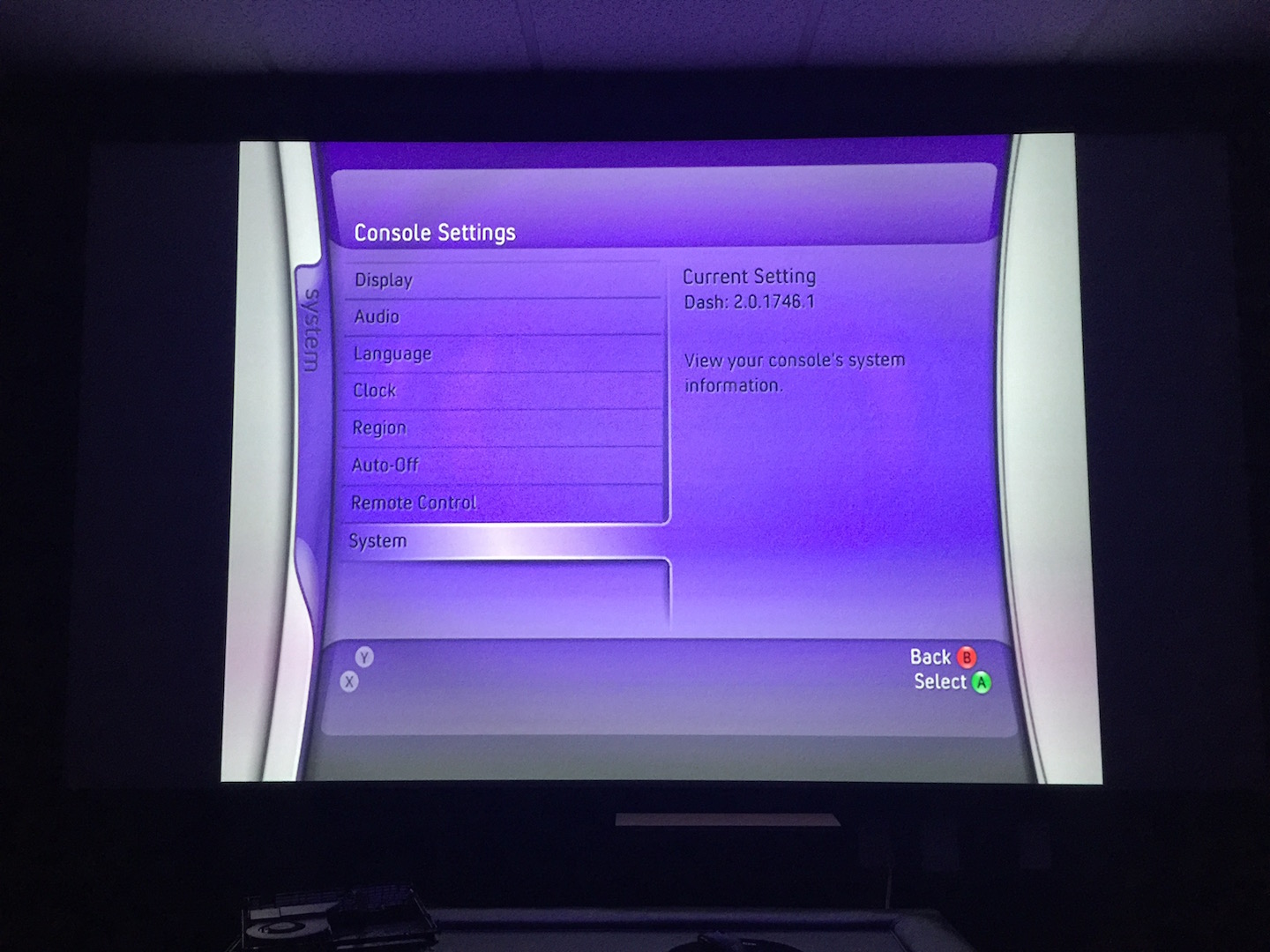

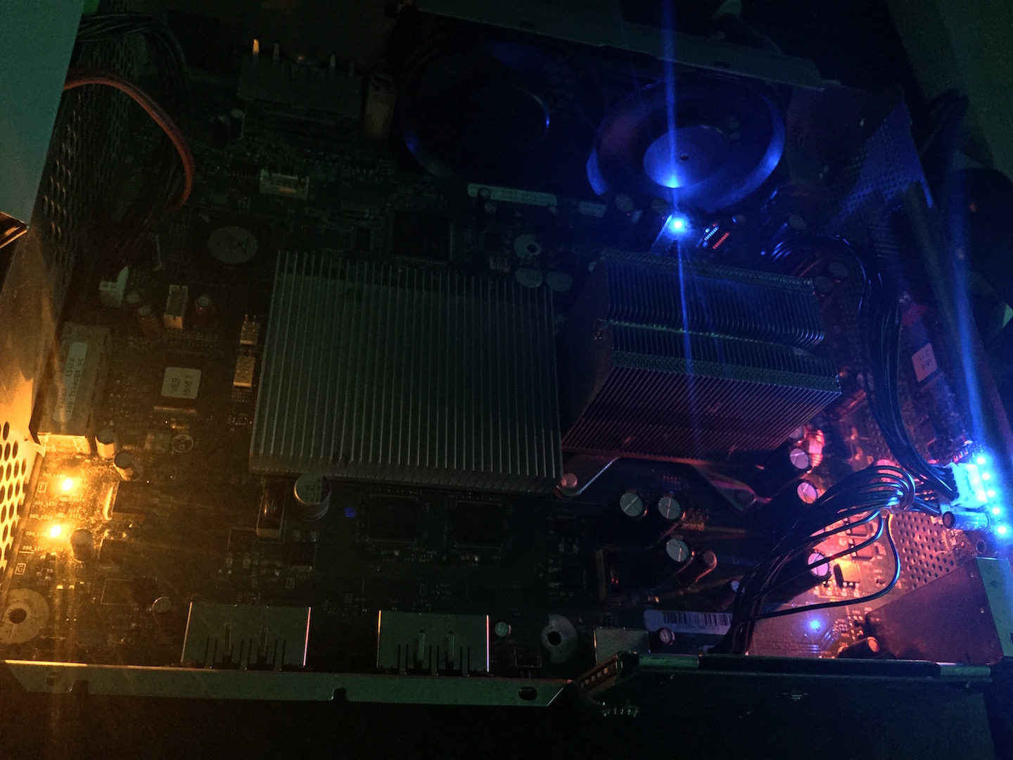

    Here are pics of the internals. When I bought the kit it had all of the front and back ports destroyed. I removed them all and put in new ones minus the ethernet/back USB (I cant remember why I left it out I have had this for at least 6 years now). I do definitely think its a beta one. However, I just plugged it in tonight for the first time in year and it booted right up but now will not boot again. When it did boot I checked the dash and believe it said 1738. I sort of remember it being finicky before so i might just need to let it sit for awhile. It doesnt have LEDs on the front so I cant tell if its red ringing. The sidecar cables are missing because when I got the unit they were all cut and missing the ends so I took them out.

    Wow Yep Beta 1, Unplug the cables from the motherboard and the titan board and plug them in very good and see if that gets it to turn on. I know when I was replacing Caps on mine that was the main issue that sometimes, they are not all the way in also my switchs on the titan board are down, down towards the Fan. Love the RF board as well:D

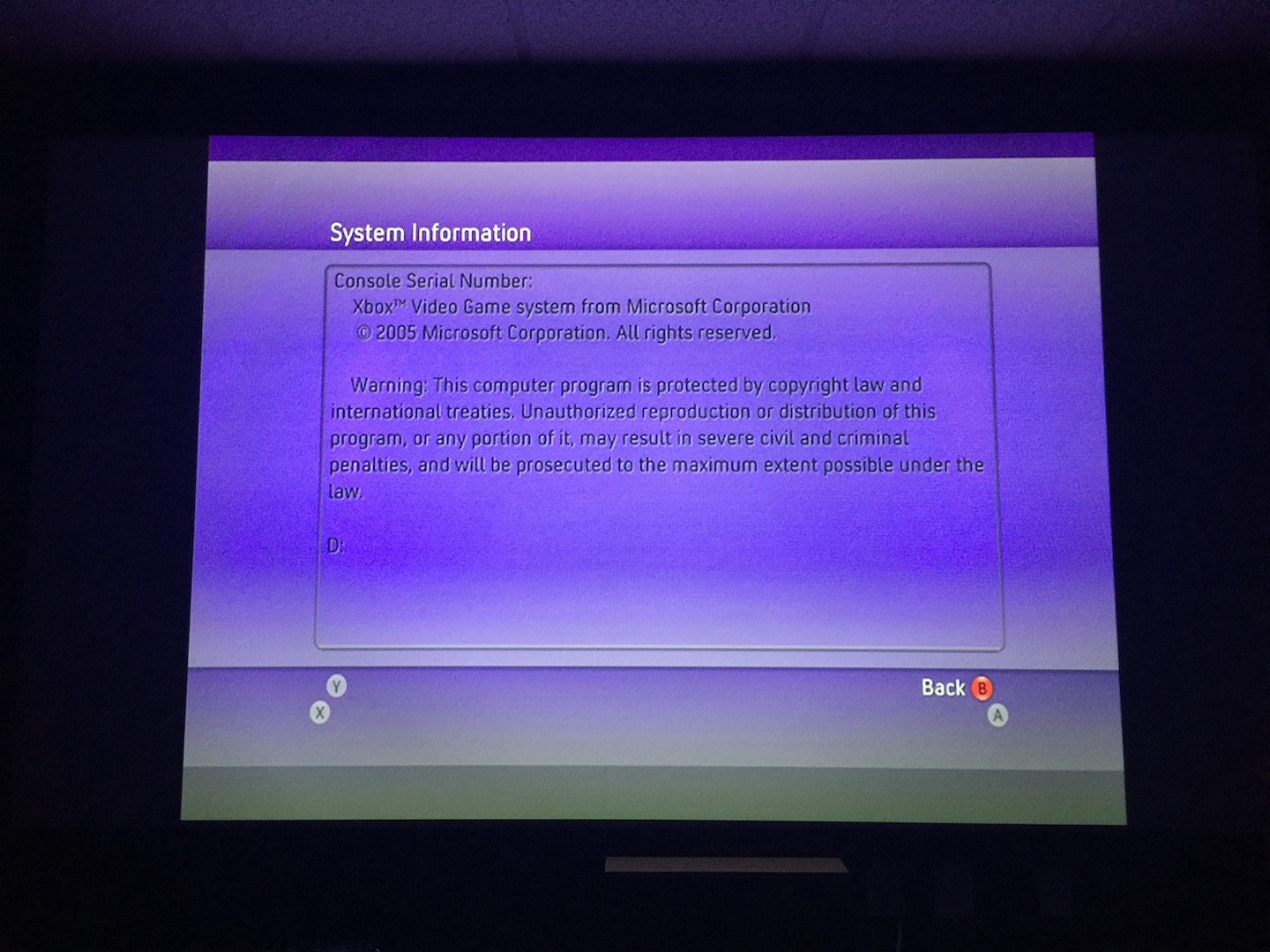

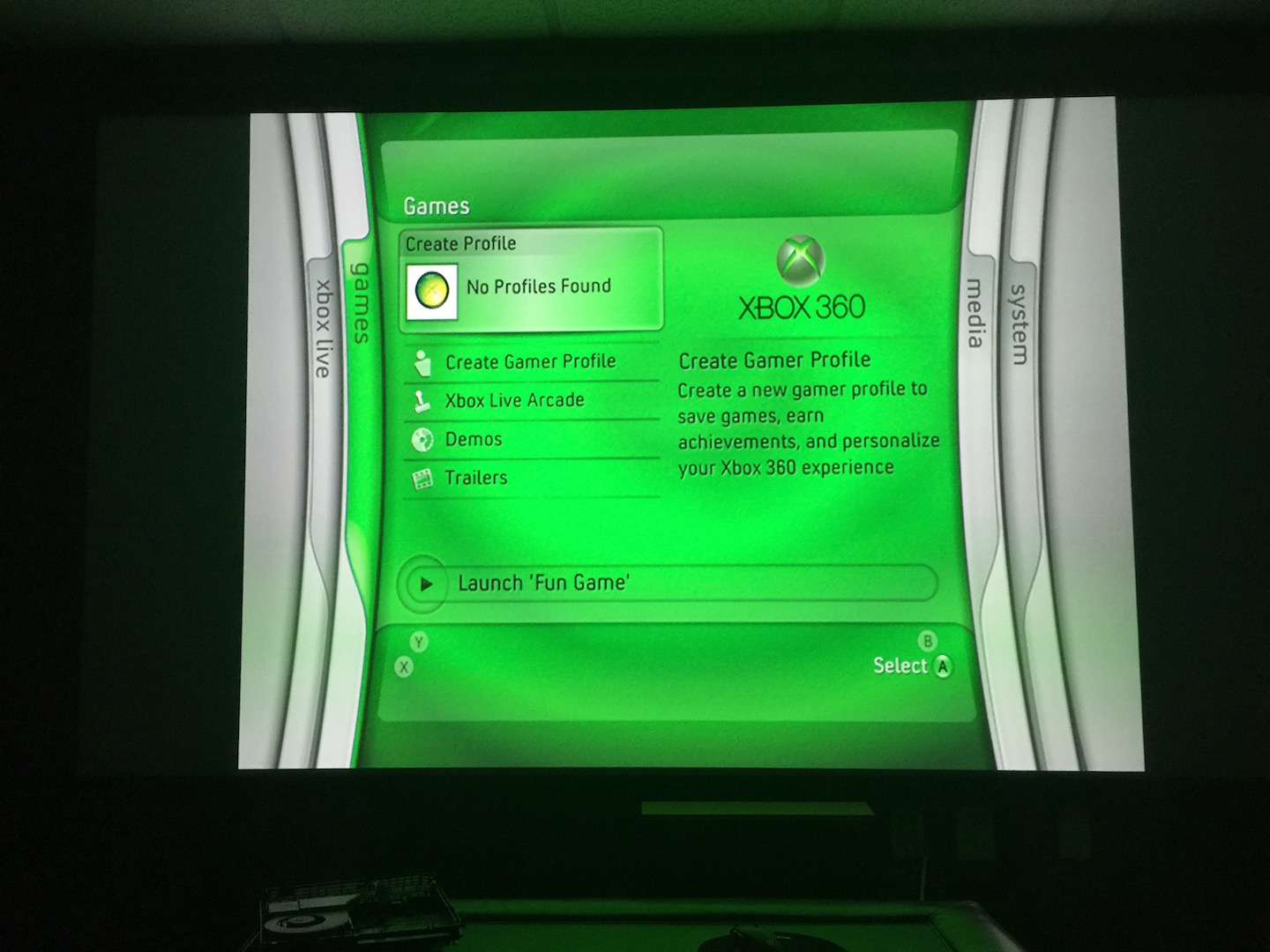

    Well I remembered why I didn't put the ethernet port in. Back when I fixed this unit up I was still inexperienced in repair and I had done a fair amount of damage to the board when replacing the power and av ports. The boards all burned up and slightly puffy where the ports are :(. On the bright side taking everything apart and putting it back together did get the console to start. I put in the recovery disk for 1888 and it comes up on the dashboard as 'Fun Game' but when you try and launch it the screen goes black for about 2 seconds and then it goes back to the dashboard again. IMG_3016.jpg IMG_3009.jpg IMG_3010.jpg IMG_3011.jpg

    1888 won't work on an xedk1... you'd need a different recovery which will be near impossible to find. Someone recovered it as a retail unit. Until you find something more beta than 1888, it will remain a retail flashed kit.
