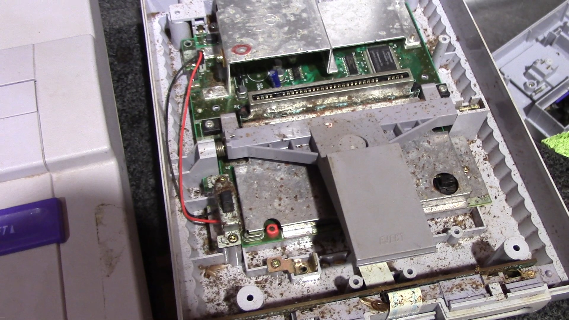

  14. smilecitrus
    smilecitrus Member
    Feb 6, 2014
    I actually like cleaning up roach-infested consoles. I sometimes buy them intentionally because most people don't like to deal with them. Usually the roaches are all dead, but every so often I'll get a system with one or two still alive. I'm a bit of a germophobe, so cleaning these things up is a bit like exposure therapy for me :)
    [​IMG][​IMG]

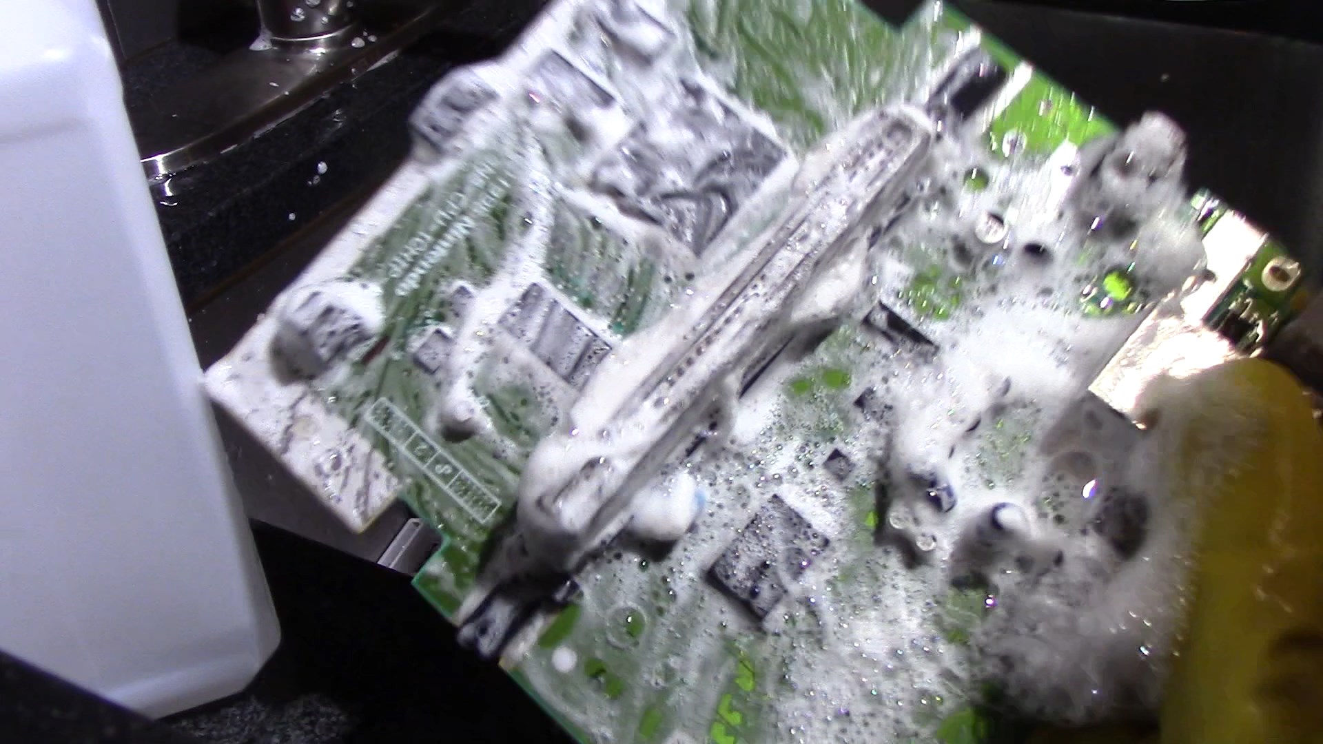

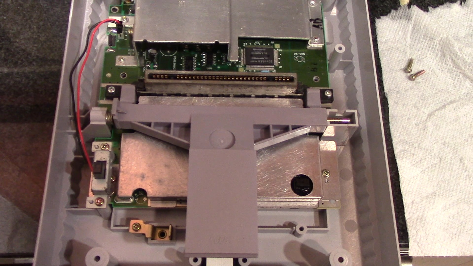

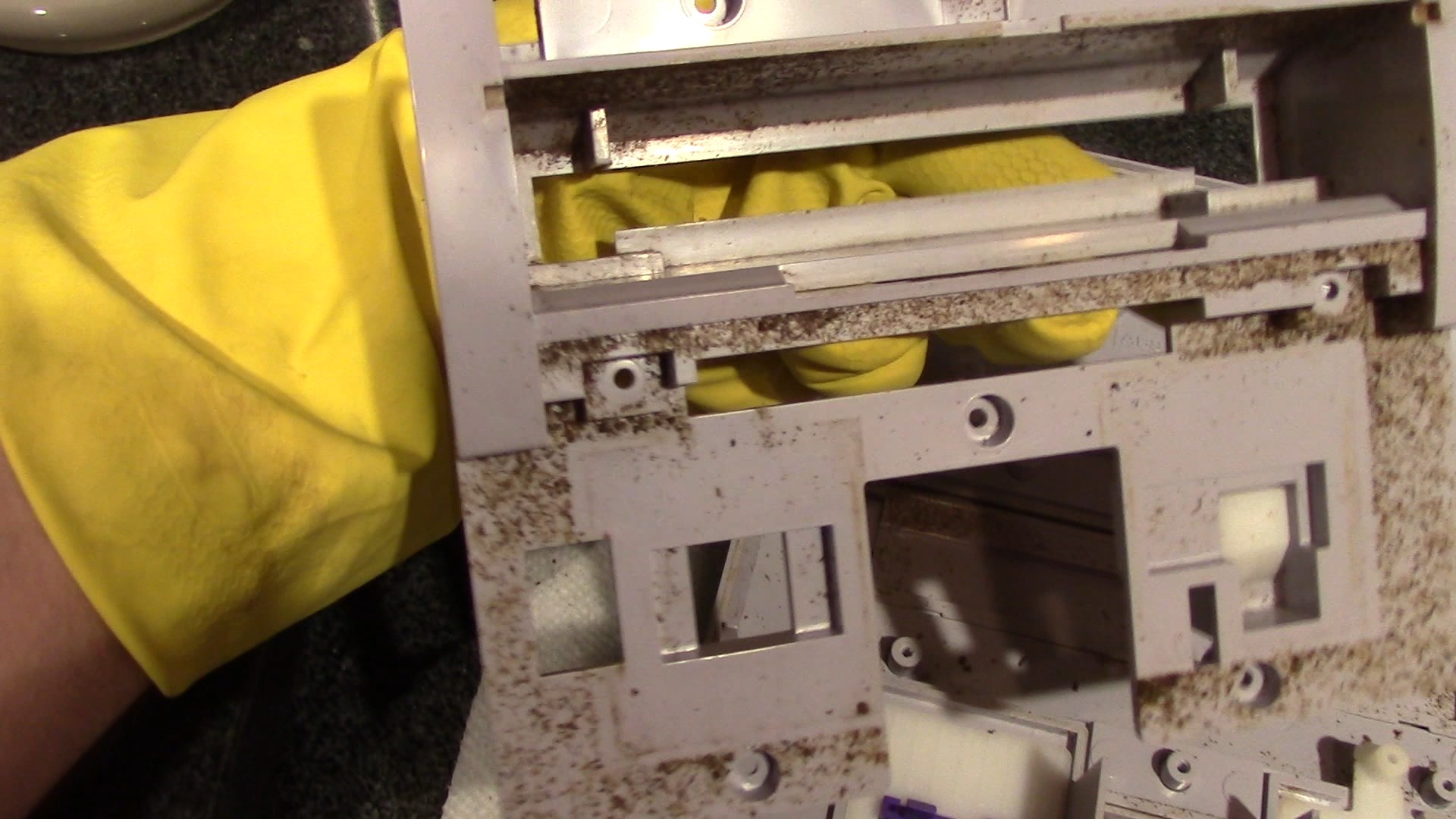

    Everything gets washed. You have no choice with these but to scrub every single little tiny piece. I use an antibacterial dishwashing soap. I even dump all the screws in a cheap ultrasonic parts washer I have to clean the roach poop off them. The entire PCB gets washed in antibacterial dishwashing soap under hot water. I use a big grout brush to scrub off the large bits of filth and then switch to a toothbrush to get into the difficult to reach places. I use an orbital sander to sand away rust and roach poop from any heatsinks or RF shielding.
    [​IMG] [​IMG]
    If you wash everything thoroughly you can usually eliminate the smell entirely. But you do have to actually wash the PCB. A safer way might be to fill a large sonic washer with alcohol and wash the board in that. But in addition to not having one big enough to fit most boards, my view is that if the console is broken already there's no reason not to wash it with a nice lemon or lime scented antibacterial soap. The worst that could happen is that it'll still be broken after it dries.
