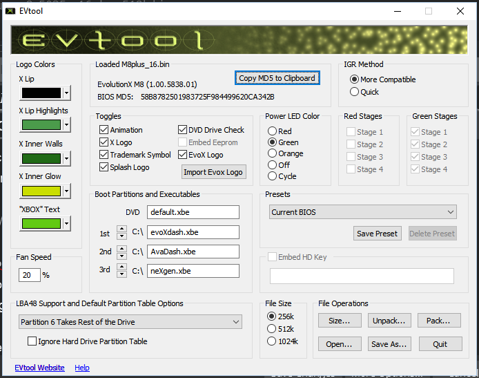

    You could use NghtShd's EVtool 1.0.9 to patch/mod the IGR and LBA48 support in your current M8plus_16.bin file that was flashed to your Aladdin XT 2 plus. There are a lot of other options that EVtool can customize too.
    http://www.realmodscene.com/xbins/XBOX/PC Based Applications/bios tools/EVtool/
    EVTool shows me that M8plus_16.bin has LBA48 support and IGR enabled.
    IGR - more compatible instead of Quick
    LBA48 - Partition 6 Takes Rest of the Drive
