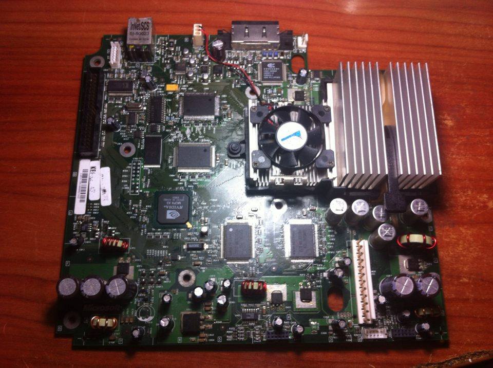

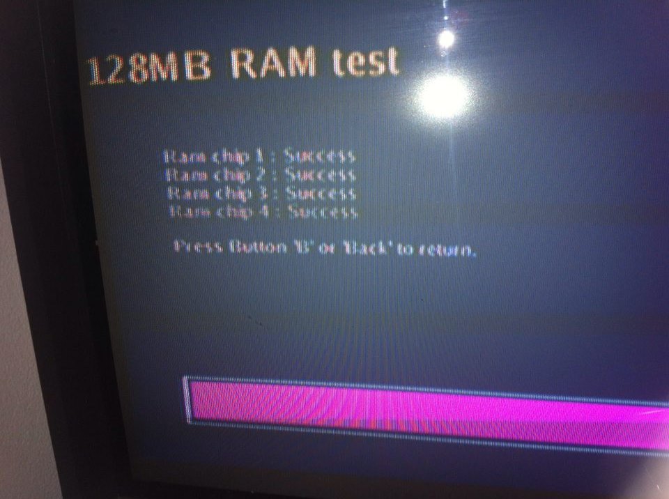

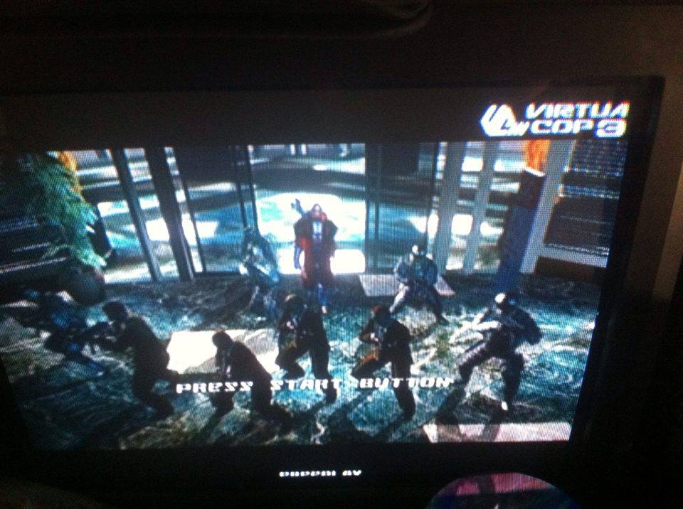

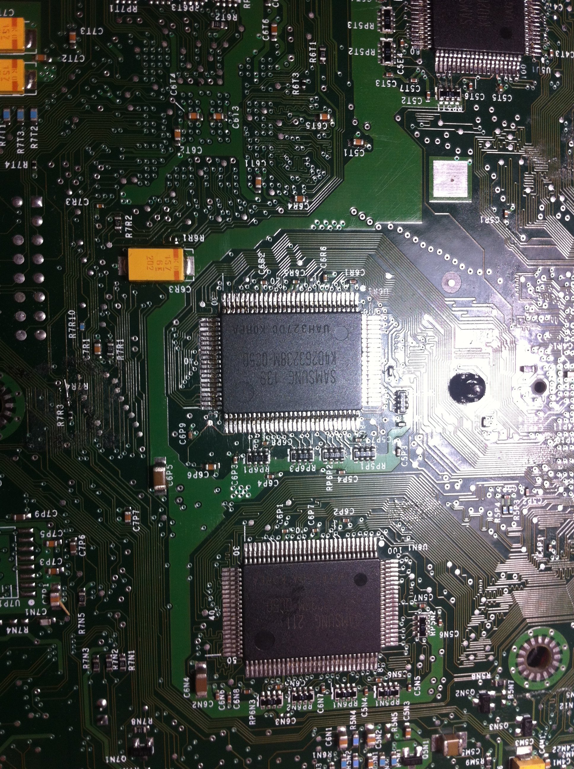

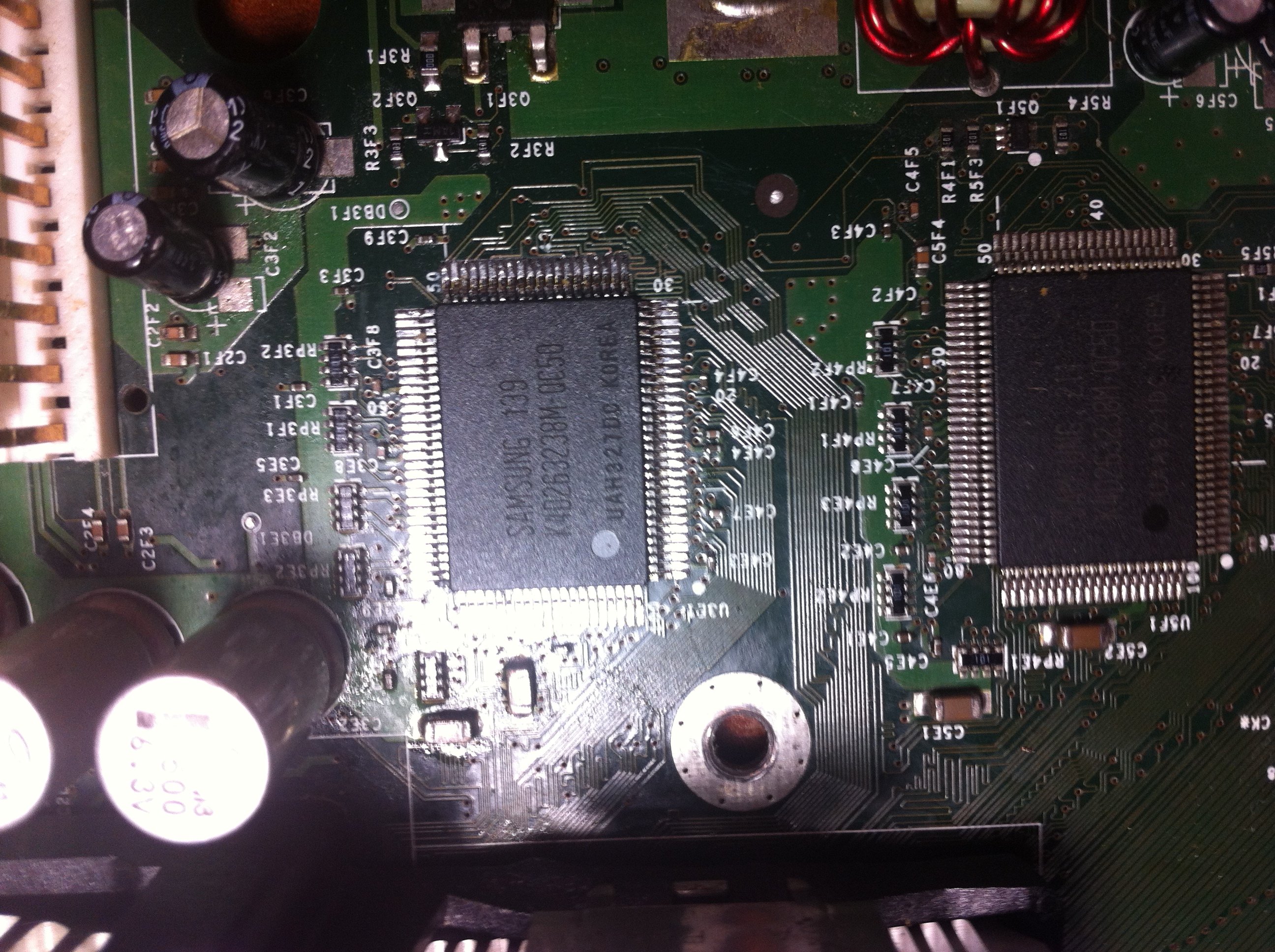

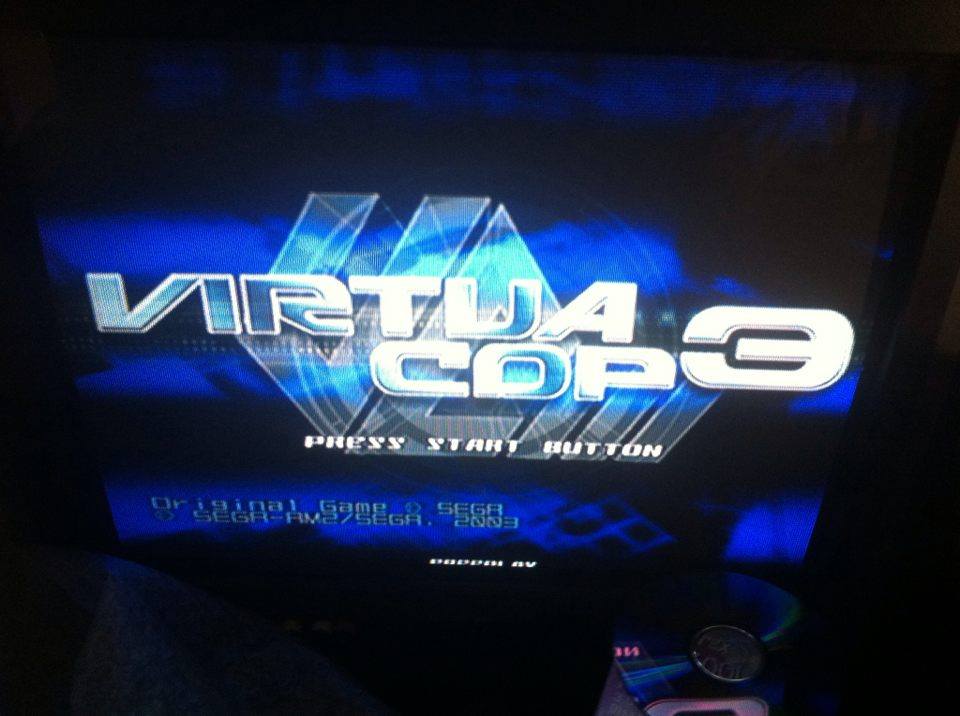

    Hello everyone was recently working on this xbox v1.0 128MB RAM installed successfully using the bios BIOS 5004.67 IND-BIOS beta greetings some pictures .

    P.S. Ram test program? Where can I get it? I already tested my v1.4 to work with Chihiro games, but it is interesting to test this program.

    did you salvage the ram or buy new-ish chips online (ie: aliexpress/ebay)
  5. dark ricardo
    dark ricardo Active Member
    Oct 9, 2011
    39
    Hello the rams were removed from a dead Xbox 1.6, using a hot air gun, then after flashing the bios xecuter 5035 for 1.0-1.1 xbox to the tsop but if you console is version 1.2-1.5 i recomend use ind-bios 5003 or ind-bios 5004 beta .67 only, just use flux for the installation of the rams on the Xbox v1.0 make sure of the alignment circles,small circles on the ram chip goes with small white points on the motherboard aligment is very important on this operation i use a 15 watts soldering iron from radioshack and a recomendation before installing the ram remove clean the motherboard with alcohol 100 clean the rams pads( use desoldering braid to remove excess of solder in the pads) where the ram goes, carefully apply flux to the pads after installing solder the first ram conect the motherboard to the psu in the case and test(this must be done everytime a ram chip is installed) light code must be red orange,not red green,red and green light code means there is a solder bridge in one of the legs of the ram must e fixed before proceed,when you solder the last ram number 4 clean all flux residue on the motherboard let it dry and conect the motherboard must boot to the bios etc.complete tutolrial here
