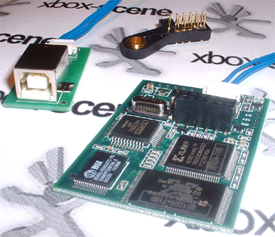

    I've had my original xbox sitting in my backroom for some time; it was the console I used in college etc. Its been modified with a x-chip that looks something like this:
    I recently pulled it out for some nostalgia and at the same time decided to upgrade the hard drive. I did some research and found a nice tutorial here: http://www.xbmc4xbox.org.uk/forum/viewtopic.php?f=14&t=649 In the tutorial he recommends a disc called Auto-Installer Deluxe or slayers evo x. I got both of these discs (newest versions), an sata hd adapter and a 2tb hard drive. Now for the fun part!
    Upon booting, I hop into the evolution dashboard and throw on some spiderman 2, just to check things out. Everything seems great. I get the new hard drive connected and throw in the AID disc.. I can't get this disc to boot, seems like its having a little trouble reading. I try the slayer disc next; it boots! but doesn't do shit. When trying to format the hard drive it acts like its doing something but this procedure is done in less then 10 secs. And the partition information doesn't show anything after its completed. So I jump online and start researching large hard drive xbox's... After reading it could be the bios. The bios that was originally installed on the x-xhip is an evo m7.. Not knowing much about bios's for xboxs I got the newest evo bios. Which is evo m8+. I threw that on with no problems. But slayers disc still does the same thing. Now I'm coming here looking for help.
