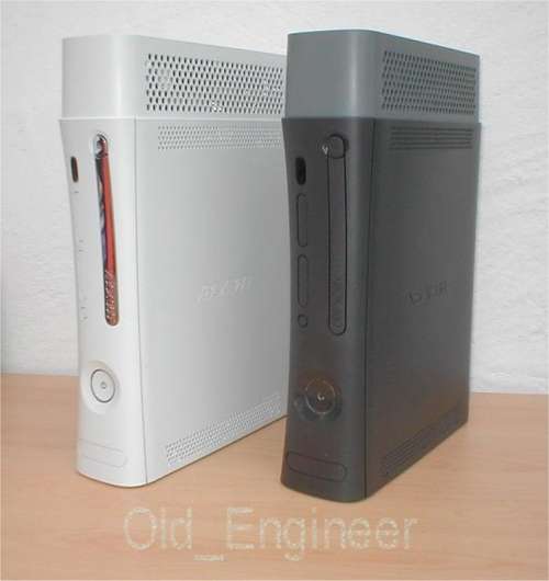

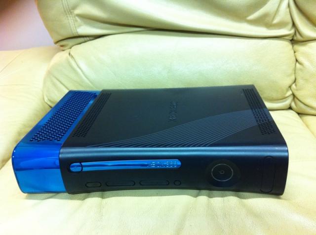

    hey, i currently have a xbox 360 slim thats rghed and a xbox 360 retail. its the big block jasper and i was thinking about rjatagging or rghing the xbox and installing team xecuter fusion and makeing the xbox look dev kit esque and have a functional sidecar.
    how i plan to do this is to mod the top panel of the xbox to have the shape of a sidecar and i can put a 1tb hard drive inside along with a xkey360, essentially makeing it a fuly functional hard drive with dvd drive emulation. i wanted to paint it to look like a black and blue xna or just a white xbox dev kit

    im doing this because i cant afford an actual xna, and it would be a cool project to have a homebrew xna. i have soldering skill and experience spray painting

    As for the side car I have no experience with moulding plastics, shaping plastics etc I would probably look into making it with a sheet of aluminium, for me I would imagine it would be easier to shape and play around with to get it looking exact plus with a transparent blue paint you get a chrome-ish looking finish better than any chrome spray paints I've ever used anyways, the cap is always so misleading, either that or I'm crap at spray painting I hope it's not the second choice :p
