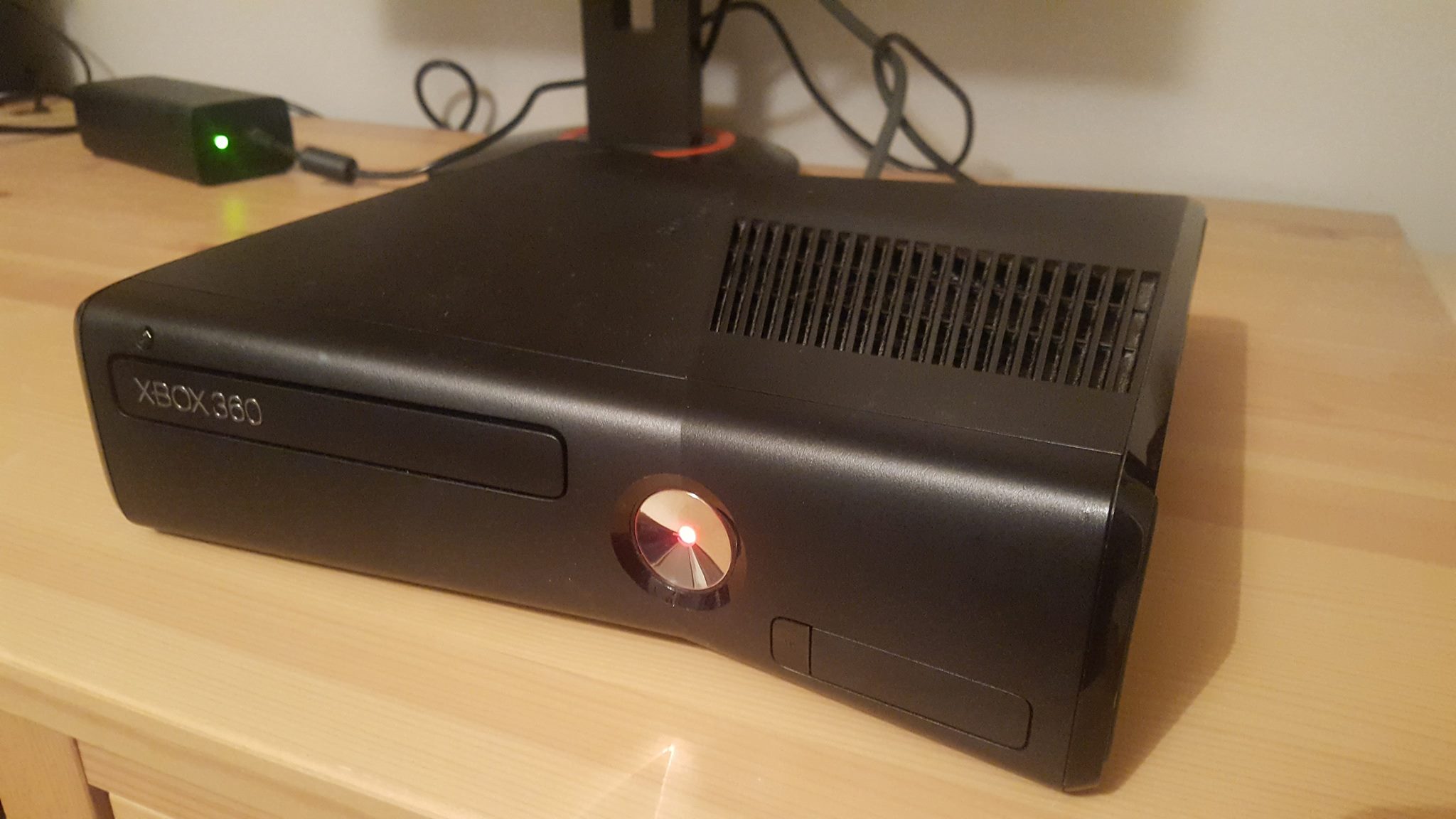

    It's a 360 S XDK, manufactured in 2011 according to the info on the back. Here's a photo of it with the red light - as you can see in the background, the light on the power brick is green.
    I turned it on to take this photo, and then I turned it off ready to try to steps you suggested - the moment I turned it back on though, it started working again.
    Based on what I've already seen, I know this is only temporary and it will stop working again. I want to try the steps you suggested to diagnose the problem, but right now I can't get the red light to come back... I suspect if I leave it a few hours and then try again, it will be red.
    In answer to the question about it turning on - yes, it seems to turn on consecutively after you have been using it for a little while. This is the second time I've got it to start turning on consistently, but it's never just started up with a green light, it's always red at least once first (last time it was red 5 or 6 attempts before it started to work).
