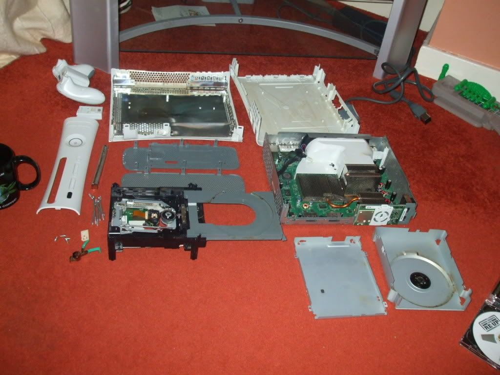

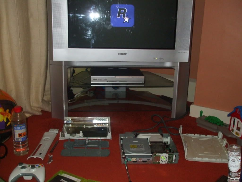

    224
    Well as the warranty was up i decided to take the sucker apart and see what could be done.
    Being a complete novice at this i really wasn't expecting much (last console i opened up was my NES about 15 years ago). so once its open i turned the DVD pot a few mm and connected the drive back up.
    Lo and behold it worked first time:dance: , after testing a few different discs i put the case back on in a bit of a hurry forgeting the DVD drive button:110:
    another 5 mins and i was all fixed up and ready to go :nod:
    Moral of the story: If the warranty is up give it a bash, Even if you're a complete novice like me. There's loads of guides on the internet and even if it doesn't work where does it leave you? Back at square one with a broken Xbox, so whats to lose? :thumbsup:
