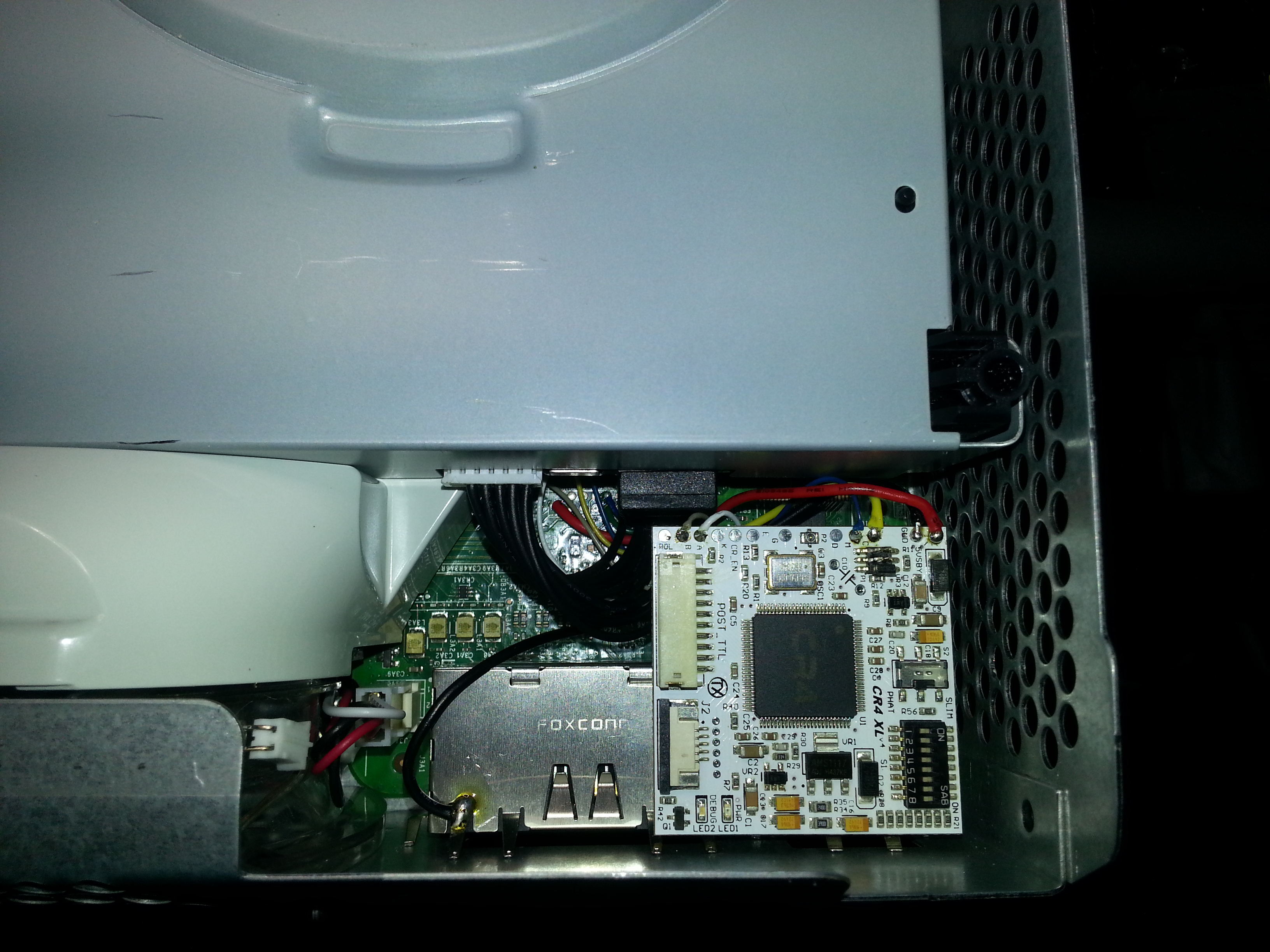

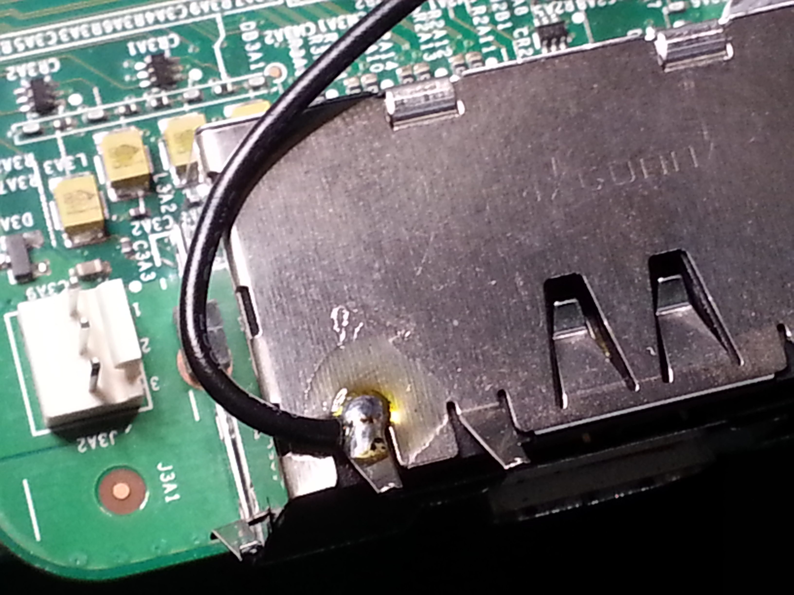

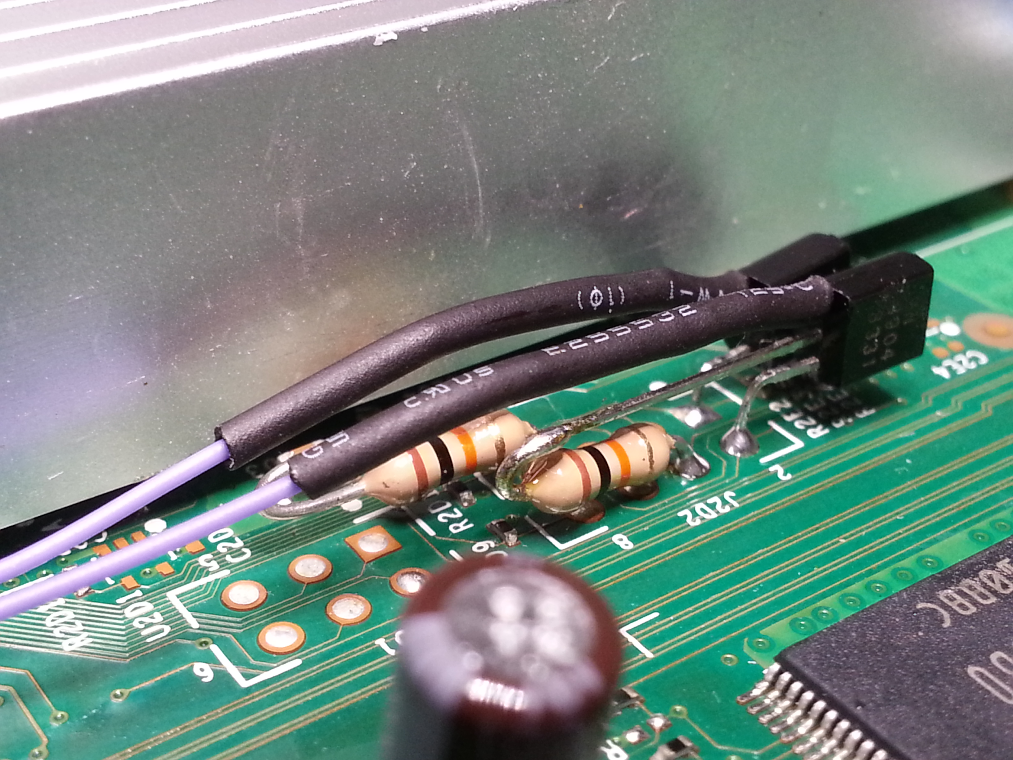

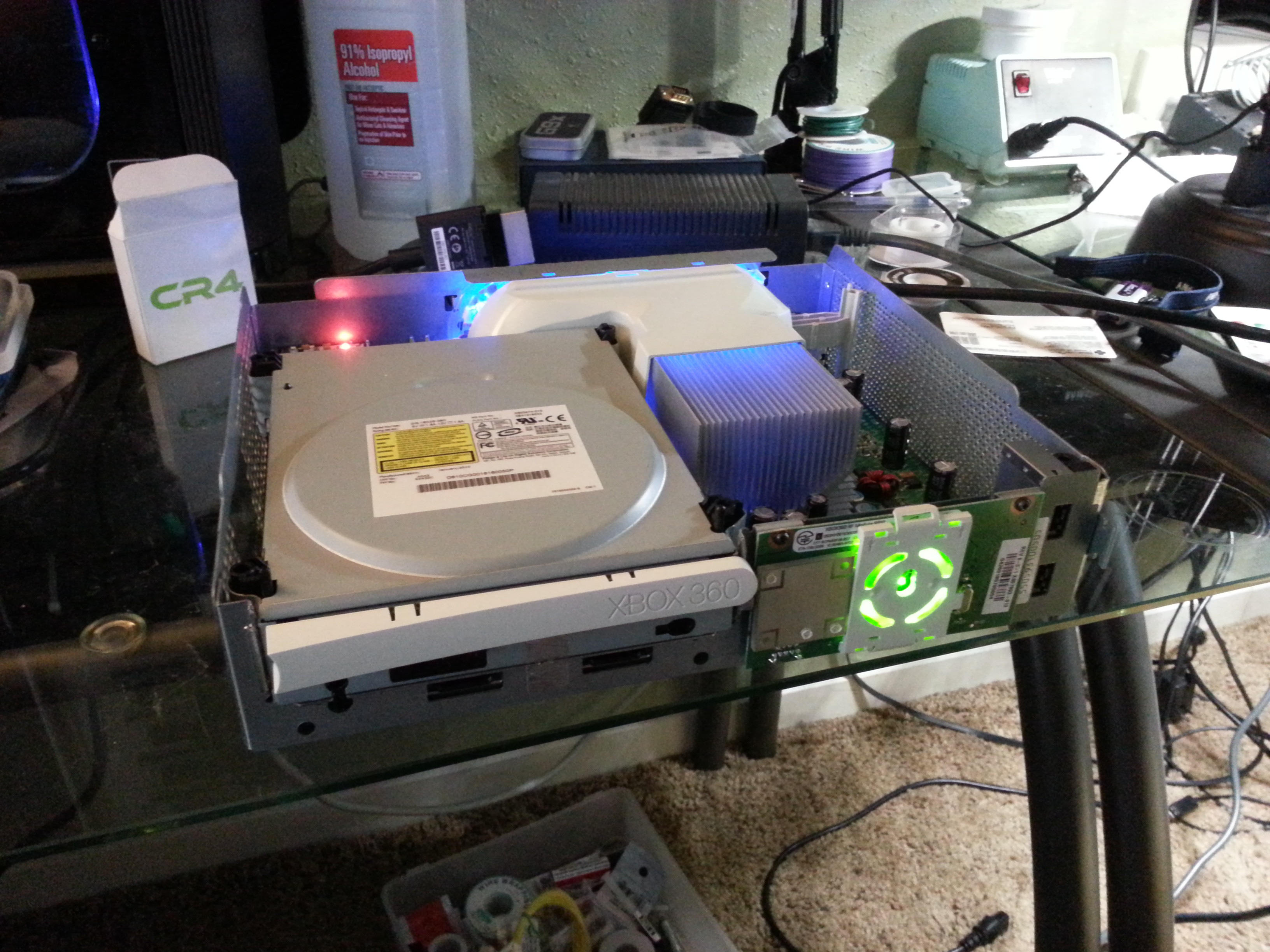

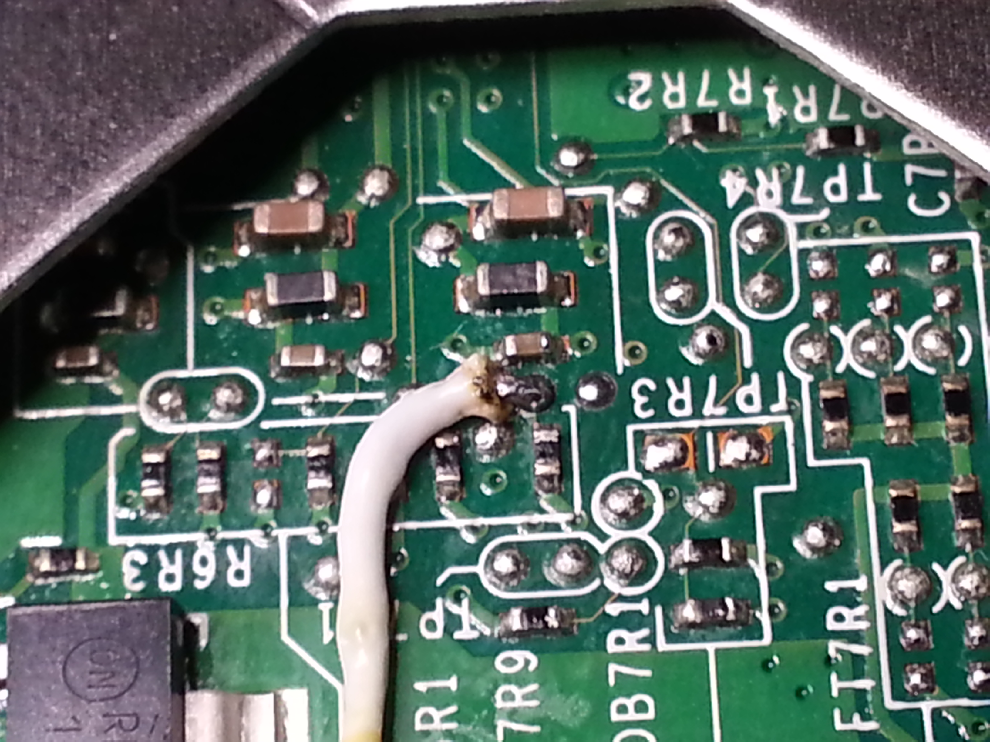

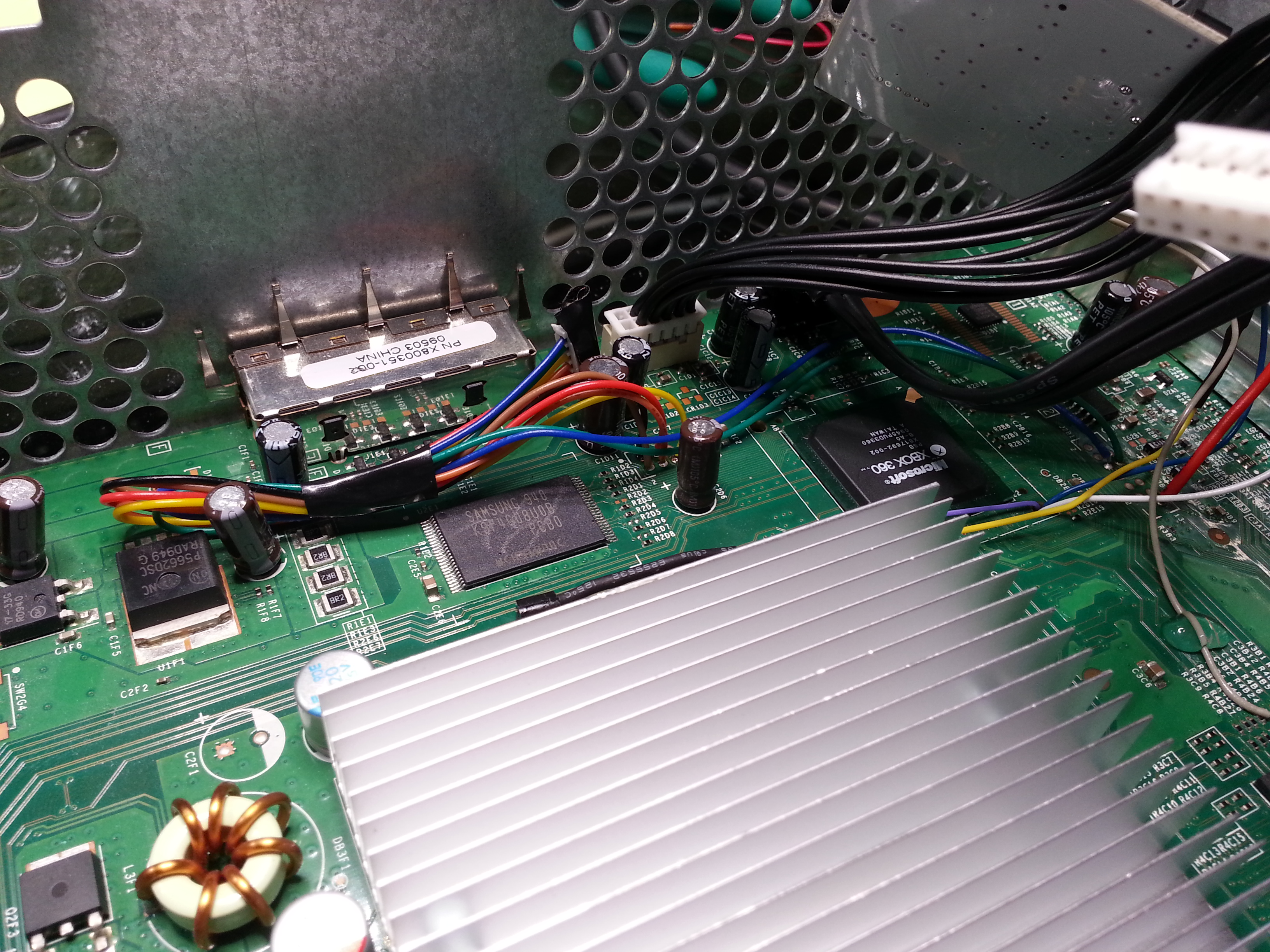

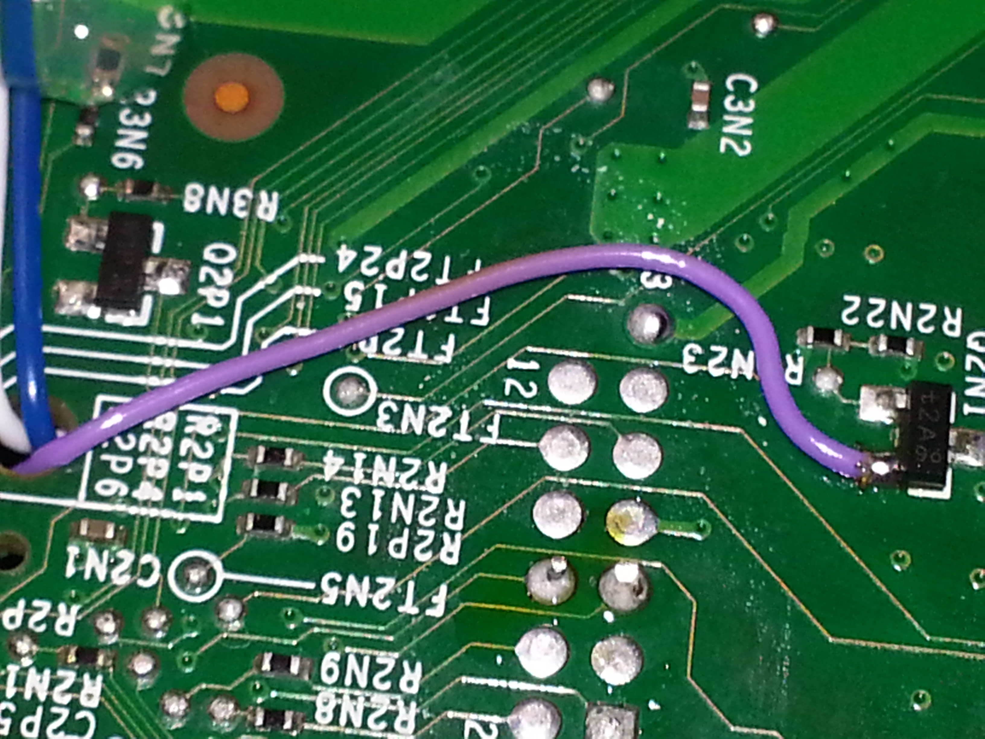

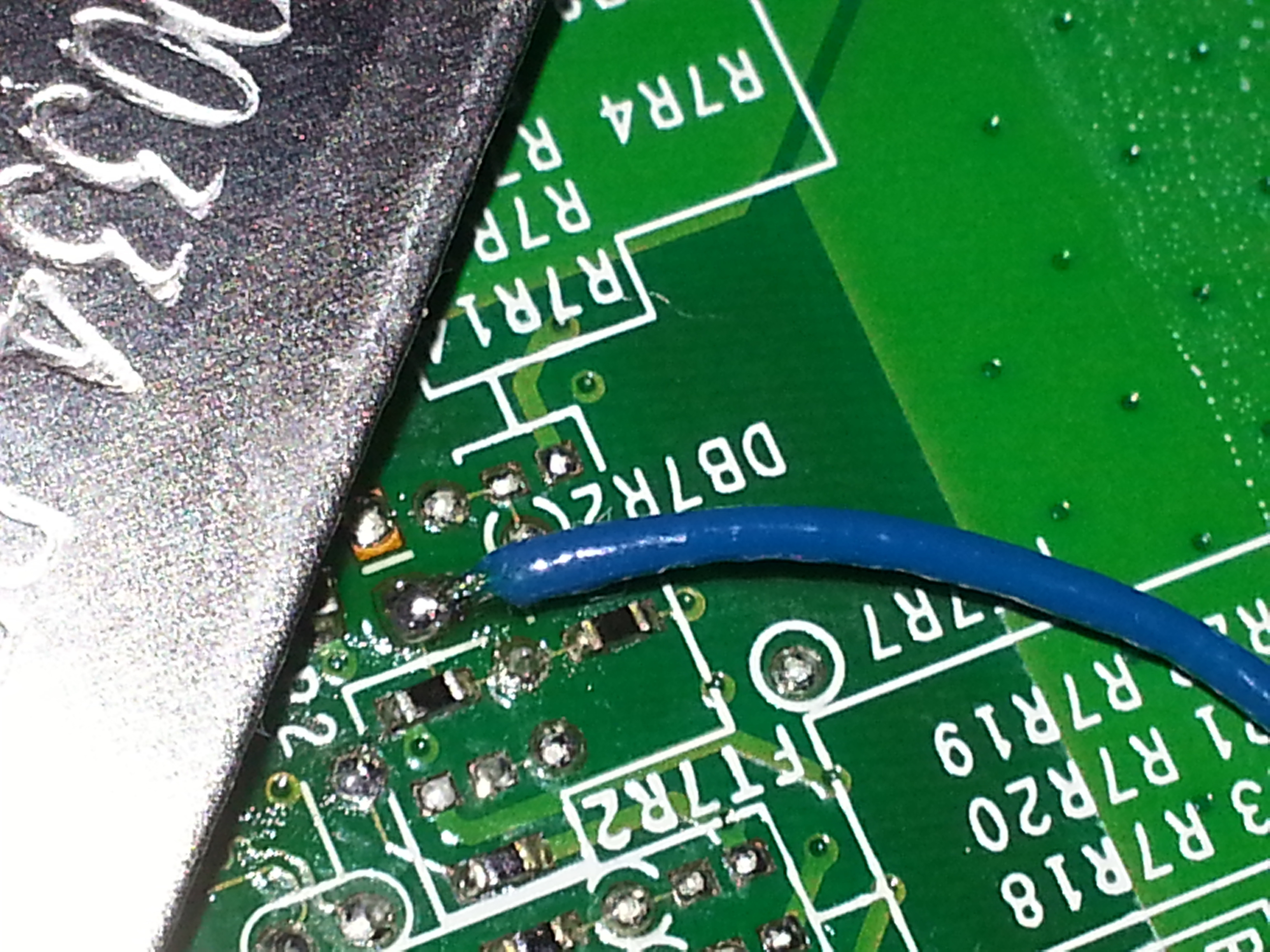

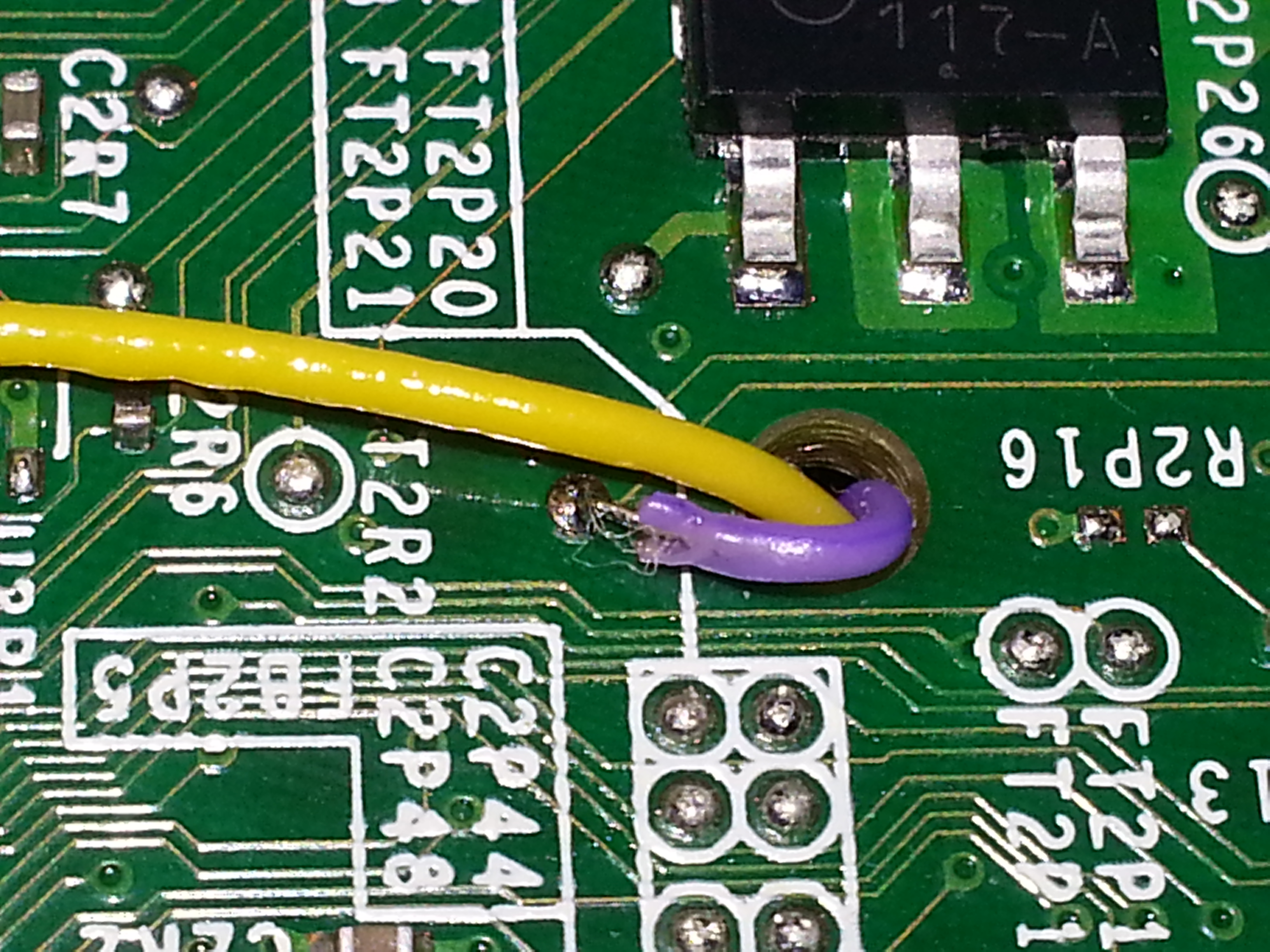

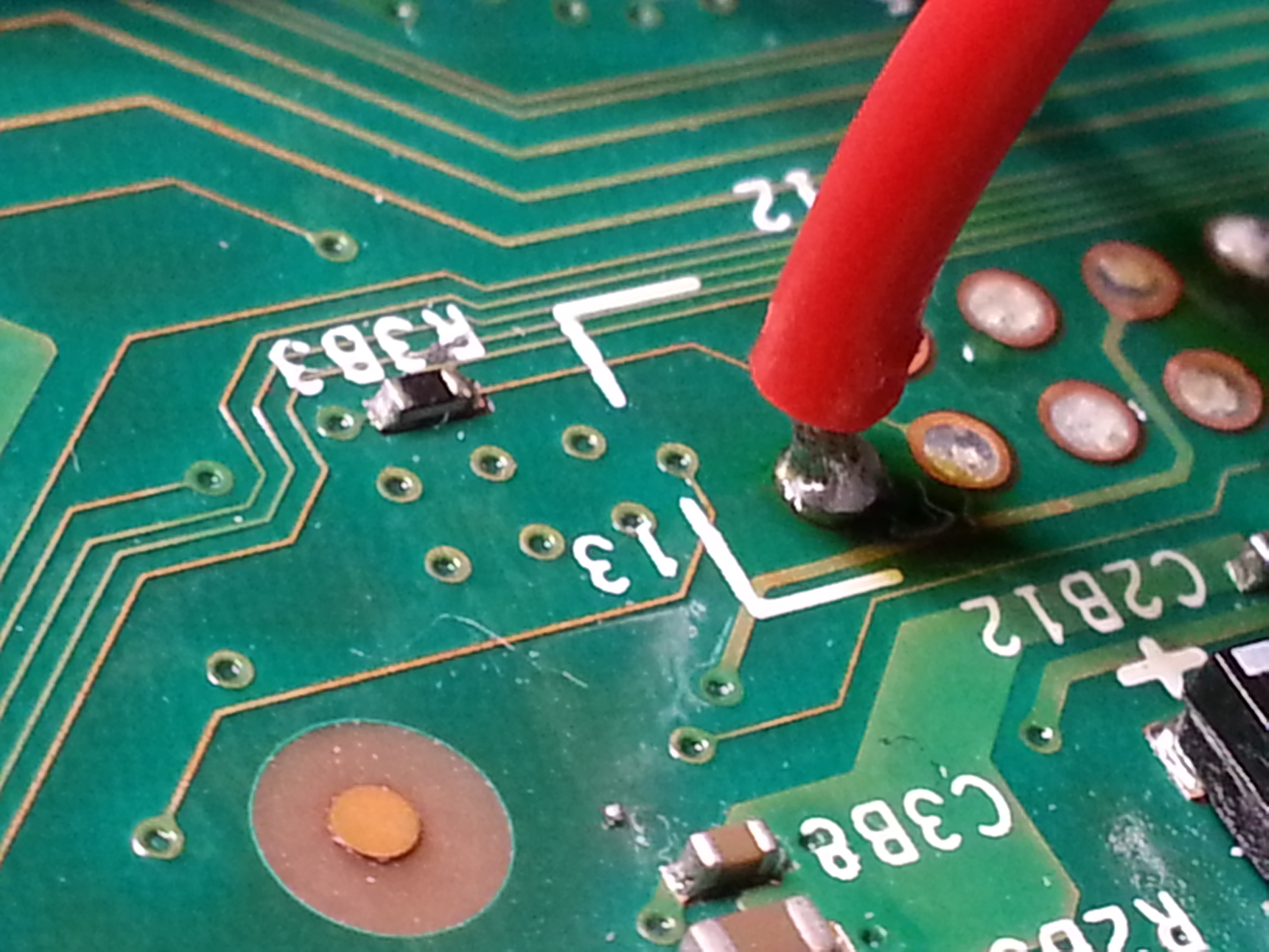

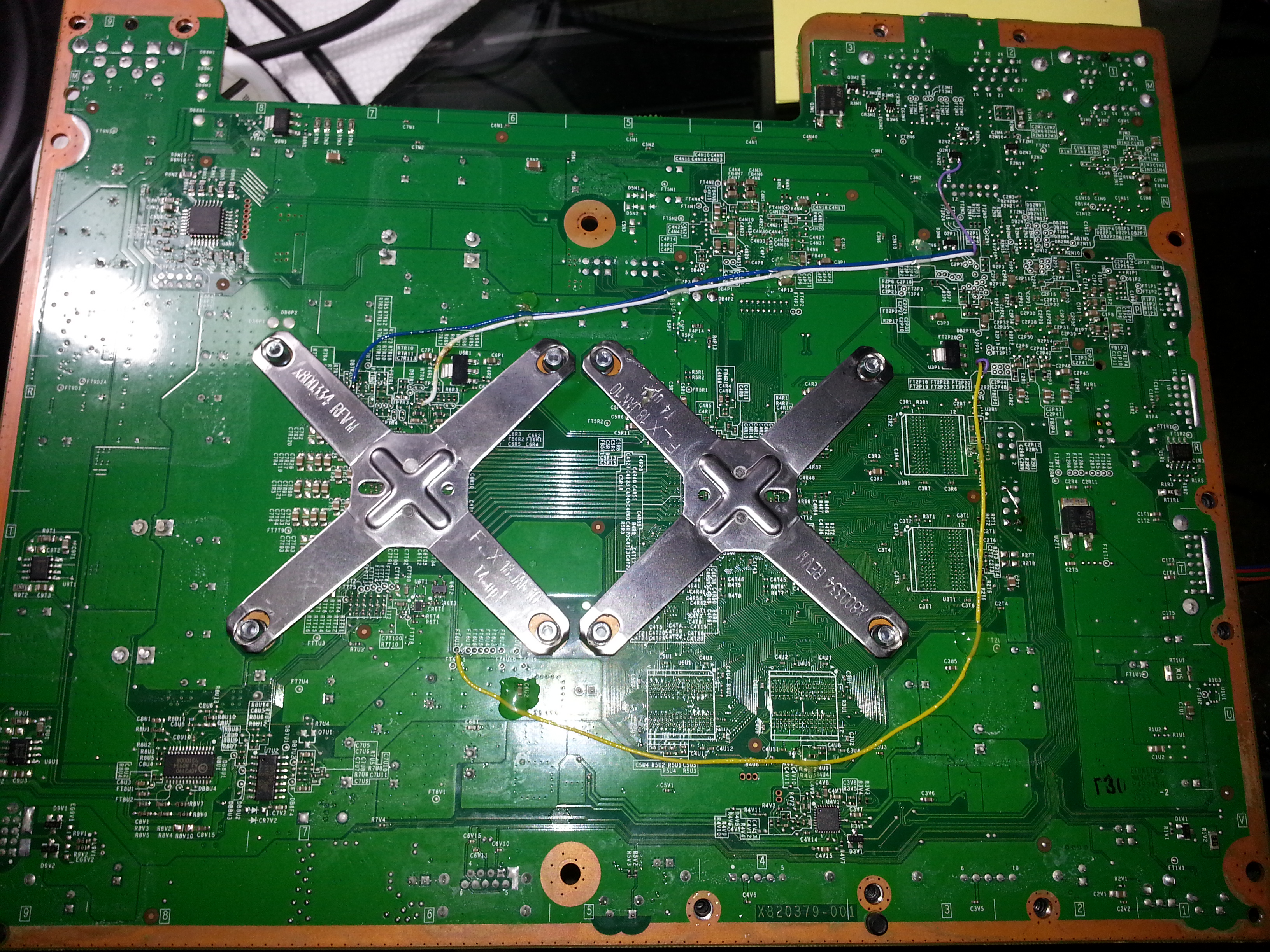

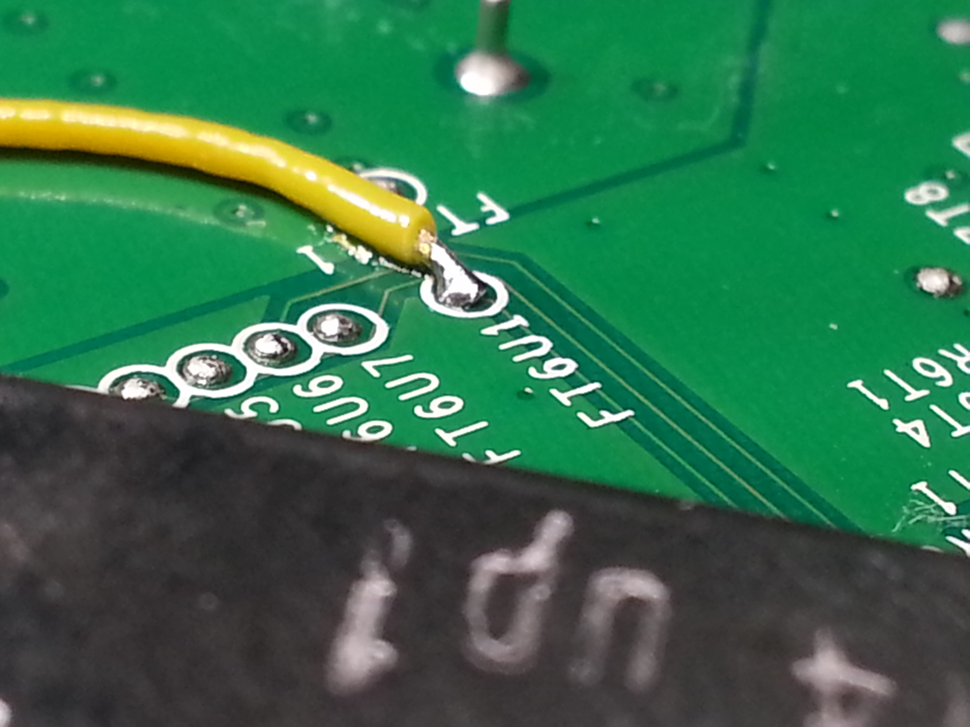

    Thought I would give this thread a good success story. A year later, but I finally managed to make time to finish an R-JTAG with a CR4 on a Jasper, over the holiday break.
    In a world where QSB's do not seem available anymore, I did direct wire and BoXXDr's design for the JTAG connections. I have not tried any tuning or shielded wire for the CPU_RST. It will boot sometimes instantly, sometimes several glitches. Usually 2-4 glitches seems the norm. I have not tried looking into how to tune it further.
    Thank you for all of the volunteered information, opinions, and personal experience. (feel free to continue :D )
    Here are some pics. Criticism and suggestions certainly are welcomed.
    Glitched
    BoXXDr JTAG design
    Zeigren likes this.

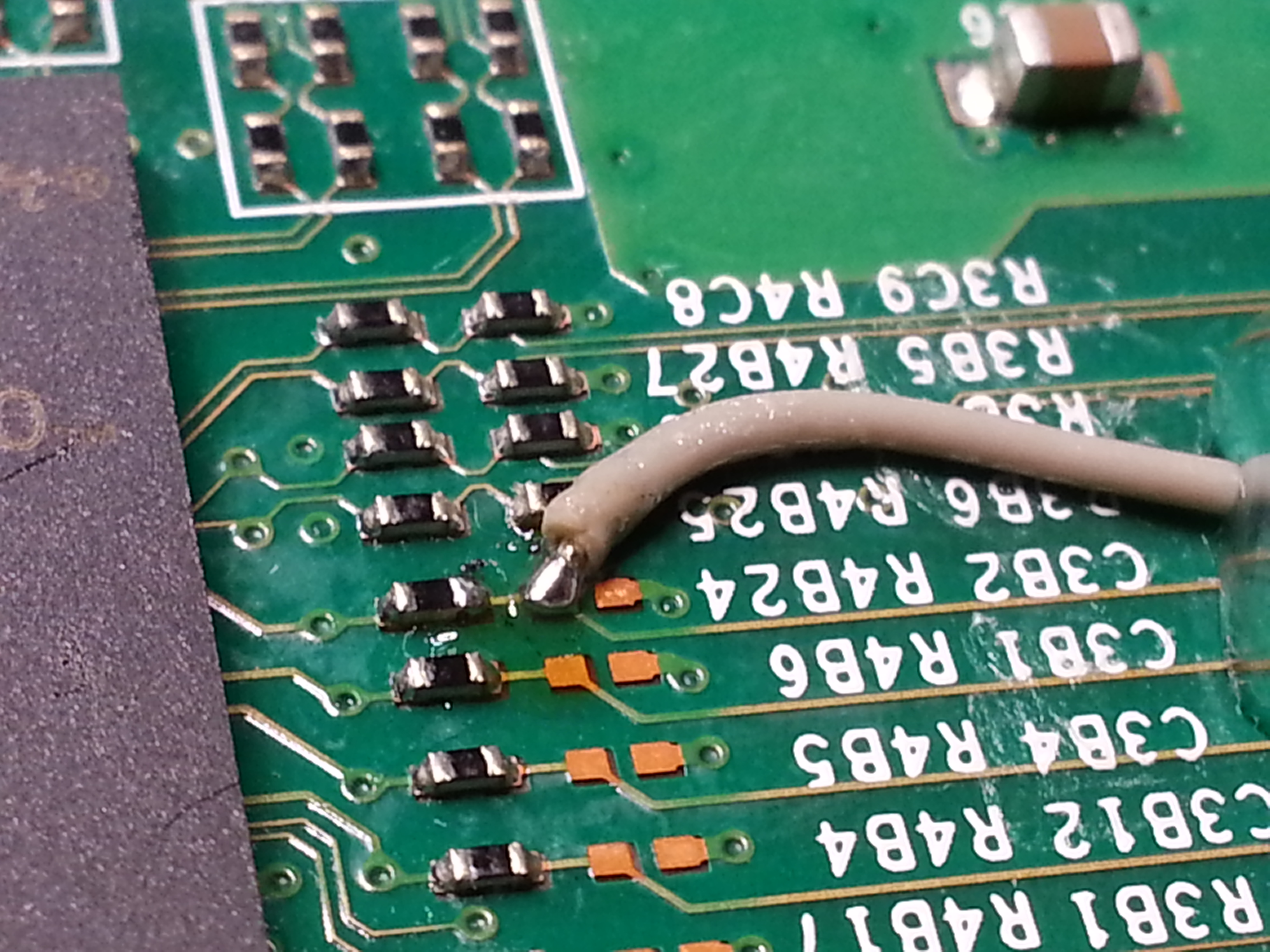

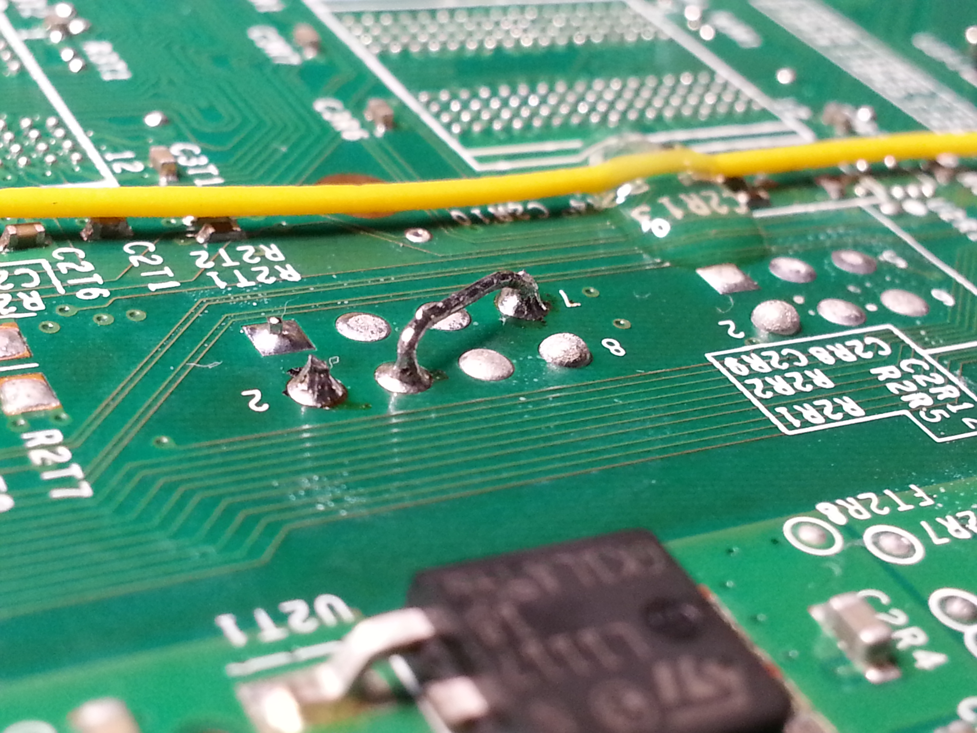

  20. kreg
    kreg Spirited Member
    Feb 22, 2009
    132
    Bottom side
    Top side
    Decided to leave the NAND cable in place for the J-Runner V2 Programmer. (Since I don't have any QSB's for it either.)
    This seemed like a good place for final placement.
    Zeigren and Taijigamer2 like this.
