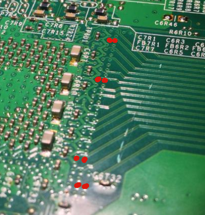

Xbox 360 Mother board trace tiny scratch

    Thats totally fixable by the right person.
  3. Riki
    Riki Peppy Member
    Sep 2, 2013
    313
    By looking at photo you can see where trace ends. It should be easy to solder there. What's with other side?
    The only problem that traces maybe should be the same length, but it does not look to be the case.

  5. Riki
    Riki Peppy Member
    Sep 2, 2013
    313
    Did you remove lacquer (green layer)? Scratch it (maybe there is a better way to remove it, I do not know, maybe it's dangerous to scratch), apply flux and soldering alloy. I also recommend cover smd parts around the area with paper tape so you won't damage them accidentally with soldering iron.

  7. Riki
    Riki Peppy Member
    Sep 2, 2013
    313
    Scratching never failed me yet but I did not try on such small area. Better try to find other methods to remove it before trying to scratch it.
  8. LeHaM
    LeHaM Site Soldier
    May 5, 2013
    2,634
    292
    Some über fine sandpaper will work too
  9. Cygnos360
    Cygnos360 Member
    Jun 20, 2011
    You can use a fiber glass pen. When you checked the traces and everything is fine you should send this console to a guy which can reball the GPU for you. 0110 is a communication error between GPU and RAM. Hot Air fixes never last long because the solder not getting melted. The board flexes and this is why these Hot Air fixes last a couple days.
    Edit: If nothing works someone can swap the cpu and nand and bring the resistor near the nand in the right position. I did that on an Xenon and it worked.
