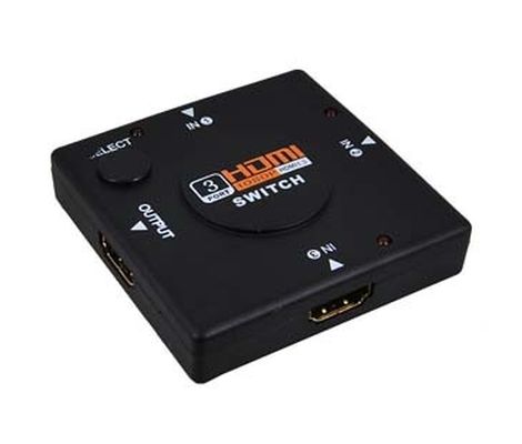

    Today i bought a 3 way power HDMI switch, like this one...
    As i have 2 hdmi cables i use on my xbox 360 (1 for capturing and 1 for normal play), anyway the device appeared not to work no lights on the device and no picture on my LCD, so i unplug the device and plugged my hdmi cable coming from my Sony STR_DH800 AV amp back into the Xbox 360 but i still wasn't getting a picture on the LCD, then the feeling of dreed starting to come over me as i guessed that the 3 port hdmi switch might have blown something.

    I have that exact switcher and it works perfectly. My TV only has 2 HDMI - so Sat box is in HDMI 1 and media PC and xbox into HDMI 2 via that switcher box. The automatic switching is great - turn xbox on and it switches to xbox. Turn it off and its back on media pc

    Well I'm guessing it must have been faulty as none of the LEDs came on when I turned the Xbox on, but that's the least oft problems I just want to know why the 360 now appears not to work through the amp but it does through the tv
