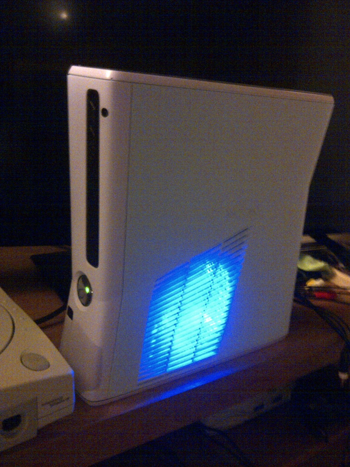

    If you think you can simply paint your matte black 360 slim white, think again. The case panels turned out baby blue, which is actually kind of cool, but the trim pieces and the faceplate came out pink....

    Does it still look like that with the system (and the blue fan) off?

    Yes, The side panels are like a baby maybe light powder blue color always. I installed a blue LED fan, so I like the side panels. Hell, the light pink front and trim look aright too, but I don't like the way it matches with the blue.

    No, I didn't prime it because i used Vinyl Dye and not regular spray paint. I basically used an entire can of spray vinyl dye. Layer after layer, but the colors still bled through. It's growing on me and I think I like it now. It's like a pastel colored xbox 360.
