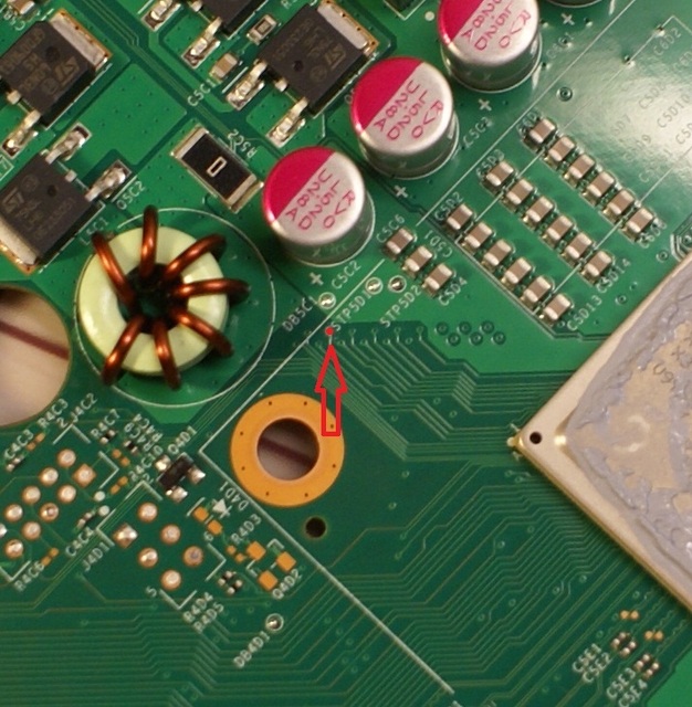

    Hi there you guys!
    Today I started to mod one of my Xbox 360's, with a X360ACE V3 chip.
    Having installed this chip before in a other slim, I was pretty confident that I could get it done.
    However I have only met trouble since I started.
    I succesfully soldered my JR-Programmer to the Xbox and got 2 Nand dumps which matched.
    It is a Corona model, with Post-out. So no need for the post fix adapter.
    However when I was about to install the 2 wires on the back, 2 of the solder pads broke off (After having wires attached).
    I have marked them In red on the picture.
    After trying several other alternate points and I wrote ECC to nand, the chip/console wouldn't boot Xell.
    I tried different timing files for Corona, but no luck at all.
    Chip is red, and never flashes green during boot.
    I decided to remove it all, and start all over.
    So original nand was flashed back, and I dumped it afterwards, and it matched the original.
    But, when trying ot boot (standard) Xbox I just get 1 red light on the frontplate.
    Do I need to fix the broken pads, before I can resume my the glitch booting?
    Or is there something I have missed in the entire process?
    Is the console done for? :O
    Thank you !
    - Mads

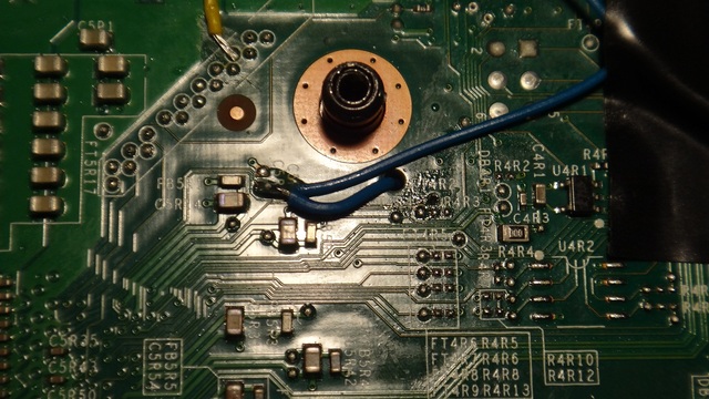

    The cpu rst point needs to be repaired for it to boot properly.
    It's been a while since I have done these fix's. I think you should put the chip back in, write xell reloaded again, do the cpu rst fix in the first link and use the post fix adapter or alt post out i linked in 2nd thread. You may have to keep it rgh'd now for it to work.
    Stock may boot. Try doing the cpu rst fix first with stock nand. See if the console boots with chip removed. If not install the chip and try booting xell reloaded after the fix's

    Sorry for asking this, but just to make sure.
    The postbit can be fixed by a postfix adapter?
    But won't need a repair, until I install glitch chip again?
    And the rst should go from C5R11 to where exactly?
    FT3T10?
    Thanks!

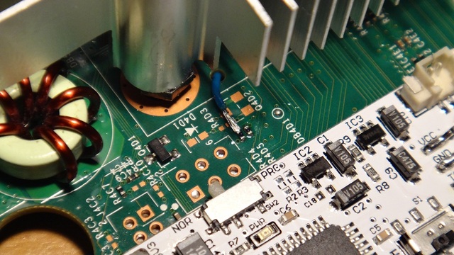

    Yes, use a post fix adapter and solder pad on adapter to the point in pic below
    Yes fix cpu rst only and see if stock to boots
    Take a look at the last 2 pics to repair cpu rst
    If you want to try booting stock first just fix the cpu rst. After you get stock working you will need to do one of the post out fix's I mentioned. If it still doesnt boot stock then try rghing it.

    This point to the ace v3 post out

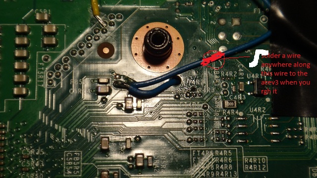

    As long as you do these repairs and leave it rgh'd you'll be fine.
    Do this fix and solder a wire from cr511(or anywhere on the wire going to cr511) to cpu rst point on ace v3.

    I have ordered a fiber scratch pen, and I will resume the work once it arrives.
  8. Madsmaten
    Madsmaten Gutsy Member
    Sep 6, 2012
    497
    149
    Scratch pen came in the mail today, I was able to fix the cpu-rst, and get it to boot stock nand!
