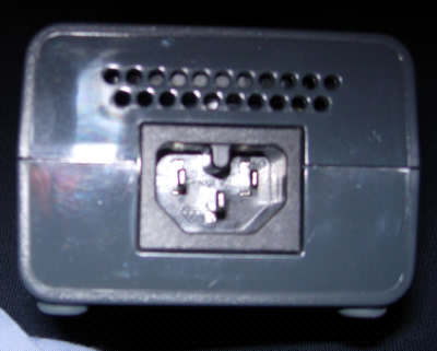

    Could anyone verify the connector from PSU to wall socket looks like this in the USA?

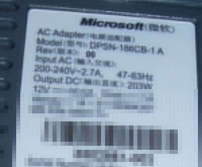

    Your PSU clearly states 200-240V. The US is 120V. You will need a WHOLE NEW PSU.
    The main issue, past that, is whether the NTSC 60Hz television will accept a PAL 50 / 60 Hz signal.

    Retro - thanks for saying, but I'm trying to buy a US power supply (the pic is of my UK power supply which is useless in the US).
    The bit I'm unsure about is the three prong bit - has the US one got a three prong bit?
    Also is the input to the US xbox 360 the same as UK?
    12V 16.5A 5Vsb 1A
    Thanks

    Why would the three prong bit matter? That is where the mains lead goes, and you cannot use a UK mains lead!
    You need to replace the WHOLE unit... i.e. the PSU plus the mains lead. UK leads are different from US leads.
    The end you should be looking at is that which goes into the 360! It is the same, don't worry!

    Hopefully you can see what I mean. You must replace the PSU because it runs at 240V. You must replace the mains lead also because it is a UK mains lead.
