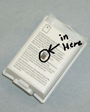

  8. Haloman02
    Haloman02 Member
    Jul 21, 2012
    I had the same problem turning the rumble worked for a bit... it's the battery holder doesn't make contact anymore so I put a small piece of aluminum in the little square on the back of the battery pack and it works..
