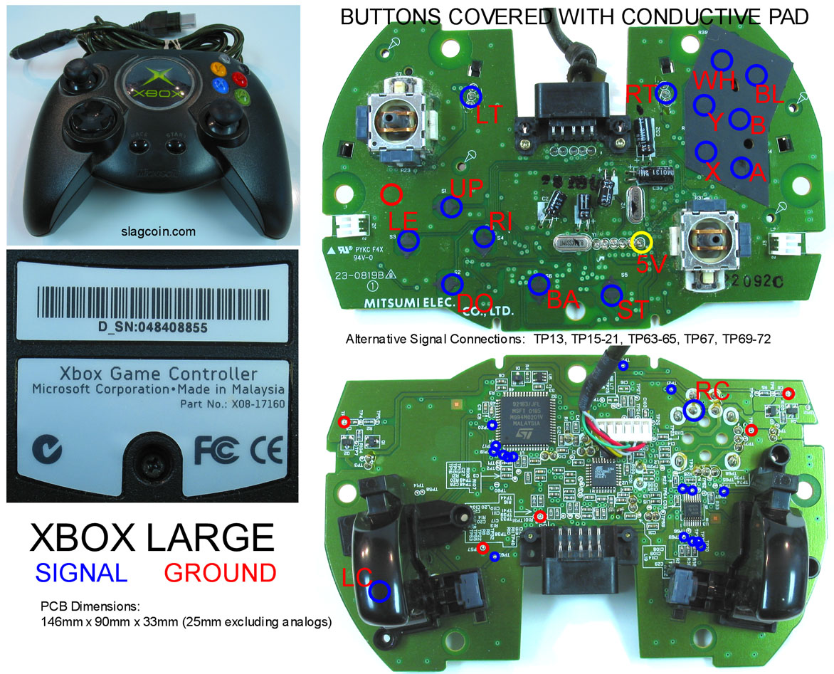

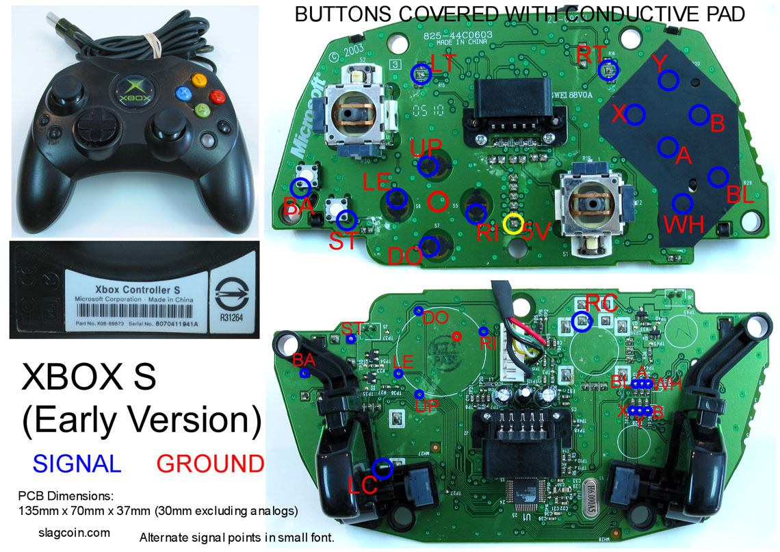

    Early Xbox Duke and S controllers were made in Malaysia by 'Mitsumi' and have translucent green wires:-

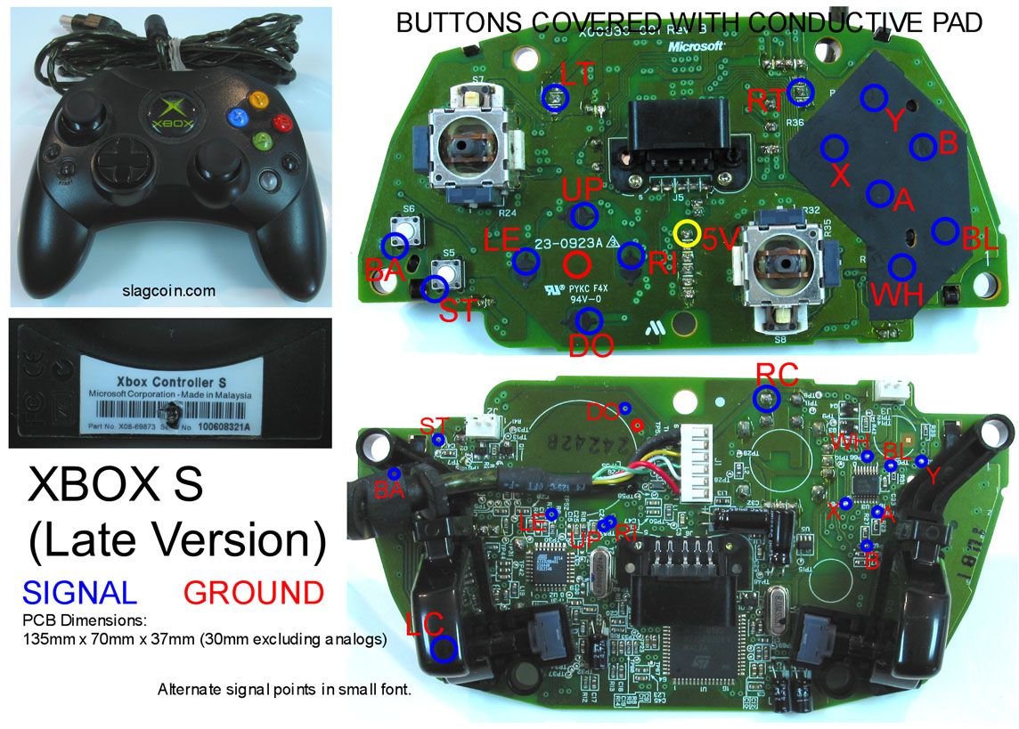

    Microsoft changed controller manufacturer part way through the Xbox's lifespan, and later Xbox Controller S were made in China by 'Foxlink' and have solid black wires (Foxlink now also manufacture the Xbox 360 controllers in China)

    The slagcoin Controller PCB Diagrams clearly show some of the PCB/manufacturing differences, although note that there is an error as they have mixed up the labelling for the 'Early Version' and 'Late Version' Controller S.
    Early Xbox Duke Controller made by Mitsumi in Malaysia:-
    http://www.slagcoin.com/joystick/pcb_diagrams/xbox_diagram2.jpg
    Early Xbox Controller S made by Mitsumi in Malaysia:-
    http://www.slagcoin.com/joystick/pcb_diagrams/xbox_diagram3.jpg
    (Note the twisted/rippled translucent green wire)
    Late Xbox Controller S made by Foxlink in China:-
    http://www.slagcoin.com/joystick/pcb_diagrams/xbox_diagram4.jpg
