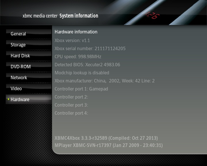

    First off all: Sorry for gravedigging!
    But after about 5 years i totally forgot about my plans to upgrade the CPU to a 1ghz one.
    I performed a few Ram upgrades lately and got asked if i could upgrade the CPU.
    As my memories about the Upgrade came back to me i quickly thought about trying it again.
    I started studdying the datasheets provided by intel and anything i could find on the Web.
    The most help needed is provided by the intel Datasheets and the pictures Dano2k0 posted few posts above mine.
    And here's the result:
    Think i can count this as a full success!

    Well before i tell everyone how i exactly did it i would like to give it a stress test and check if everything is okay with my technique.
    But as a short instruction:
    -Take a suitable 1ghz CPU (From my research: SL53s and SL5TF should both work, mine is a SL53s)
    -Remove the old CPU
    -Set the CPU mode pins corresponding to the Datasheet (Had to be done under the cpu on my v1.1)
    -Install the new CPU
