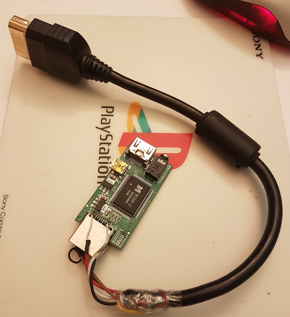

    I managed to one of those eBay PS2HDMI adapters working well on my OG xbox, only works at 480p/i though so far. Was just a matter of hooking it up. Picture is alright with no noticable lag.

    Did you solder it internally? Got any pics or more details on what you did?

    Its now soldered in internally, but I dont have a picture of it as its boxed away in storage.
    This is my other cable.. messy but works. I chopped up an old component video box that I got from Toys R Us years ago and basically just matched up the signals from the PS2 video port to that of the xbox. The video pins were shorted to it thinks its component output.
    The only thing I notice with the cable is that occasionally when you have loud sounds on the xbox (guns, engines revving etc) the sound occasionally cuts out. This doesnt happen on the one I have fitted internally.
