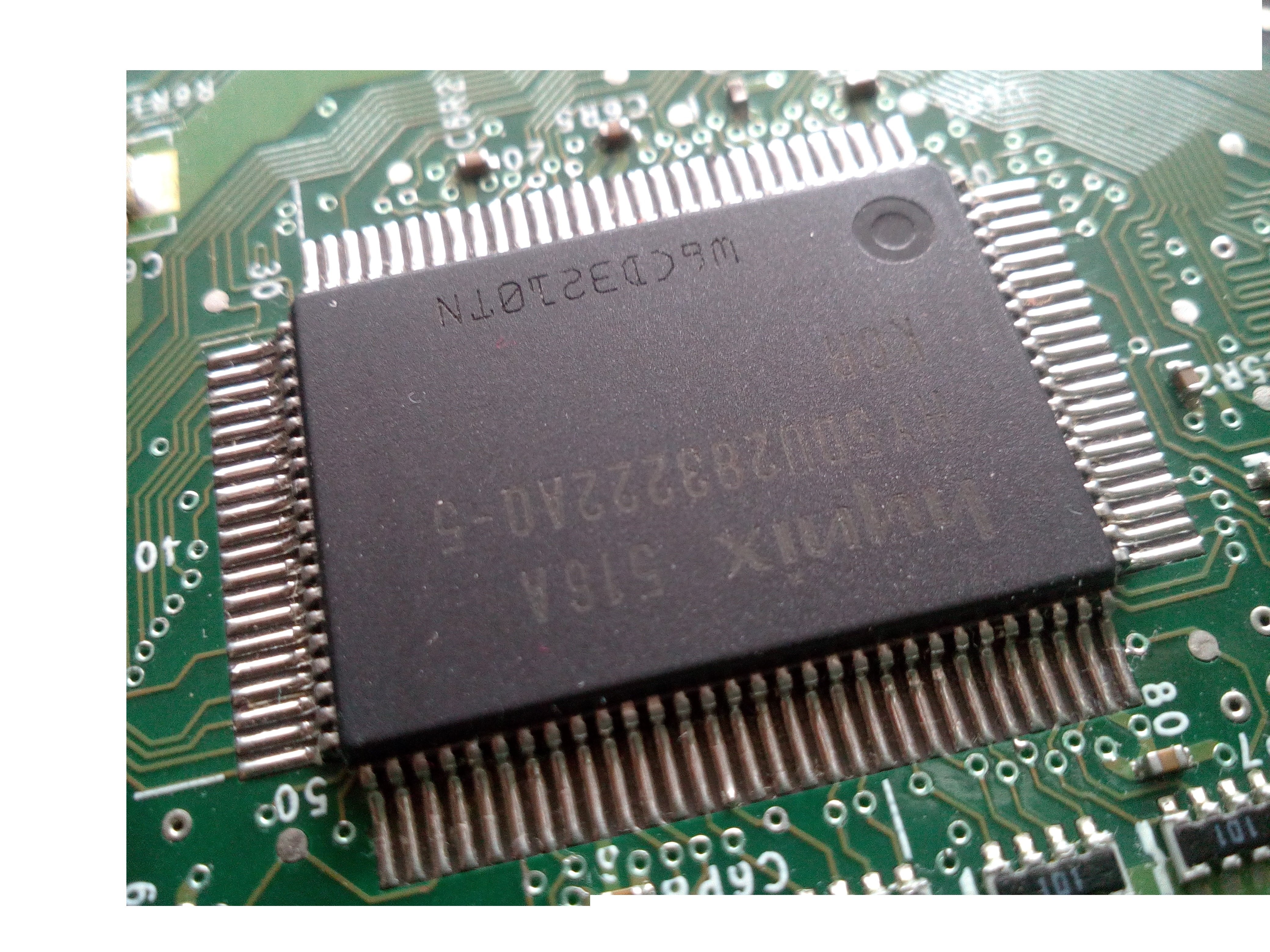

    The picture of that hynix ram chip suprises me a little. I have always been under the impression that those hynix were only used in 1.6b motherboards and had different timings compared to samsung ram chips. They say you shouldn't mix the 2. So, either your mobo is using all hynix chips (strange for a 1.1 board) or the assumptions are wrong. Maybe N64 can explain it?

    There are no fixed timings for Samsung chips.
    Michael Steil from Xbox Linux Project:
    "RAM Initialization | Decrypting flash memory contents into RAM is a challenge if we are living inside the first few hundred bytes of code after the machine has started up: At this point, RAM might not be stable yet. The reason for this is that Microsoft bought cheap RAM chips; they just took everything Samsung could give them to lower the price, even faulty ones, i.e. chips that will be unstable when clocked at the highest frequencies specified. The Xbox is supposed to find out the highest clock speed the RAM chips can go and run them at this frequency - this is the reason why some games don't
    run as smoothly on some Xboxes as on others. So the startup code in the secret ROM has to do a memory test, and if it fails, clock down the RAM, do another memory test, and if it fails again, clock down again, and so on, until the test succeeds or the RAM cannot be clocked down any further."
    Read the full story: 17 Mistakes Microsoft Made in the Xbox Security System PDF: https://mega.nz/#!X8pTkQiJ!CbMsZh04OCoG5ELlcOZ4VtHekATK6fza2Xh8rOAGc6c
    One time a Xbox arrived, the led was just green, but no picture nor sound. I cleaned the av port, still nothing. At the end the av port had some cold solder joints, reballing solved it.

    Don't know why it did that. Also got a console that does the same sometimes. If you turn it on it sometimes just frags.
    Still need to figure out why it does that. Maybe it's the caps drying out or just some strange things.
    Yes, it's possible to do a 128mb ram upgrade with hynix ram. This seems like one off the few boards i did that had 128mb hynix ram.
    They work exactly as good as the samsung ram and don't have any drawback.
