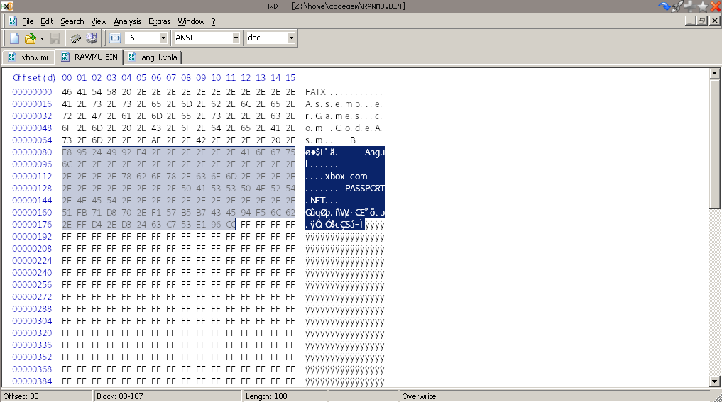

    2. Open HxD or any Hexeditor that can open usb storage devices and can edit them (unless only getting the data is required) (TIP2, open as administrator)
    3. Please use HxD, press the disk icon(next to the chip) named "open disk" you can leave the readonly on, if you only want to get the account, writing one, requires the dangerous "editing" mode...be save, stay of any harddrives.. smartass.
    4. If you have done everything good so far, you should see your live account or atleast the MU name you gave it, or MS did by formating. IF THE FIRST WORD is NOT FATX, GET OF THAT DEVICE. its not formated or its your windows drive
      [GALLERY=media, 314]Xbox Memory by CodeAsm posted Aug 26, 2015 at 11:22 AM[/GALLERY]
    5. select the bytes 50(hex) to and with BB(hex) (a total of 6C(hex), or 108bytes)
      (decimal 80-187)
      Tis, is your live account. Or you OVERWRITE a live account of 108bytes into here.
      Here you can view the selected account, regardless of the contents, it should contain your account. OR you "overwrite" the bytes there with the ones you want to have.
    6. Save, hope it works :D if you saved to a just made backup if you followed this with xplorer. go to step 7, else,... save and done :D

    The beginning of codeasm's MU dump:
    Code:
    46 41 54 58 20 1D 8D 09 04 00 00 00 01 00 00 00 | FATX ...........
    41 00 73 00 73 00 65 00 6D 00 62 00 6C 00 65 00 | A.s.s.e.m.b.l.e.
    72 00 47 00 61 00 6D 00 65 00 73 00 2E 00 63 00 | r.G.a.m.e.s...c.
    6F 00 6D 00 20 00 43 00 6F 00 64 00 65 00 41 00 | o.m. .C.o.d.e.A.
    73 00 6D 00 00 00 AF 00 19 42 07 00 00 00 20 00 | s.m......B.... .
    F8 95 24 49 92 E4 09 00 00 00 00 00 41 6E 67 75   X  (0x50-0xBB)
    6C 00 00 00 00 00 00 00 00 00 00 00 00 00 00 00
    00 00 00 00 78 62 6F 78 2E 63 6F 6D 00 00 00 00       B
    00 00 00 00 00 00 00 00 50 41 53 53 50 4F 52 54
    2E 4E 45 54 00 00 00 00 00 00 00 00 00 00 00 00           L
    51 FB 71 D8 70 08 F1 57 B5 B7 43 45 94 F5 6C 62
    08 FF D4 02 D3 24 63 C7 53 E1 96 CC FF FF FF FF               A
    FF FF FF FF FF FF FF FF FF FF FF FF FF FF FF FF

    ULONG SerialNumber;
    // volume serial number; not sure when this may get changed as version
    // 4267 dashboard had one value and 5960 dash another for codeasm
    // my flash drive has a volume SerialNumber of 0x00000000.
    ULONG SectorsPerCluster;
    // 0x00000004 = sectors per cluster (4 * 512-byte sectors = 2048 bytes)
    ULONG RootDirFirstCluster;
    // 0x00000001 = root directory first cluster ?? (duh!)
    WCHAR VolumeName[FAT_VOLUME_NAME_LENGTH];
    // FAT_VOLUME_NAME_LENGTH = 32
    /* 2 bytes per character so "AssemblerGames.com CodeAsm" is saved as:
     *    41 00 73 00 73 00 65 00 6d 00 62 00 6c 00 65 00 | A.s.s.e.m.b.l.e.
     *    72 00 47 00 61 00 6d 00 65 00 73 00 2e 00 63 00 | r.G.a.m.e.s...c.
     *    6F 00 6D 00 20 00 43 00 6F 00 64 00 65 00 41 00 | o.m. .C.o.d.e.A.
     *    73 00 6D 00 00 00 AF 00 19 42 07 00 00 00 20 00 | s.m......B.... .
     *    (Total of 64 bytes used to store the MU VolumeName)
     *    End of string 0x0000 (5th and 6th bytes on last line) remainder
     *    of any previous content left unchanged. (AF 00 19 42 07...??)
    UCHAR OnlineData[FAT_ONLINE_DATA_LENGTH];
    // FAT_ONLINE_DATA_LENGTH = 2048 ?? 1 cluster
    // Unused space in the block is filled with 0xFF bytes.
    I've had no problem copying an Xbox Live account (XBLA) from an older dashboard to the lastest 5960 by using a MU to transfer the account data. I've not tried to inject data directly from one Xbox HDD into another. The console had an XBLA already so they had a machine account. Transferred a couple other XBLA's via MU copy so it now has 4 accounts. There can be a maximum of 8 on a console and only 1 on a MU.
    First portion of 64MB memory unit without an Xbox Live Account:
    Code:
    46 41 54 58 00 00 00 00 08 00 00 00 01 00 00 00 |FATX............
    00 00 FF FF FF FF FF FF FF FF FF FF FF FF FF FF |................
    FF FF FF FF FF FF FF FF FF FF FF FF FF FF FF FF |................
    FF FF FF FF FF FF FF FF FF FF FF FF FF FF FF FF |................ <-XBL account info start but 0xFF's as none
    SerialNumber = 0x00000000, 8 sectors per cluster and cluster 0x00000001 holds the root directory on my USB Flash drive. The empty volume name terminated with 0x0000 (WCHAR NULL) on the start of second line of hex values.
    Directory listing started at offset 0x2000. (Not cluster 1 = 2048th byte or even 4,096th byte but at 8,192th byte:

    Seems the info I've found conflicts with that shown from archived data from xbox-linux.org.
    Offset / Size / Description
    0 / 4 / "FATX" string (ASCII)
    4 / 4 / Volume ID (int)
    8 / 4 / Cluster size in (512 byte) sectors
    12 / 2 / Number of FAT copies
    14 / 4 / Unknown (always 0?) -> 14 / 2 / Unknown (padding for ULONG alignment)
    18 / 4078 / Unused -> (16 / 4080 / Volume Label and XBOnline Account + unkwn)
    Offset 12 2 bytes with number of FAT copies and not the firstCluster of the root directory.
    ULONG RootDirFirstCluster; // offset 12 - 4 bytes
    // 0x00000001 = root directory first cluster ?? (as this didn't seem to work out!)
    vs xbox-linux.org's varibles (but the Unknown only has 2 bytes left before we see the Volume Label at offset 20.
    USHORT NumFATCopies; // offset 12 - 2 bytes
    // 0x0001 = number of FAT copies (this makes more sense)
    ULONG Unknown_xxx; // offset 14 - 4 bytes
    // 0x00000000 always
    should be
    USHORT Unknown_xxx; // offset 14 - 2 bytes
    // 0x0000 always
    and a bit more about the 4078 or 4080 unknown bytes containing the Volume Label of 32 WCHAR elements (64 bytes) and XBOnline account (108 bytes) on a memory unit/hard drive but 2048 bytes allocated just the first 108 have actual data the rest is padding/filler of 0xFF.
    // and the rest of the
    // Unused space in the block or is it cluster is filled with 0xFF bytes.
    And, another statement from xbox-linux.org's differences between FAT and FATX article (https://web.archive.org/web/2010061.../Differences_between_Xbox_FATX_and_MS-DOS_FAT):
    but not so on MU, mine is set to 8 sectors/cluster and codeasm's was 4 sectors/cluster.
    The (single) File Allocation Table always starts at position 4 KB of the filesystem. FAT size in bytes = ((partition size in bytes / cluster size) * cluster map entry size) rounded
    up to the nearest 4096 byte boundary.
    So, 4KB for the boot block/superblock (in Linux jargon) and 4KB (on MU) for the 1 copy of the FAT. Makes the start of the ROOT dirent at the 8,192nd byte, exactly where I found it.

    Evoxdash's backup command dumps the disk config area (first 1024 sectors [512KB] of the HDD) to a file called disk.bin saved along with the EEPROM backup - eeprom.bin, BIOS backup - bios.bin, hddinfo.txt and hddkey.bin files.
    From evoxdash's backup of the Xbox's HDD config area in disk.bin, the first Xbox Live Account (XBLA) data set is found at disk byte offset 0x1800 [sector #12 sector count starting with 0 being the first sector on the HDD at offset 0x0000 (or should this be sector 1 at offset 0x0000 making the first XBLA stored at sector #13)]:
    Code:
    0x1800: 68 25 13 79 01 00 00 00 01 00 00 00 F8 95 24 49 | h%.y..........$I
    0x1810: 92 E4 09 00 00 00 00 00 41 6E 67 75 6C 00 00 00 | ........Angul...
    0x1820: 00 00 00 00 00 00 00 00 00 00 00 00 00 00 00 00 | ................
    0x1830: 78 62 6F 78 2E 63 6F 6D 00 00 00 00 00 00 00 00 | xbox.com........
    0x1840: 00 00 00 00 50 41 53 53 50 4F 52 54 2E 4E 45 54 | ....PASSPORT.NET
    0x1850: 00 00 00 00 00 00 00 00 00 00 00 00 53 E4 40 59 | ............S@.Y
    0x1860: 72 AF CE 28 AE 75 AE 3B 7C 9B 8D 4A 08 FF D4 02 | r..(.u.;|..J....
    0x1870: D8 DD FE 97 C2 57 99 15 00 00 00 00 00 00 00 00 | .....w..........
    0x1880: 00 00 00 00 00 00 00 00 00 00 00 00 00 00 00 00 | ................
    repeats 22 more lines of 16 bytes of 0x00
    0x19F0: 00 00 00 00 00 00 00 00 54 73 7F 83 00 00 55 AA | ........Ts....U.

    First XBLA data set on HDD stored in sector #12 starting at offset 0x1800:
    Not sure what the first 12 bytes are but the following portion of the Angul XBLA I'd injected is the same on MU or HDD just at different starting offsets.
    XBLA data starting offset relative to the beginning of the XBLA HDD sector is 0x0C or MU is 0x50. This offset contains the first byte and continues for 0xBB more bytes (a total of 0xBC - 108 decimal bytes).
    The first 80 bytes (0x50) of the XBLA data set are the same on HDD and MU:
    Code:
    0x0000: F8 95 24 49 92 E4 09 00 00 00 00 00 41 6E 67 75
    0x0010: 6C 00 00 00 00 00 00 00 00 00 00 00 00 00 00 00
    0x0020: 00 00 00 00 78 62 6F 78 2E 63 6F 6D 00 00 00 00
    0x0030: 00 00 00 00 00 00 00 00 50 41 53 53 50 4F 52 54
    0x0040: 2E 4E 45 54 00 00 00 00 00 00 00 00 00 00 00 00
    The values differ on MU and HDD in the remaining 28 bytes.
    MU content: (remember 0x0050 here is relative (added) to 0x50 the starting address of XBLA content on a MU)
    Code:
    0x0050: 51 FB 71 D8 70 08 F1 57 B5 B7 43 45 94 F5 6C 62
    0x0060: 08 FF D4 02 D3 24 63 C7 53 E1 96 CC
    My HDD content: (again remember, 0x0050 is relative (added) to the sector starting offset from the beginning of an XBLA # sector on the disk + 0x000C the starting address of XBLA content stored on the HDD.)
    Code:
    0x0050: 53 E4 40 59 72 AF CE 28 AE 75 AE 3B 7C 9B 8D 4A
    0x0060: 08 FF D4 02 D8 DD FE 97 C2 57 99 15
    There are 4 bytes, 0x60-0x63 that remain unchanged between MU and HDD. These represent DWORD dwSignatureTime.
    The Signature TIme was: ??? (Need to decode this time's value)
    The MU content from 0x50 - 0xBC is the XBLA data set (e.g., angul.xbla).
    An Xbox Live account is copied from the HDD to a MU (thumbdrive or Xbox MU).
    This operation is performed by xboxdash in the Memory menu for the Xbox Hard Disk scroll down the game saves list the last entry titled "Xbox Live Accounts". Move to the right (D-pad) to select the account to be copied to the MU, press A, press A again to copy to the installed MU. Next, on the PC open Xplorer360 and select Drive -> Open -> Hard Drive or Memcard... then select Drive -> Backup Image..., enter the filename to save the backup to a default is given but can be changed to help remember what this .bin file contains. Open the backup file you just saved in a Hex Editor of your choosing. Copy the data from 0x50 to 0xBB. Open a new empty file in the hex editor, paste the copied data and save it as <account_name>.xbla (or .bin) as XBLA extension is made up. You can associate the hex editor as the application to always open .XBLA extension filenames if you like.
    I've not tried to take the data directly from the HDD and inject it into a memory card backup. Remember there are 28 bytes that differ in value on the HDD as compared to the MU copied account. The values of the HDD copy might be invalid to use directly on a MU. The Xbox might not see the MU's Xbox Live Account when plugged into the Xbox and viewed in the Memory -> MU menu.
    More experiments to do!
