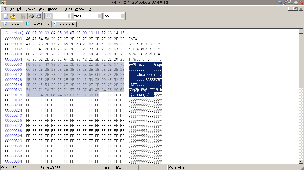

    Does anyone know where the xbox live profiles are stored on the xbox hdd? I have a few id like to backup. I tried installing the action replay software but it won't work on windows 10. Program runs but won't detect memory unit so I just want to FTP them over. I need help locating the directory they are in.

    No, you cant find it in the filesystem tree. its "outside" the filesystem.
    I stated it somewhere before, .xbla is MY MADE-UP extension. it does NOT exsist. its raw data inside the system header, configsectors on the harddrive. You cant find you creditcard or harddrive key on the harddrive either right? "NO, only after some homebrew app or reading the eeprom yourself. "

    3. Please use HxD, pres the disk icon(next to the chip) named "open disk" you can leave the readonly on, if you only want to get the account
    4. If you have done everything good so far, you should see your live account name allready (unless you want to copy a account here) The name of the MU should be "earlier" on the MU aswell.
      [GALLERY=media, 314]Xbox Memory by CodeAsm posted Aug 26, 2015 at 11:22 AM[/GALLERY]
      in my case, a longe one "AssemblerGames.com CodeAsm" not sure if we can savely edit it here, try not to.
      The live account is "Angul" in my case, reasons for why you cant change the name, we dont yet have the generaly used "encryption" key. Every xbox has the same one, thats why you can transfer them using a MU. The Harddrive uses a xbox specific one, so we cant just copy that data.
    5. select the bytes 50(hex) to and with BB(hex) (a total of 6C(hex), or 108bytes)
      (decimal 80-187)
      Tis, is your live account. Or you OVERWRITE a live account of 108bytes into here.
      Here you can view the selected account, regardless of the contents, it should contain your account. OR you "overwrite" the bytes there with the ones you want to have.
