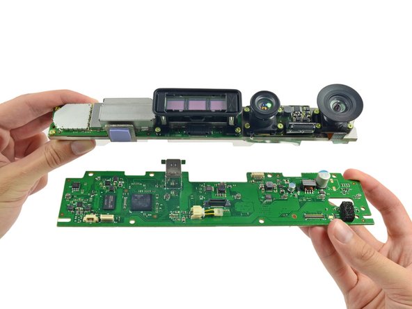

    It's the ployfuse..
    replace it don't bridge it!
    The thing with Yellow wires on the main PCB >

    @CandieC Does your XBOX One light dim when you plug the kinect in? If it doesn't then most likely the kinect is dead. Really though, contact Xbox Support.
  11. LeHaM
    LeHaM Site Soldier
    May 5, 2013
    2,634
    292
    I doubt it's dead..
    It's a 3amp Radial TCO (thermal cut out fuse), also known as a polyfuse.
    This one should do the trick, better to first check continuity on the existing fuse first. Also see how many volts are going into it before buying this fuse. The Kinect does use DC-DC converters and I'm not sure if they boost and to what voltage or where sorry..
    Anything 3A and over 16v should be fine but check voltages first (you may need 24v or even higher).
    16v 3a>
    http://www.ebay.com/itm/GA19211-RGE...hash=item20e2b1d8d2:m:m-q5CKN5ogiyhalHdCBVmIw
    30v 3a>
    http://www.ebay.com/itm/Multifuse-Radial-3A-30V-/121616103848?hash=item1c50e279a8:g:Ja0AAOSwvt1WRGT4

    Sorry took me so long to get back. Yes as it turns out it's the fuse, anyone know of a site that ships to the states that has an adequate replacement?

    generally a fuse wont blow for no reason, something properly still wrong somewhere in circuit etc
  16. Bad_Ad84
    1,309
    I disagree, fuses can blow for lots of reasons. Some of which require no repair other than replacing the fuse.
    Put a new one in, see what happens. If it blows again there is a problem. Otherwise it's likely fine.
