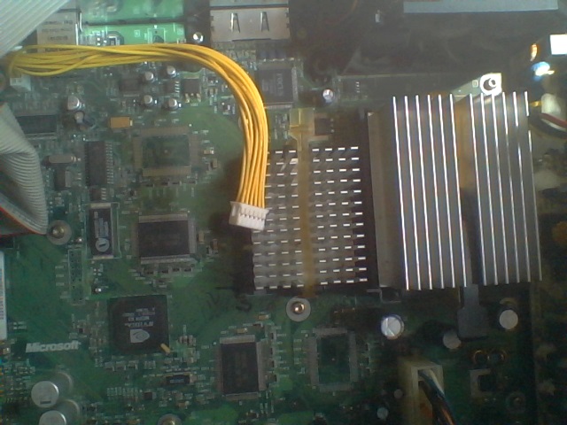

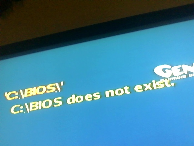

    so i do everything as normal go to hexen windbond flash m8 bios evox it goes through the procedure until gentoox its like it dosent recognize the bios.bin im pretty sure i soldered correctly

    maybe a bad copy of hexen, download from this link
  3. HEX1GON
    Use EVOX standalone, not by a multi-installer disc.

    i fixed it turns out it was shadow c partition getting in the way
