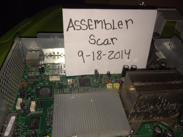

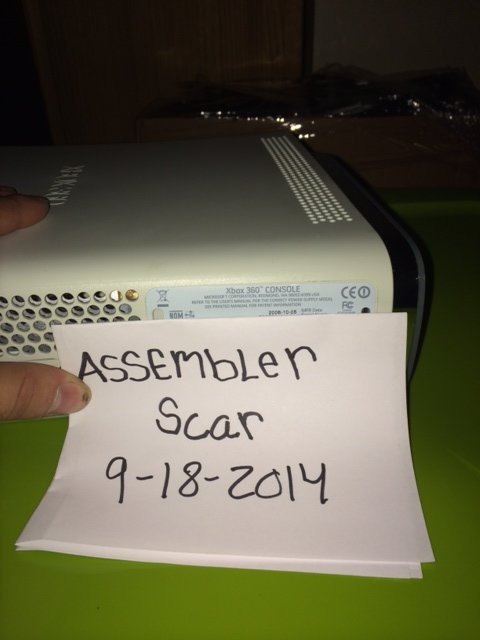

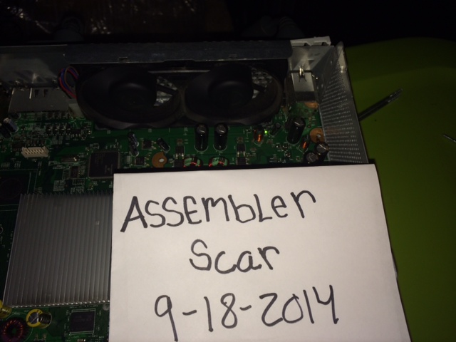

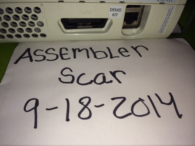

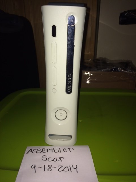

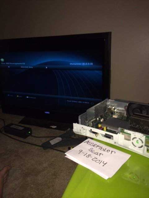

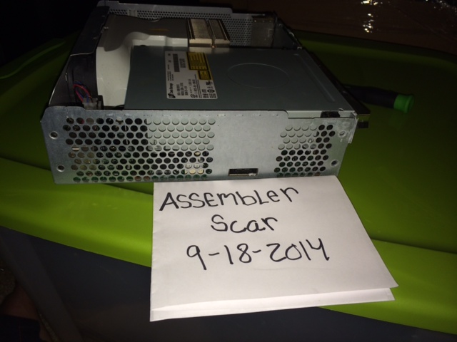

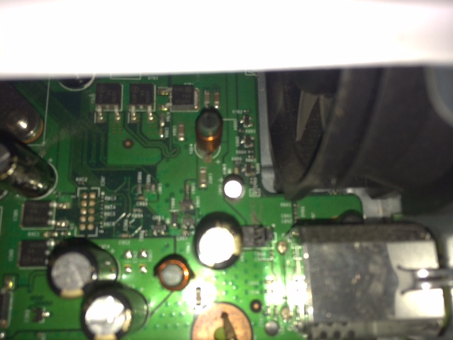

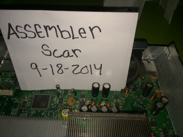

    so this is a xenon demo kit i bought on ebay like 3 months ago ,and supposedly the seller i bought from got it from a midway games auction. image.jpeg image[1].jpeg image[2].jpeg image[3].jpeg image[4].jpeg image[5].jpeg image[6].jpeg image[7].jpeg image[9].jpeg

  3. scar
    scar Active Member
    Jul 19, 2014
    27
    Thanks and do you think this demo kit can take a sidecar since it has all the headers???
  4. deep3r
    deep3r Fiery Member
    Feb 6, 2011
    855
    301
    If it has all the headers, don't see why not. :)

    oh without a doubt! the only thing demo's dont have is debugging, besides that its all the same as full XDK :)

  8. halo3
    halo3 Robust Member
    Jul 20, 2010
    251
    If you manually add on the ports for a sidecar can a demo/stress kit use the sidecar?
    btw scar maybe it just has a demo kit case, maybe it isn't a demo kit at all? I have never owned an demo kit, but won't it specify that in the launcher vs. xbox dev as shown in the pic?
  9. benny679
    benny679 Active Member
    Jul 14, 2013
    38
    I think the efuses are different, thus not allowing the use of a sidecar even if you manually added the ports.
  10. scar
    scar Active Member
    Jul 19, 2014
    27
    But how I do I determine if it's not a demo kit?
  11. halo3
    halo3 Robust Member
    Jul 20, 2010
    251
    Does it always say Xbox 360 Development Kit in the launcher?
  12. deep3r
    deep3r Fiery Member
    Feb 6, 2011
    855
    301
    Either that, or test kit. It doesn't state whether its a stress / demo etc.
  13. scar
    scar Active Member
    Jul 19, 2014
    27
    Yea it always says development kit
  14. halo3
    halo3 Robust Member
    Jul 20, 2010
    251
    What does it state if it is a stress or demo?
  15. deep3r
    deep3r Fiery Member
    Feb 6, 2011
    855
    301
    Phat stress kits were development kits, slim stress kits were test kits. Demo kits are development kits. Its test kits that are sent out to developers for like QA.
  16. scar
    scar Active Member
    Jul 19, 2014
    27
    So I checked the serial number in dash system info and it matches the one on to the case so there for the case was not switched out.
  17. halo3
    halo3 Robust Member
    Jul 20, 2010
    251
    lol unless some1 added the sticker? XD
  18. scar
    scar Active Member
    Jul 19, 2014
    27
    Well it's a mystery
  19. XboxSurgeon
    Nov 18, 2013
    2,109
    923
    The stress, reviewer and demo kits always have standard retail appearing back decals with an added small square decal on reviewer and demo kits. Stress kits do not have anything revealing on the outside beside the stress cables coming out the top. Development kits and Test kits both will say "XDK" on the label itself. Test kits traditionally are in white while dev kits are in a dark grey.
  20. halo3
    halo3 Robust Member
    Jul 20, 2010
    251
    Do reviewer kits have the same grey case?
