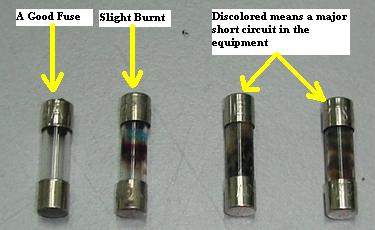

    You might have nailed this one. I cracked it open and found 2 inline fuse holders in between the mains switch and the transformer. I pulled both and found that one is dead. Tracing back, it appears to the the 110 line, so that explains why I didn't get anything.
    The tricky part is this appears to be a glass fuse with a resister embedded in it. The fuse holder designates a .2a fuse, but no indication of the resistance. Unfortunately, it measures open, so I can't get a reading on what it should be that way. Any ideas on where I might be able to find one of these? I suppose I could also solder a resister in parallel with a normal .2a fuse, but that seems a bit risky.

    There should be tiny etch on it for the rating. Can you show pics of the fuse?

    As requested, here's a pic. I've found 250v 0.2a on one end of it. If I'm reading the color bands on the resister correctly, it's a 91 ohm 1% tolerance. Not sure of the wattage.
  20. ASSEMbler
    If that was blown there's be nothing but black powder inside.
    I think the problem lies elsewhere.
