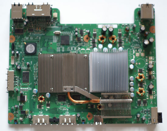

    Yes. You can take the heatsinks from a Falcon/Jasper and place them onto the XDK zephyr.

    Just be careful to pop the sidecar off the top of the kit before you pull the console shell apart. The 6 leg/tabs are fragile on the bottom of the sidecar.

    For the two pins closest to the front of the kit I would recommend using something like a shirt hanger that has been bent straight. So use the standard method for the middle and back pins after that gently hold up the sidecar so you can look from the back to the front and use the shirt hanger to get the front pins. Sounds a little complicated but after you do it a few times you'll understand.

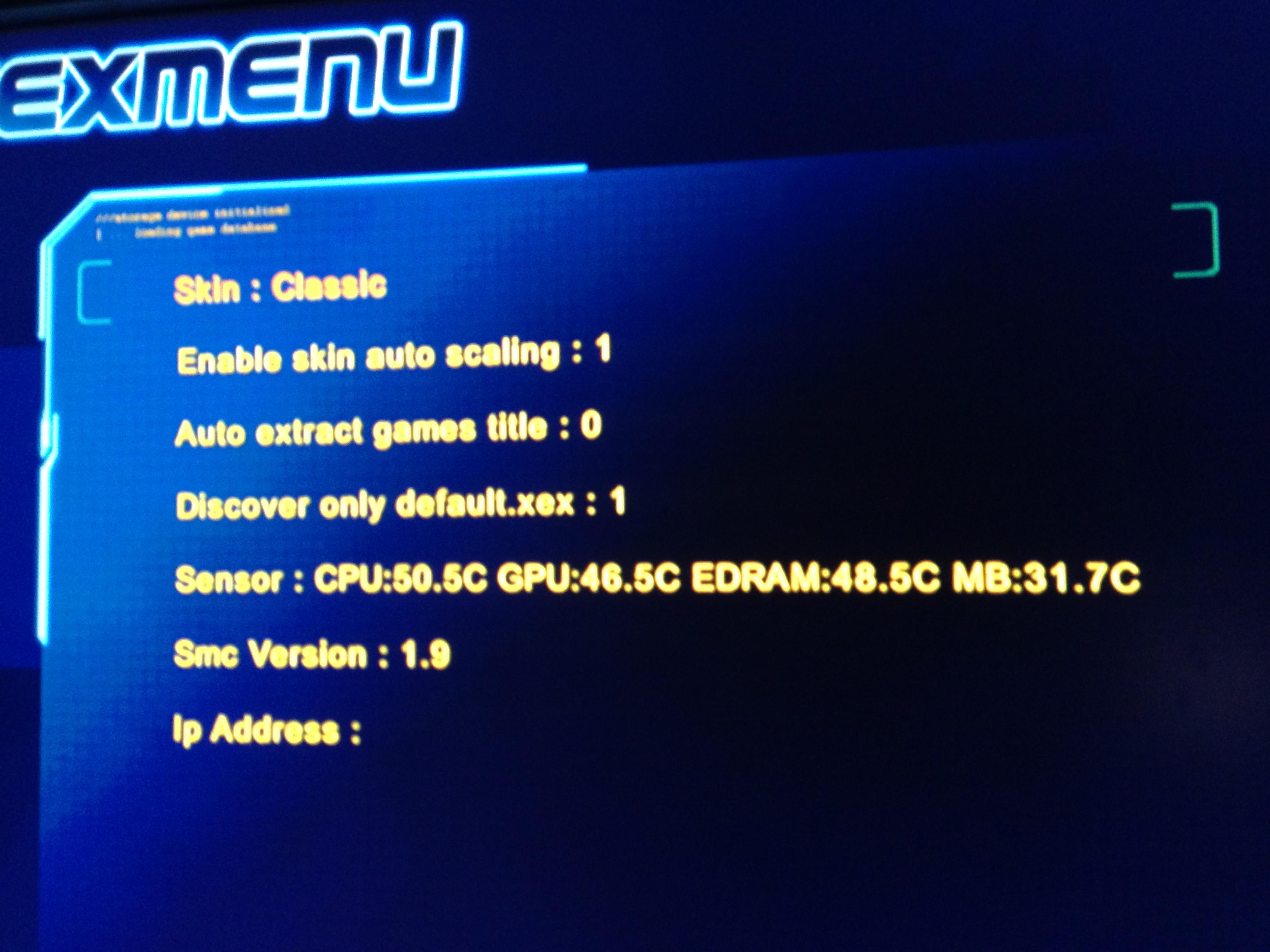

    Of course with later revisions, they shrink the CPU and GPU so they generate less heat. Of course they would improve the heatsinks so Falcons/Jaspers don't cook their guts, but I wouldn't expect to see too drastic of improvements (maybe 3 degrees?). I would also get a fan speed xex and crack up the speed to help. May sound like a freight train but it will help. Keeps my Xenon JTAG cool. Doesn't reach the 60s untill it's been gamed on for a few hours.

    I never realized how well this worked until today. I took one of my old Xenon JTAGs out of the garage with RROD 0102. I had installed this a while back, but after installation it still had RROD. Taking a closer look at it, I noticed the side of the plate opposite the RAM was grounding the console on a couple of points. I took it off, used wire cutters to trim down the points, then reinstalled. After reflowing with a 0022, the CPU runs at 60 degrees, 20 degrees cooler than my other Xenon JTAG. You can feel the heat radiate out the back of the chassis thanks to the heat pads on the bottom. I'd recommend it. Only problem is it's a bitch to install. You have to drill through the chassis, then sand, and then getting the washers in place is crazy difficult. You feel like MacGyver playing operation when setting it up. But overall I think it is the next best thing to reballing and fan speed modding.
